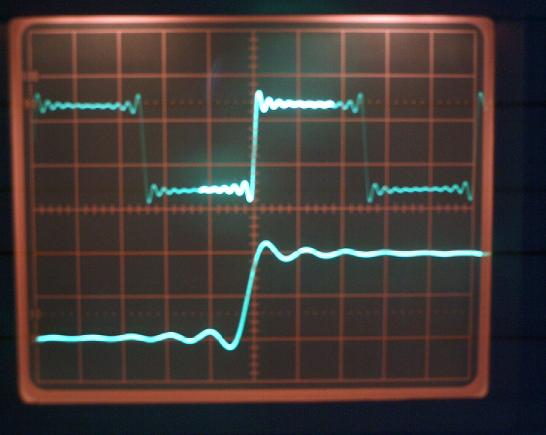

Just to add another extreme example.
If you take a CD player that uses opamps for the audio stages (and 99.9% do) and replace one channels opamps with 741's and then go and play a test disc of say a 1khz squarewave (which from CD looks anything but square) and overlay left and right channels on a good scope you will not see a single difference between channels.
So go for it 🙂
So go for it 🙂
So go for it 🙂
What's 741's?
I assume when you say, you wont see a difference on the scope, you will hear a difference?
They would say you're either measuring the wrong things or that you're expecting to hear a difference and that's why you do (expectation bias).

What's 741's?
741's are the industry standard opamp originally introduced in the late 1960's.
The 741 Op-Amp
Yes, fitting 741's in place of modern opamps is certainly audible. It's like going from one extreme (what is now regarded as probably one of the "worst" opamps), to say the latest modern audio oriented opamp. But in real terms that difference (even audibly) isn't as great as you might think if the device is used correctly.
