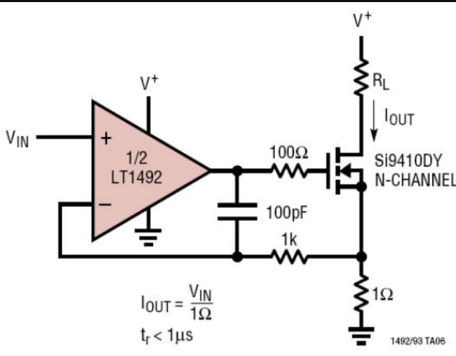

What I am trying to make is a load, you know that you can get a electronic load to load constant voltage, constant current and so on. I would like to try to build a load where I can change the load by change voltage input.

OK, I think I understand you. Not easy to do well with fine control.
A load is normally something that draws draws current like a resistor. So you could have for example a 100 ohm load, a 50 ohm load and a 10 ohm load where each value is switched by an external voltage. That is pretty easy to do.
You can have as many 'steps' or values of load as you want and all controlled by a voltage that changes between two set limits.
That sort of load is floating and works with AC or DC.
A constant current load that is switchable between values is possible using a similar technique but would normally be usable for just one polarity of voltage.

If you use a switched resistor for a load then it will work with DC or AC. So you could test a power supply of any polarity or even put it on the output of an amplifier and see how it reacts to a changing load.
If it is just a DC power supply you want to test then you can switch a load with transistor instead of a relay.
You could also replace the resistor with a switchable current sink to draw a fixed current load irrespective of the output voltage of the power supply.

Yes, you just alter the 1 ohm to get a different ratio of control voltage vs current.

It is not a voltage dependent resistor, that is something totally different and not something you could easily make an electronic equivalent of.
The circuit posted allows a constant current to flow in a load, and the value of the current depends on the input voltage to the opamp.
So by adding either gain or attenuation to the control voltage you could for example make a 0 to 10 amp current sink that is controlled by a 0 to 1 volt or a 0 to 100 volts or even a 0 to 10 millivolt control signal.

When you are talking about constant current then saying '10 to 20 volt' doesn't really mean much. The current is the constant, while the voltage depends on external factors such as the value of voltage applied to the load.

CC and CR modes are easy to implement. (CR is constant resistance mode).
The only hard is to implement CP mode - it needs some more parts.
