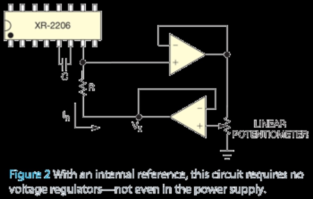

Here is one more reference I remember from way back.
It uses a exar2206 signal generator and the chip requires a resistor to ground to set the frequency.
This document shows a method to replace the resistor with two opamps to create a voltage control input to the set pin that typical would be a resistor to ground, cool technic, I have seen this published in many Hobbyist Electronics and Radio Electronics magazines throughout the 80's and 90.
https://www.edn.com/function-generator-has-variable-frequency/
Sorry about the terrible quality of my screen shot.
jer 🙂
