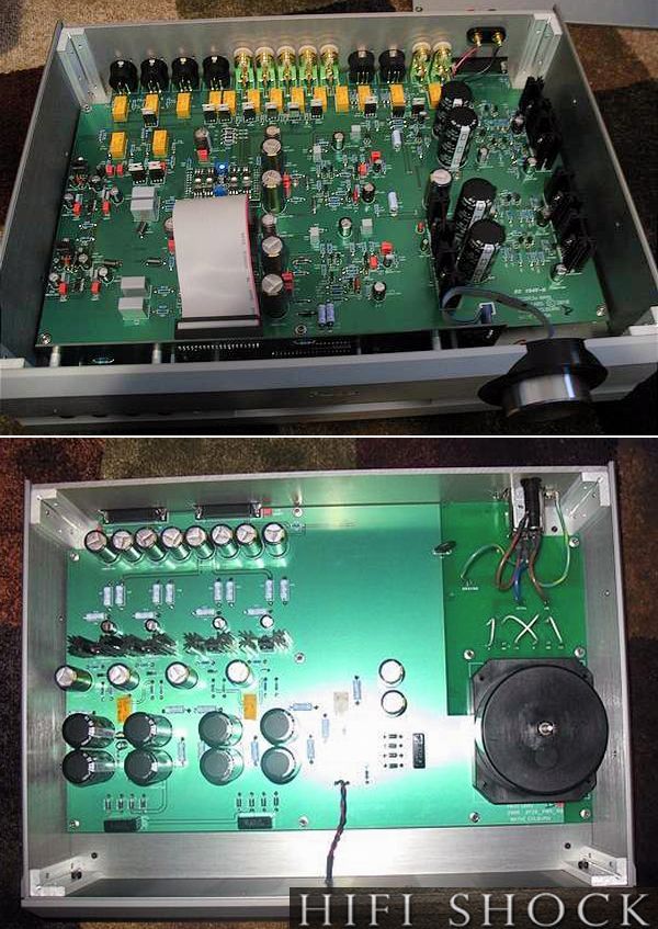

Changing voltage on the XP-20
I looked inside my XP-20 when I first got it.
There are some jumpers between the IEC AC input module and the transformer.
These jumpers would need to reconfigured but like Nelson said it looks like it pretty straightforward
I looked at some pictures but I didn't have a good angle (Straight down from the top)
I found one online but it is too small to see the labels on the circuit board.
I also found a generic wiring diagram of the transformer schematic which seems to agree with the jumpers.
Not hard to do but not something for someone who does not have good soldering skills and the proper tools.
I hope this helps.
If you do get an XP-20 you won't regret it.
