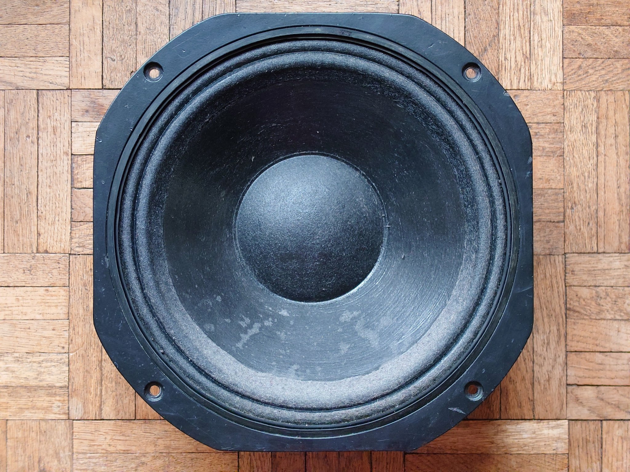

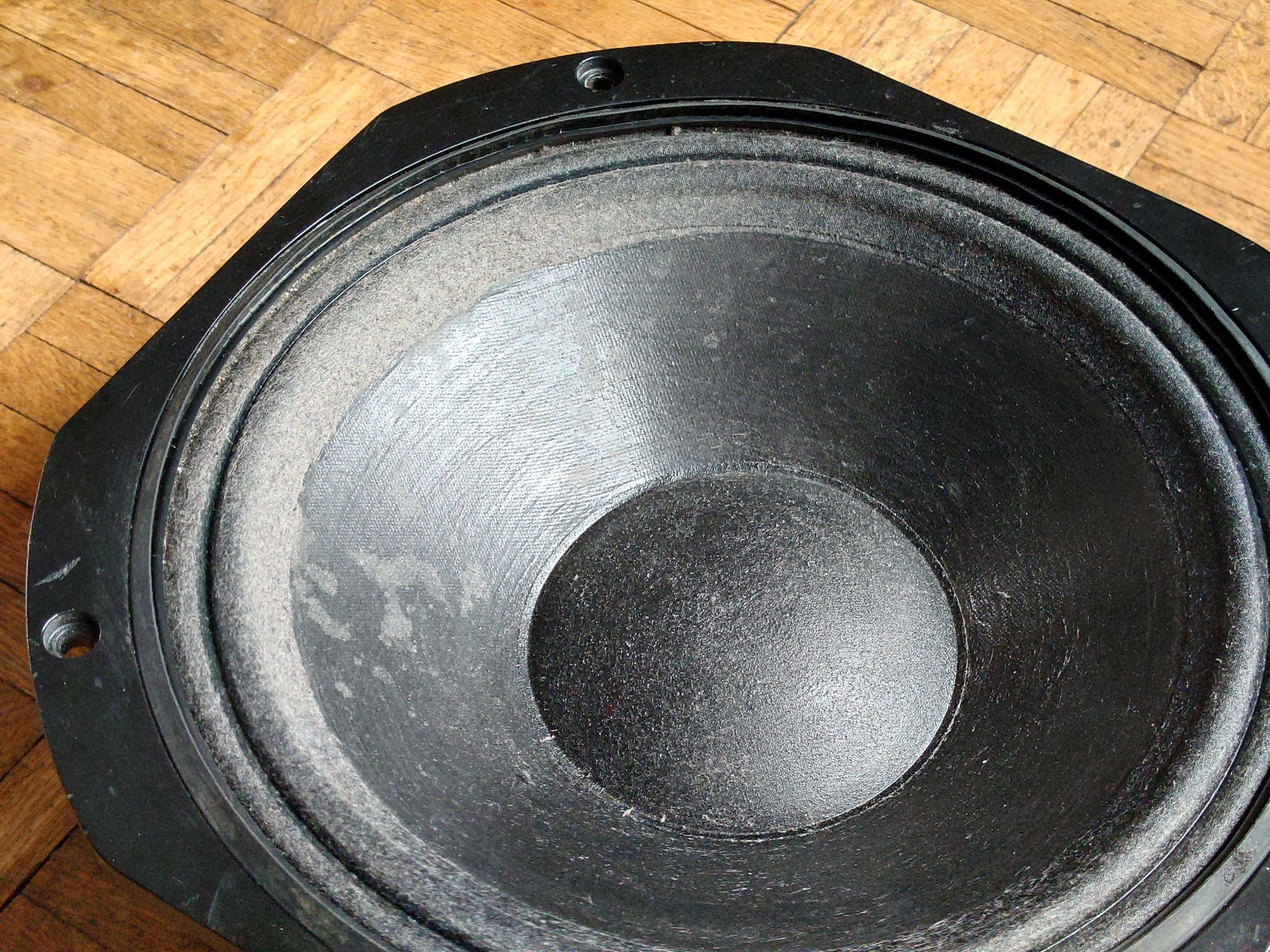

I have this quad of vintage Goodmans Audiom 81 'Bass' drivers I recently aquired, two well matched pairs. I like the look of going sealed again with these, either with a single pair in a 90L cab, or the compound pair in a 120L cab which gives much more scope for headroom and a bit of EQ.
I used the calculations here for combining the two pairs of drivers as although there are two quite well matched pairs, the two pairs vary quite a bit.

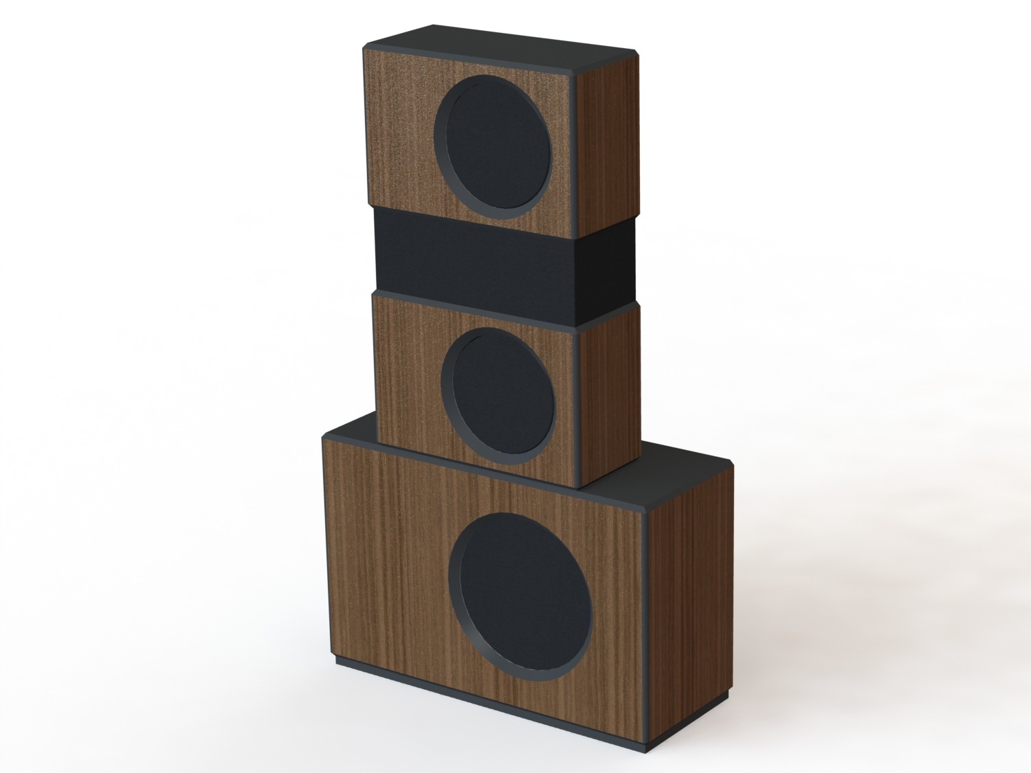

The overall plan is with the large cabinets below with the Audiom 81s, smaller midrange cabinet for the Volt and Seos. The mid/treble may well be replaced with other combinations such as the Supravox 165GMF/Fountek ribbon for example.
