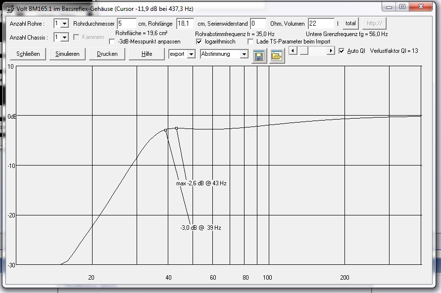

It is often overlooked because it doesn't follow anything consistently. It's not outstanding in any regard, it got a lot of comprimises. Here's the simulation in 22l and 35Hz tuning:

I'm sorry but that's not very convincing for the price. The problem is, they want to do everything and in the end they got a driver that's not very good at anything.

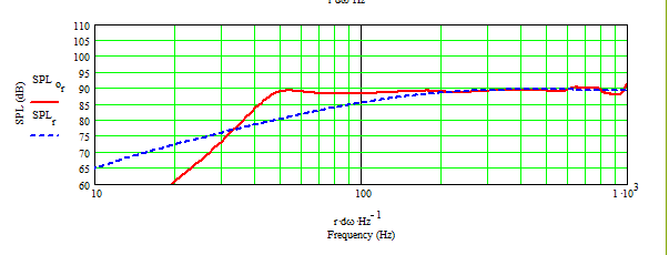

Attached is the simulated MLTL response using the BM165 from the MJK worksheet.
Cabinet size is 200x206x840mm (WxDxH), 18mm wall thickness
Port is 66mm dia, 127mm long, near the bottom
Damping is 0.5lb/cu ft, for the top 2/3rds of the cabinet
Indicates -3dB at ~45Hz, -6dB at ~40Hz.
I can see it got a bump of ~2dB at 55Hz. Did you calculate with a serial resistance of the xo coil? If not, that bump will increase further. That's not exactly what I expect from a 130€ driver.

I agree, a lot of things have to be heard to allow a judgement. But: The simulations in the bass are very accurate, you don't need to listen to it before you know what's going on. And intermodulation distortion is directly dependent on the excursion, that's physics, you don't need to listen to that either to know it.

The Qts of 0.24 is a bit on the low side, so there is a broad dip (~0.8dB) centred on 100Hz. Fortuitously, the 2nd order filter inductor combined with the capacitive driver impedance above resonance gives a similar broad peak at the same freq, resulting in a flat response overall.

Yes, the Qts does increase with a series resistor, but you then need to re-optimise the port tuning appropriately. The attached plot shows the result of using a 1 ohm series R, and adjusting the port. The response is now flatter, but with lower sensitivity.
