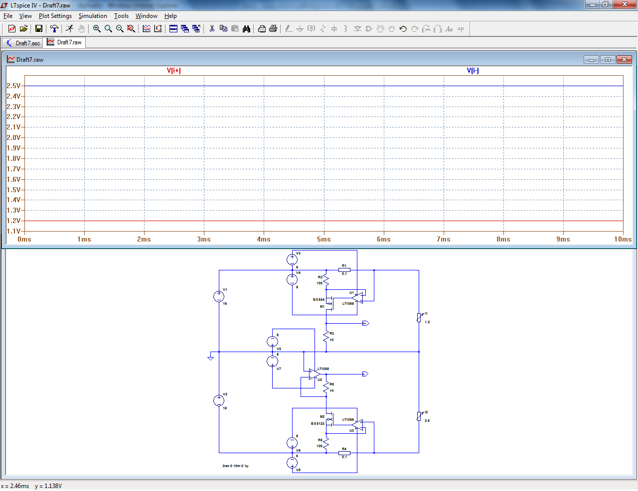

Since you have the possibility to use floating supplies, a powerful and accurate method of remote sensing/rapatriation is to use current sources, a bit like Palstanthurin showed, but more flexible: the voltage rating is that of the discrete transistor, not the opamp.
In addition, it requires no accurate matching, and ranges can easily be altered/switched with R3/R6.
Here it is shown with small MOSfets for maximum accuracy, but high Hfe Bjt's are also usable with a slightly degraded accuracy.
The opamps can be almost any type, like TLO81 or LM358, but precision opamps are preferable of course.

Thanks @Elvee, i see now that i was verry ignorant and i apologise for it, there are enough solutions for it, i've just not searched enough...
So moving the shunt it is clearely not a problem, the issue is the source code witch i cannot get it and without it it seams i cannot make sure the hex file is ok, i'll just have to hope that adjustable amplification will be indeed enough to calibrate it afterwards.

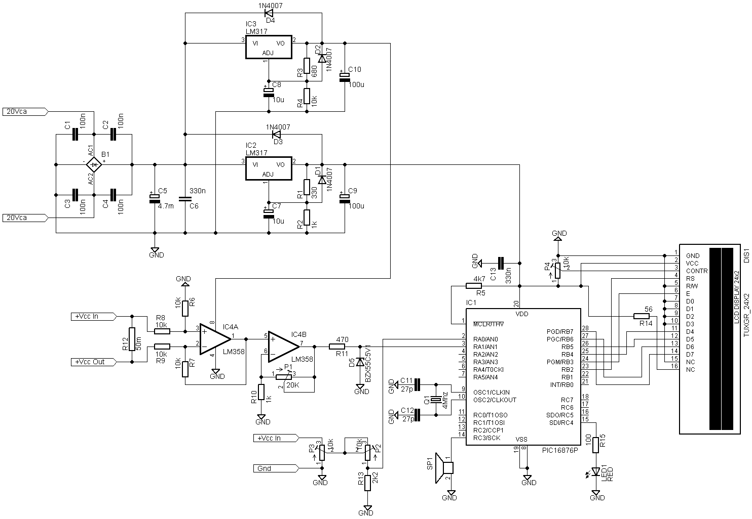

I'm back with an upgrade on the device, after further research and testing i have stopped at this schematic for it:
For the current part i will use the differencial amplifier with a LM358, i will provide a 20Vcc to cover the imputs limmits regarding CMIR, and an noninverter amplifier to get the needed voltage, after testing with what i had i have found that BZX55C5V1 is the best option regarding the protection of the PIC's imput, it has the smallest effect on the voltage below it's breakdown level. The device is set for 0 to 35Vcc and 0 to 6A, it will also indicate the power delivered to the load, my PSU will have a max of about 31Vcc and a limmited current of arround 5A. The speaker is a buzzer witch will go off when reading exactly 6A on the LCD, the same function for the LED, they both will give visual and auditory warning when that level is reached for any given reason, another way of ensurring the safety of the PIC microcontroller.

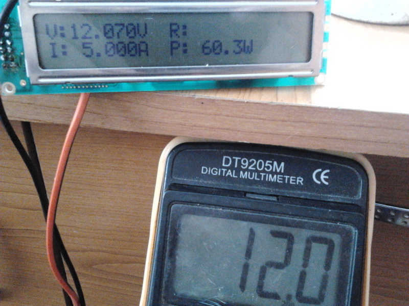

I had a friend wrote the code for me and debug it, i have wrote it into the PIC and after mounting stuff on a breadboard i have run a test, it seams it's going ok, the voltage indication is precise enough, no important deviation from the indication of a digital multimeter when adjunsting the PSU's level. haven't had the time to make up on the board the current side of the device, i will leave that for the PCB when it's done, i have assured and adjustable 0-5V to the current imput and the indication on the LCD display is going up and down quite good, havin exactly 6A for 5Vcc on the imput, i attach a pic showing it in action:

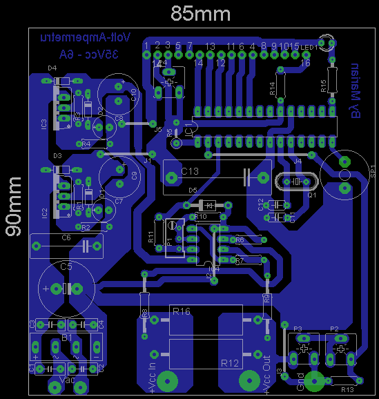

The buzzer goes off exactly at 6A, le indications are good enough so i think it is ok to call it a success, now comes the pcb witch i designed it few days ago and will be put into practice as soon as possible:
If that is sufficient to meet your objectives, why not but I think it is worth drawing your attention to some points.
-R6 to R9 will require a very accurate matching. For example, with 0.01% tolerance, a 20V variation of the output could "leak" as a 160mA parasitic current variation.
-The offset of the 358 will also cause errors: 5mV will result in a 100mA error; a precision (or offset-trimmable) opamp would be preferable.
-To protect effectively the input of the PIC without losing accuracy, you can use a lower voltage zener, 4.7 or 4.3V and connect P1 downstream of R11
I am well aware of the amplifier's shortcomings regarding resistor matching, that is why i bought loads of 10k resistors all from the same batch, i am pretty sure i will find 4 of them close enough; i am also aware of the offset influence but all i can do is try out more than one 358 and choose the one with the smallest offset as i am quite sure it cannot be the same to all of them... on the other hand i am not looking for precision current rating, differencial amplifier makes that quite hard to obtain, but i do not need that, i am not building an multimeter so i just need to have at least some ideea of the load current at any given time and i am quite sure i will be satisfyed even with that worst case scenario you have described, so i am done testing, i just need to make the time for the board it's self and then again some more testing and adjusting what needs to be adjusted, and that would be it...

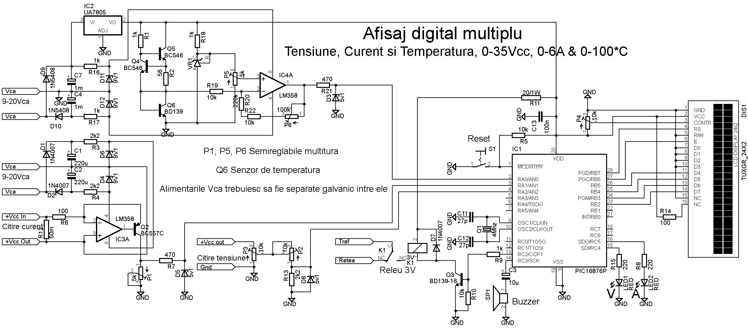

I have recently finished the VA-meter i was working on, it has been mounted on an adjustable Lab Power Supply built by me, the digital meter uses PIC16F876A and a 2x24 LCD, it measures Voltage on the load, Current taken by the load, power delivered to the load and the main heatsink temperature, this is how i wanted to be, this is the complete schematic:
Temperature circuit and digital part is powered from a small sepparate transformer, as for the current monitoring part, it is powered from an auxiliary winding on the main power transformer, this is so when the overtemperature threshold is reached the digital part is unaffected by main power transformer shut down. This is the source code written by me ( the code it's self it's written for romanian language, but i have translated now the comments in english ):
