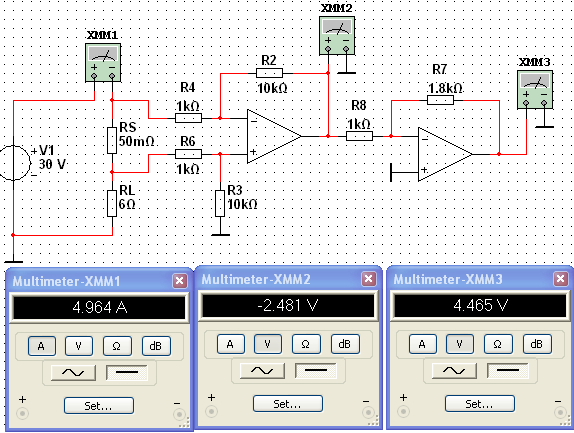

Yes, only now i get it, and @FoMoCo please accept my humble apologyes... you gave me the solution but i was to dumb to see it 🙁
I've simulated it and it seams to work well:
The resistor vallues are just for testing it, i need to read further about this config before i decide what is best, but the thing is i now have a viable solution and that's great. Thanks allot for the ideeas and for your patience.

You can switch connections for the sense resistor and get rid of the second op-amp and a negative supply. Also, be sure to size your resistor values so that the common mode input range of the op-amp isn't exceeded.Yes, only now i get it, and @FoMoCo please accept my humble apologyes... you gave me the solution but i was to dumb to see it 🙁

Indeed the sense resistor conections can be switched, thank you, that makes it possible to use single supply, but i think i still need a second amplifyer stage for greater amplification flexibility, cus when calibrating the device i need to be able to adjust the amplification in order to get the best accuracy. I would use the 5V line of the PIC controller, and LM358 operational amplifier in witch case i see that the input common mode voltage range is between -0,3V up to Vcc, so i need to make sure i do not have more that 5V on the imputs and that's a problem cus the only way i can make sure i do not have more than 5v on In+ for example at max voltage ( arround 30V ) is to have an order 6 divider there and that would mean not only no voltage amplification but rather attenuation ( is it even possible? ), a solution as i can see it would be to power the LM358 directly from the pos rail, in it's datasheet i can see that the max power supply voltage for single one is 32V, i would reduce that voltage to a max of let say 25V by use of some zenner witch would make sure that the supply voltage cannot exeed it's breakdown voltage, that way the common mode input range would increase with the output so it would be much easyer to get it right... eyther that or i am way off base here...
Good point. Once you attenuate the input to stay in the common-mode range, it doesn't give you much flexibility without adjusting two resistors for gain. The second stage would make it easier to calibrate.
By the way, attenuation is possible. Short of a floating supply, that's the only way to make this work easily.

So when powering the OA from the PIC's power line my option would be set up the resistor vallue as so at max output i will not exceed CMIR, and then the second noninverting amplifier set's up the voltage amplification the way i need it. Now, how about the other option i have mentioned? the one that would mean poering the LM358 from a variable supply ( the pos power rail ), would it be a problem that voltage will vary?

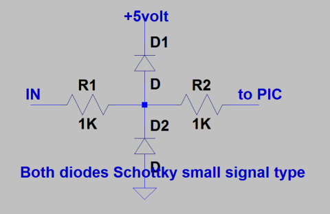

Just be sure to use a 1K (or so) resistor between the '358 and the PIC, just in case the '358 delivers more than 5V for some reason. Most PICs have input diodes that allow a series resistor to be good enough protection.
One other thing to be aware of: I had a 16F685 (I assume the same ADC is used in other mid-range PICs) that would get upset when the input voltage for the ADC exceeded supply, even with the resistor. It would not be damaged or latch up. It just read 0x00 as a conversion result until power was cycled. That was frustrating to figure out.
How I fixed the problem:
