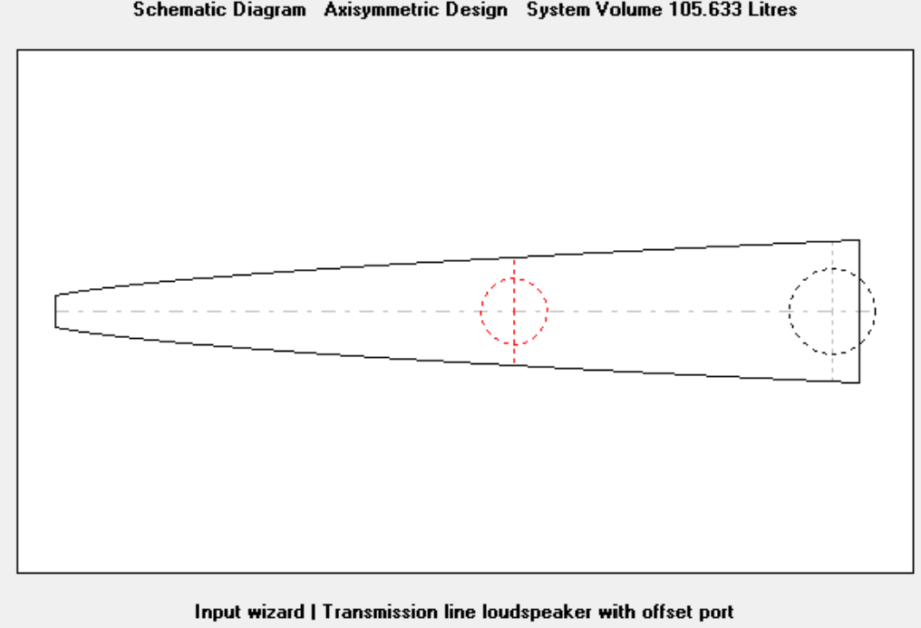

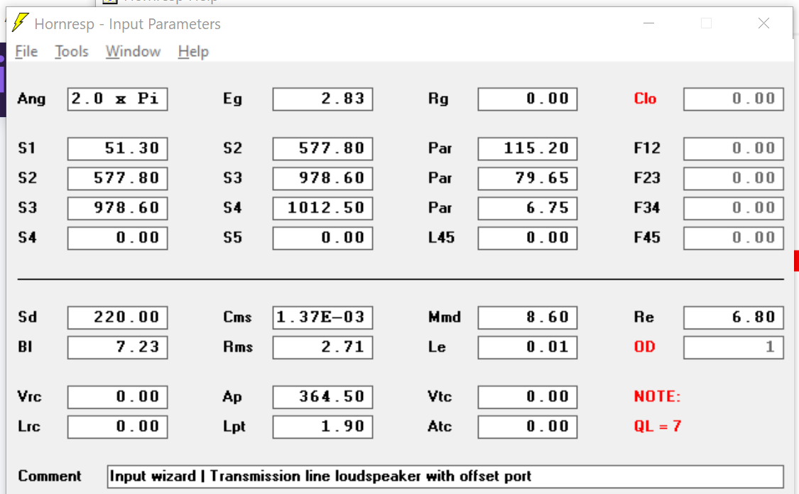

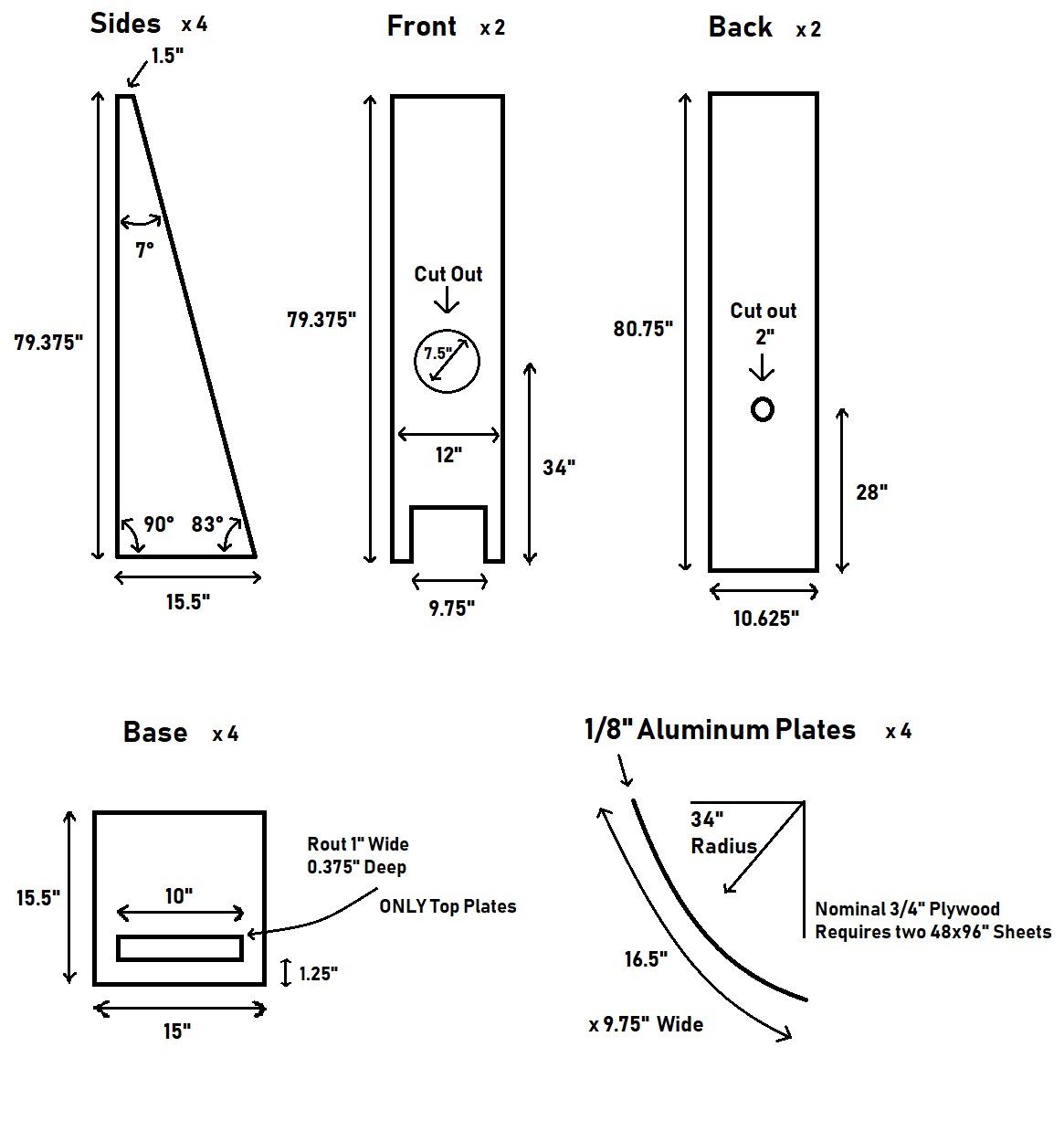

Hi all!
Am new to speaker design as I've only ever built kits in the past.
Like many before me, the TechIngredients Voigt pipe youtube video piqued my interest in Voigts.
Unfortunately, no frequency response graphs were published for it and so I decided to try and model it to see what it might be like.
I am new to hornresp and would like some guidance on whether I have set it up correctly. Based on the thread "Voigt Pipe Design", I used direct radiator, transmission line, offset port, 3 segment, parabolic in input wizard.
Attached is my exported Hornresp record. I have also attached the driver spec sheet, and the speaker diagram from TechIngredients.
There's a missing dimension regarding the height of the port. And rather than using 9.75" for the port width, I decided to use 10.625". I assumed the height of the port to be half the width of the port, hence in my sim the port is 27cm x 13.5cm.
I tried to draw the internal cavity within the cabinet walls in order to calculate the areas at the different sections. S1 = 1.9cm x 27cm, S2 = 21.4cm x 27cm and S4 = 37.5cm x 27cm.
I've no idea how to set L34 hence don't know what the right S3 would be. In the attached record, L34 is equal to half the port height. But doing so makes the schematic diagram look like the port extends beyond the "horn"?
In any case, what my input is like right now is:
Any guidance on how I can improve my inputs would be much appreciated! 🙂
