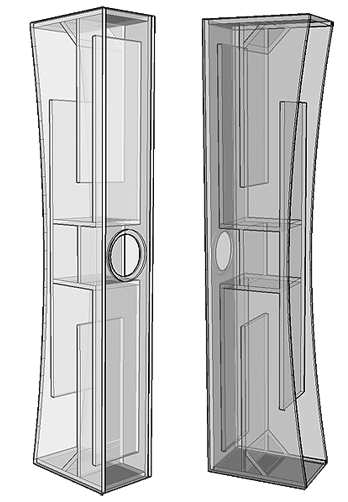

A Voigt is an expanding (from closed end to open end) transmission line. Since it expands the unwanted ripple moves lower in frequency, and the ine needs to be longer for the same tuning frequency.
It has been shown that mass loading should be used (so an ML-Voigt, as opposed to the original). This is since the lower frequeny ripples are harder to damp out with volume fill.

Thanks for the technical explaination. I decided to vent the top slightly because one was made with a small top vent and one not. I liked the vented one better. Think playing around with cavity stuffing might be interesting. Most designs say to damp the interior walls . Didn't on these. Will definitely try a better single driver fDayton Ps 95 4" I think FR looked really good on all off axis response. Thanks for responseA Voigt is an expanding (from closed end to open end) transmission line. Since it expands the unwanted ripple moves lower in frequency, and the ine needs to be longer for the same tuning frequency.

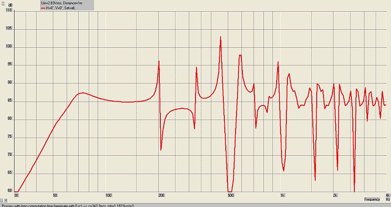

An undamped TL. One can see the fundemental and all the ripple. The nature of the ripple depends on the geometry of the line.
This is the raw response of the pipe, one is not finished yet. Completely unimportant to the discussion is that in this lime the fundemental looks underdamped.
This is typical, (and i wish more people would add damping to their sims, these are not good representations), and we have developed design tricks/tools to deal with this.
Historically (IOnley, Bailey) this was dome via brute force with volume fill damping. Modern design tools (best exemplified by the MJK worksheets), other things have developed to suppress the harmonics without the inevitable loss of bass from just using damping. Most prominant of these is driver offset (Zd), and Mass Loading. The first can pretty much cancel out the hardest to kill 1st unwanted harmonic, and the latter acts to bandpass the terminus.

How much and how to stuff depends heavily on the specific design. I have drawn an awful lot of TLs, ML-TLs, ML-Voigts, the damping can differ from volume fill to a lining. An extreme example of a voigt, the BIB, requires considerable damping in very specific places as well as the corner loading.
The microTower ML-TL, out big MTMs, and Tysen V2 have volume fill, most Metronomes (a version of an ML-Voigt) usually get away with lining and sometimes little of it (a combination of pipe geometry, Zd, mass-loading, and a downward firing terminus to create the low passes needed to remove most of the ripple, but Mileva and Demetri (ML-Vs) wanr something in-between.

The restricted terminus bandpass nature reduces combing (the primary reason it is used). One needs sufficient amount of low pass from the cabinet out the terminus so that the frequencies that comb never come out. The ripple is causesd by the combing.
