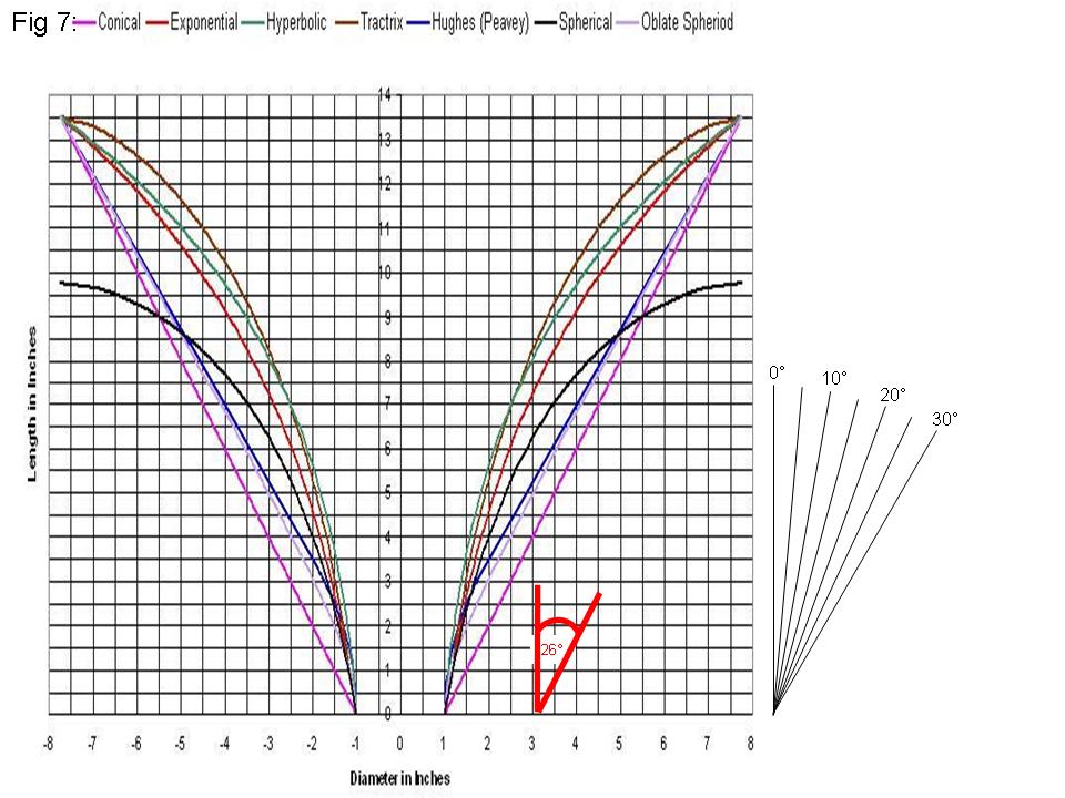

Assuming parallel sides they're a parabolic expansion; technically a mass-loaded (to some degree) horn with an offset drive unit, though functionally they're a standing-wave generator since they're rarely impedance matched at any point in their usable BW. I wasn't going to say it, but like many of the Youtube projects, that 'World's second best...' isn't a particularly good example of the type.

Right, conical if tapered or parabolic if there's any parallel flat sides as Scott noted.It is not exponential... 🙁
