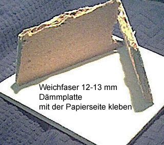

zycomatique
Hello,
i made exellent experience with soft fibre board,
very cheap, most 12-13 mm with a paper layer,
if you use it tripel for inside walls you reduce enclosure
sound very well.
look my horn construction plans on my HP.
