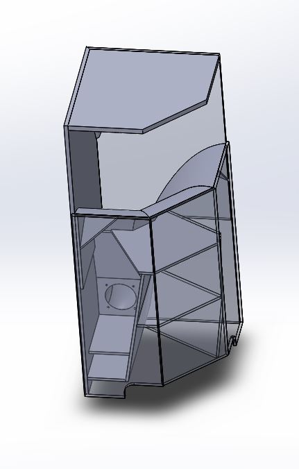

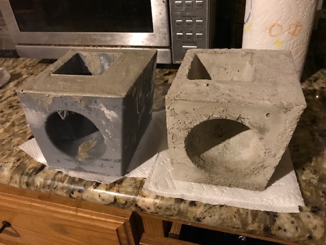

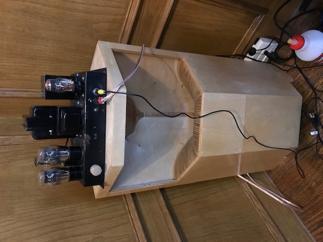

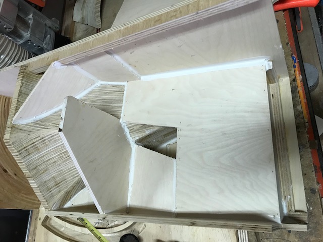

After thinking about the Voigt Domestic Corner Horn since the 2013 article, I finally have the basic skills to attempt modeling up and building a half scale speaker. Since there was no available build plans nor dimensions, most everything were "interpreted" from internet pictures or made-up.
The 3D model looked good in the computer. For real fabrication, had to modify just about everything.

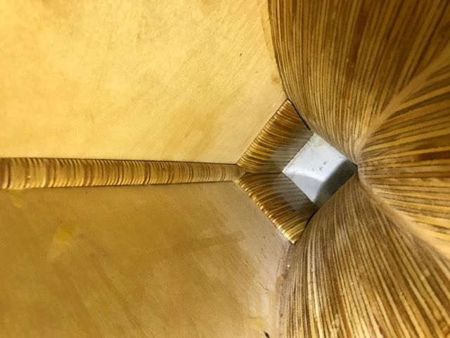

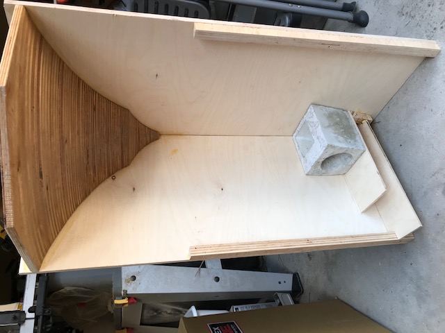

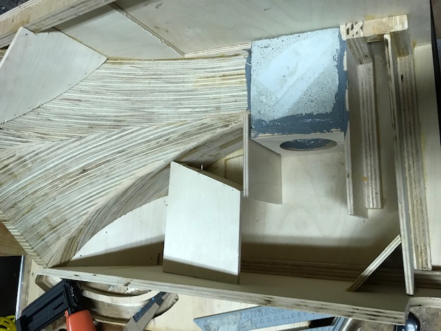

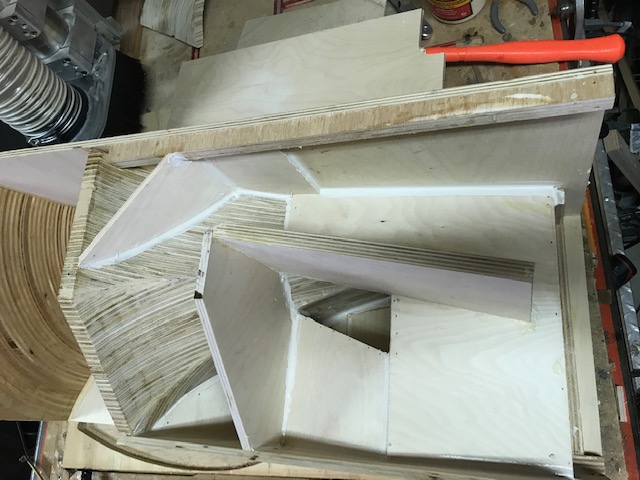

The molds for the concrete reflectors were 3D printed. The material of choice was baltic birch plywood. The top reflector and horn were glued up from cut plywood. Drivers are Fostex FE83-Sol.
