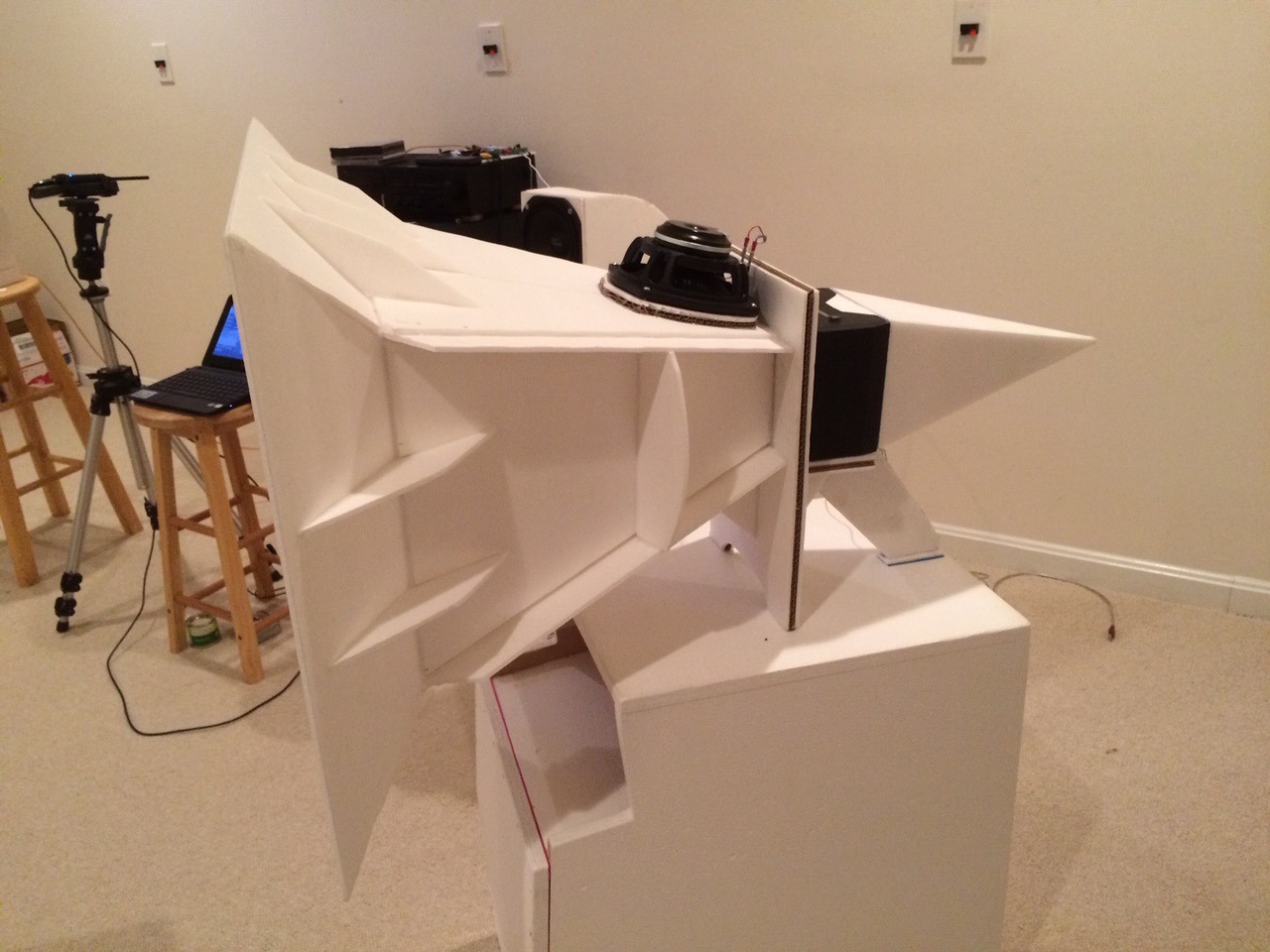

The box on the bottom is a 4 driver FLH with a special topology for the feedback loop (a ring resonator). This could only have been dreamt up using Akabak. The top is a Heil AMT tweeter and a B&C 6MDN44 midrange. This is still one of the best sounding speakers I have ever made or heard.

You be in another league, my friend...This is still one of the best sounding speakers I have ever made or heard.
