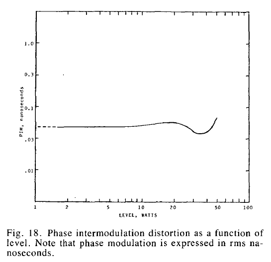

for audio amplifiers the high frequency low pass fliter group delay as I already mentioned can be < 1 microsecond, the differential group delay ~ 10s of nanoseconds - no "what ifing" required
Bob's MSOFET Power Amp article used custom built quadrature resolving IMD hardware to give PIM/TIM in Otala's terms of 10s of picoseconds
low frequency corner can be more significant but in many AC coupled audio power amps the corner frequency should be < 2 Hz
DC servo generally use film caps instead of Al Electrolytics if you are suspicious of them, and even 0.2 Hz corner is possible, even 2nd order - Cherry has suggested Bessel high pass if any were concerned by filter group delay in the room modal response region
but really for diy DC coupled with manual trim is quite good enough on offset, and "perfect" on group delay issues
