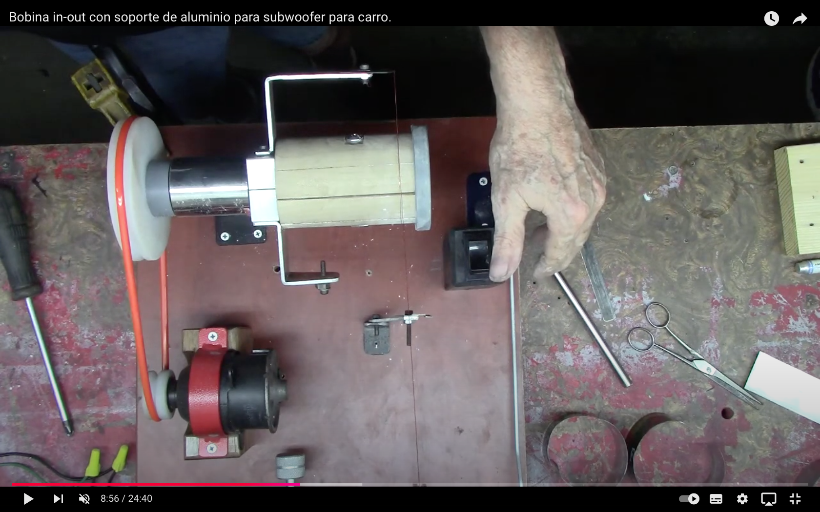

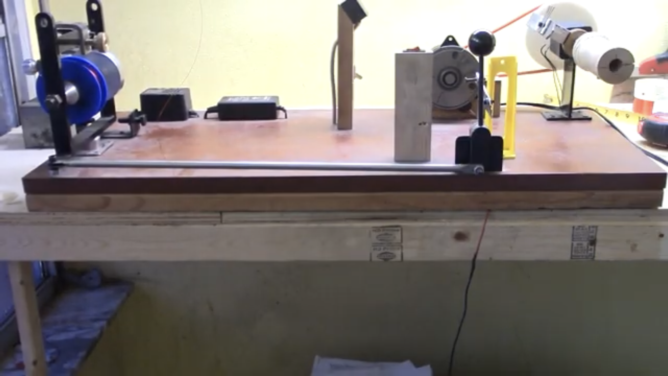

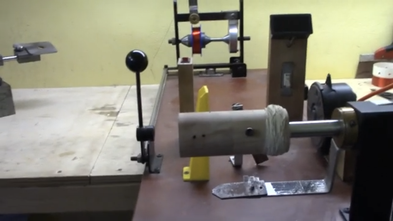

That’s Luciano’s Setup.Is this Luciano's or your own winder?
I wish it was mine. It’s very good.
He’s got a transformer with caps there aswell. I think he powers the coil to get it up to a certain temp. He’s got a thermal camera aswell.
Cheers

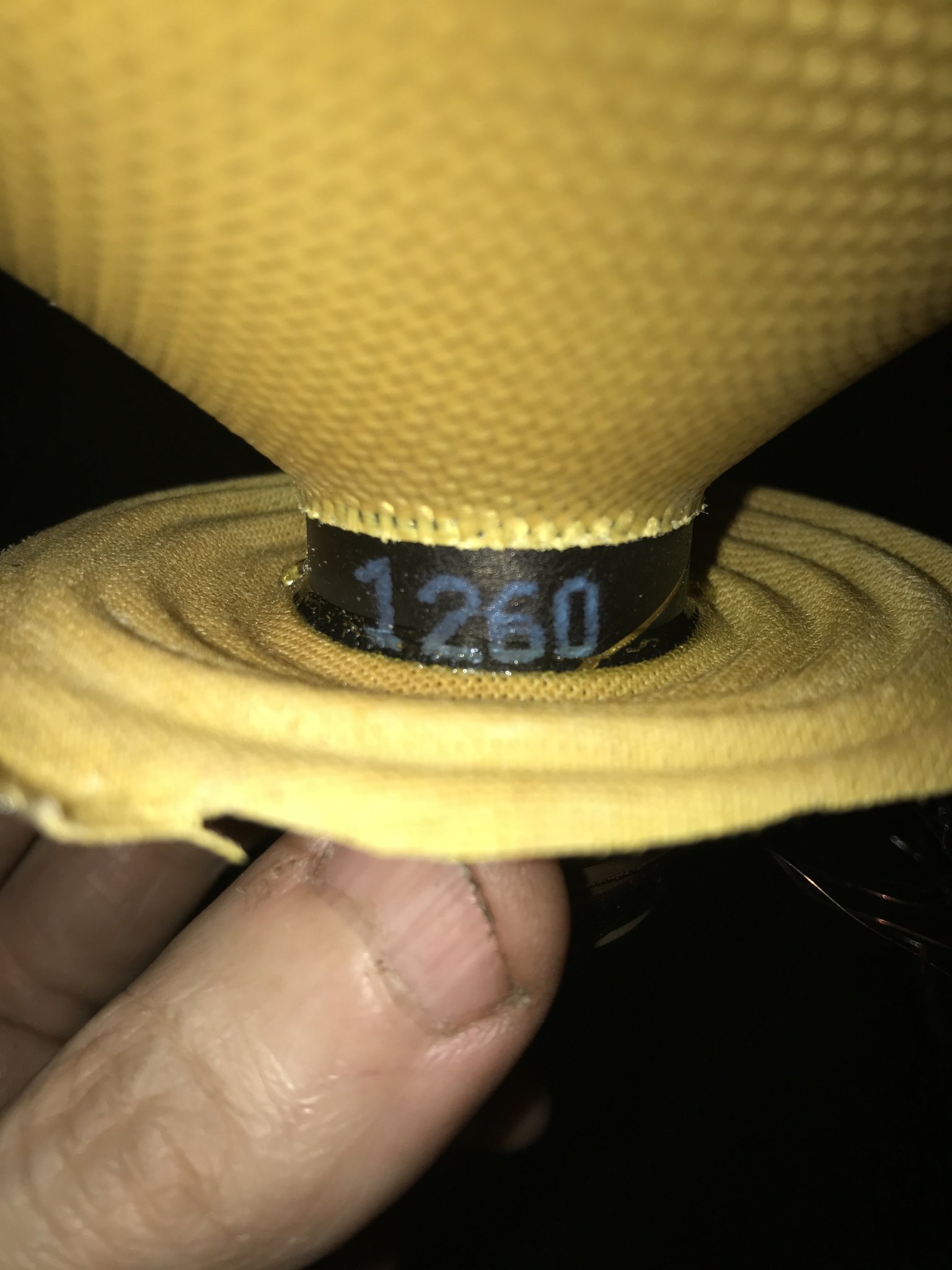

Does anyone know anyone in the U.K. who makes coils.? Good ones.
I’ve got all the measurements.
1260 on the coil aswell. 1.26”. Fairly small.
They’re for B&W 601 S3.
I wish I could make them ,but I only need 2 and it would be too much lay out and time to make them right.
I’ve contacted reconingspeakers.com. US. Waiting to hear back so far. Anyone used them before.? Can’t find one in the U.K. as of yet.
Cheers
Cheers
I’m noticing that there are not many around that make coils. When your looking. You can’t see any. Just eBay etc that’s all.
I can see why you would want to make your own.
Apart from the winder itself you need to have a setup that’s accurate and adjustable. Need a fair few bits whether bought or made to have that. Any proper metal worker or engineer could make that stuff easy.
I posted those from Luciano so people can maybe get their own ideas and see what might be needed.
Take your time with it all.
Cheers
