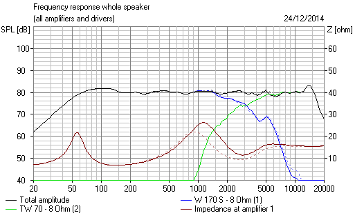

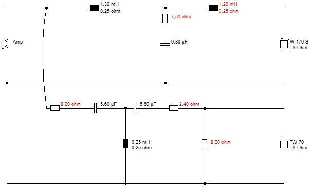

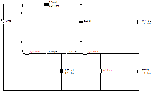

Voicecoil inductance Le and DC resistance Re are interrelated. Where it gets interesting is when you add copper damping rings to the pole piece. This has the effect of reducing voicecoil inductance.
Which then extends frequency response. Because inductance limits frequency response because it creates a LR filter.
In practise, voicecoil inductance is not much of a problem. It's sort of built into the usual filter. What looks like a second order bass in the first image, is actually a third order with the phantom 1.2mH inductance of the Visaton W170S here.
I then show a second circuit which has almost identical frequency response with that same W170S driver. That's how it works. We can therefore add resistance and take out inductance in the filter to correct the rising inductance of the driver. I include a third image of the unfiltered bass driver in the 12L box to show raw impedance and response. The fourth image shows how equivalent the two circuits are.
The big idea, is that if the driver has inductance, which gets worse with frequency, you can then remove it from the filter, if you follow? If it has no inductance, you might want to add some. For all that, I suspect the low inductance driver will sound better ultimately. But will need a more complex filter.
Don't know if I explained that well. But there's more than one way to skin a cat.
