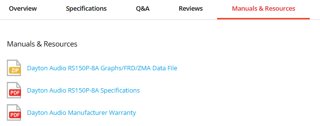

I tell you, I didn't any measurement. I only calculate the inductance values with those parameters published in files to download, offered by Parts Express at "Manual and resources" pages.
I attached *.7z compressed files as per requested by diyaudio. Excel files *.xlsx are not allowed.
