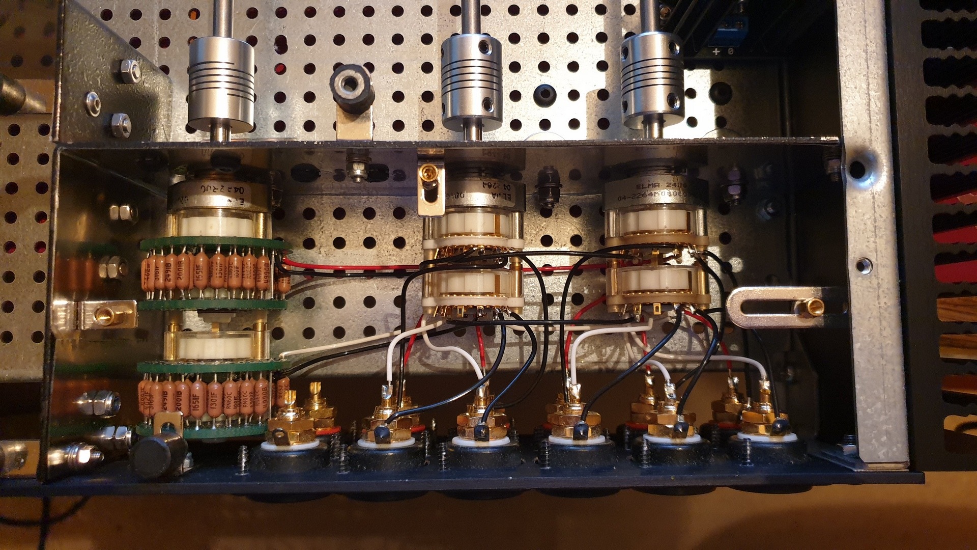

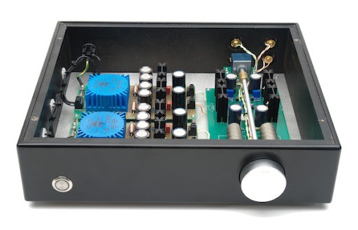

Folks, when there's a rod between the front panel and the potentiometer, what the heck is it called? Is there a place to purchase these or do people manufacture them DIY?

Extension shaft.
I go to Home Depot or Lowes, get a 1/4" aluminum rod and cut it to size.
A coupler and a front panel bushing and.... done.

In my experience the kits for sale as potentiometer or attenuator extension shafts with a mounting bracket and a rod are rubbish quality. Just buy a length of rod and make your own mounts. Highly recomend you use a flexible coupler too, they are commonly available as shaft couplers for 3D printers.

I recall once embedding a spare 1/4" (6.35 mm) ID sealed ball bearing for the purpose (the front panel was wooden). Used an old Johnson-style universal coupling for the potentiometer connection. Overkill perhaps, but they're what I happened to have on hand at the time. No side play and silky smooth.

With the parts linked in this short thread a high quality extension shaft combo can be had, much better quality than the "kit" offerings from eBay, Ali, Audiophonics, etc... I use aluminum 1" x 2" L-angle to make a bracket to hold the potentiometer/selector switch.
GD-Parts sells them... https://www.goodcomponent.com/products/knobspotentiometers/potentiometers/1450.html

The rods are commonly marketed as shaft extensions. The gizmos used to connect the shaft extension to the potentiometer are shaft couplings. McMaster-Carr has the couplings too.
The idea behind the coupling is to take up any slight discrepancy in position/angle between the pot shaft and the extension shaft. If you use a coupling you get a smooth feel to the knob. Without the coupling you'll likely find that the control binds in one spot.
