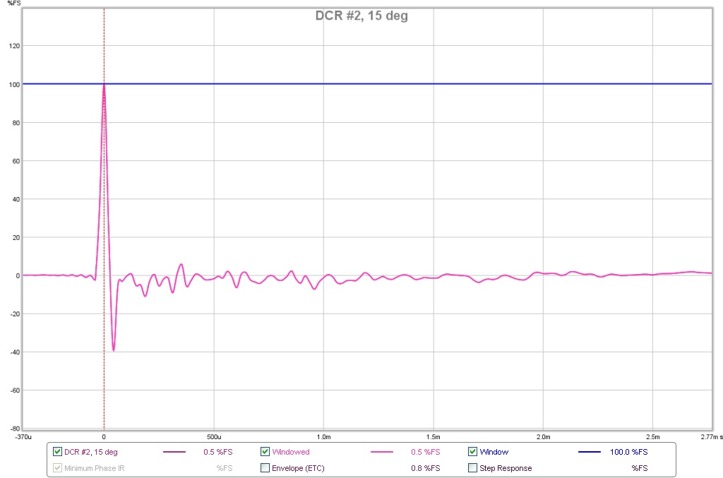

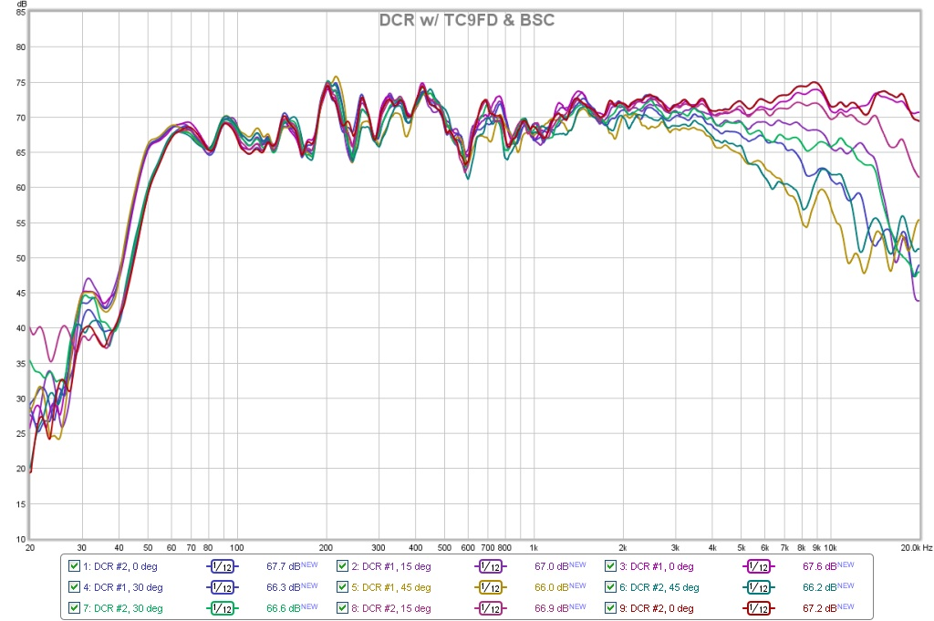

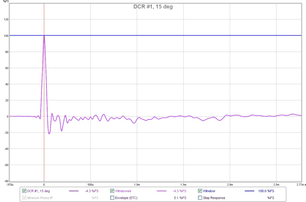

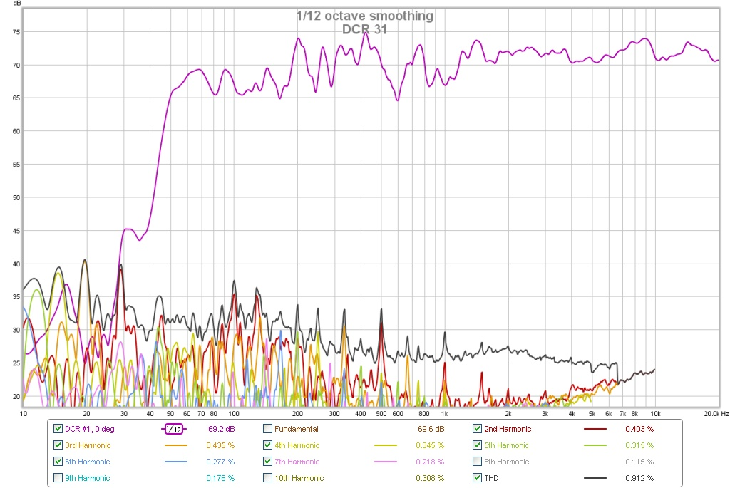

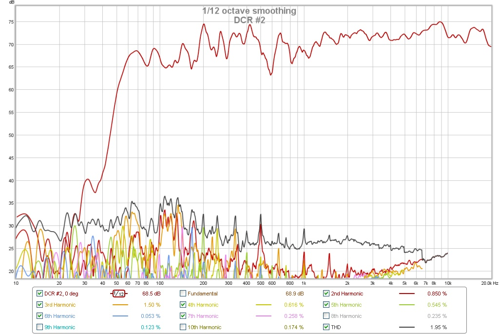

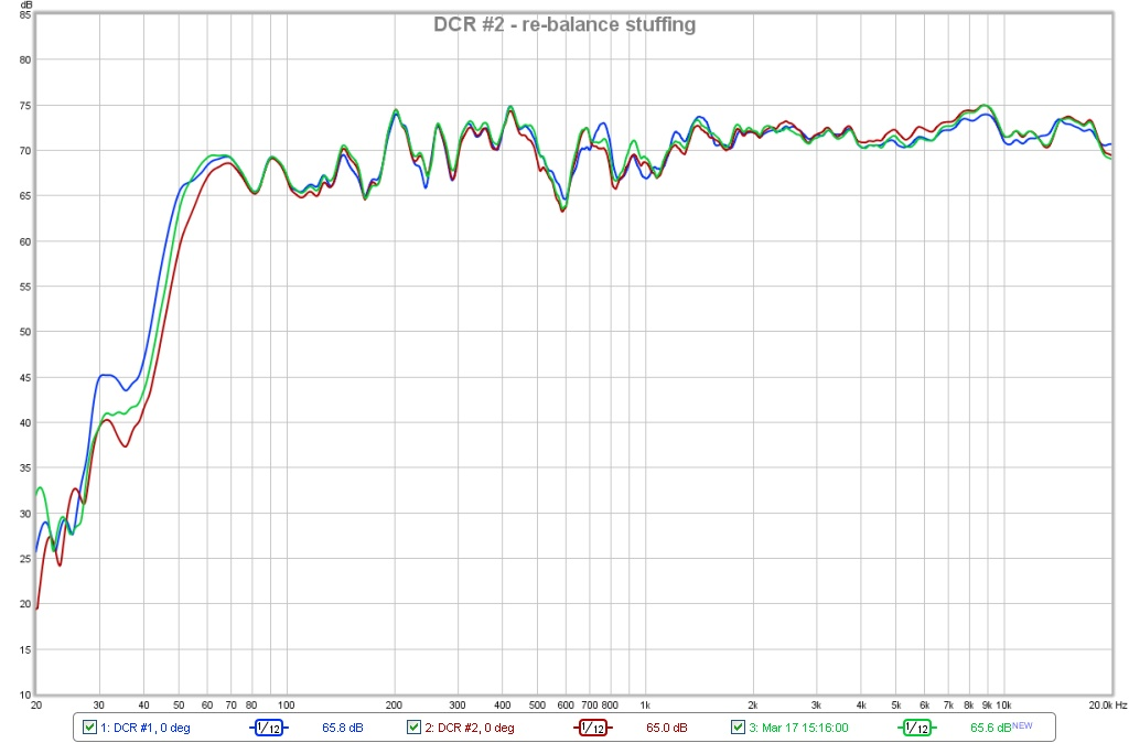

The second unit has been built and tested. They sound very nice in stereo and they measure very nicely too. Here are some measurements at reduced levels representative of how I would listen to them in stereo. The distortion is way down and relatively flat from 50 Hz to 20 kHz.
Here is the SPL vs Freq over different approximate polar angles ranging from 0 deg to 45 deg for both speakers:
At first I was not getting as much bass extension from the second unit so I rebalanced it by reducing some stuffing in the upper chamber and both speakers now measure pretty closely (green is new trace after rebalance - compared to maroon):
Harmonic Distortion of DCR #1 at typical listening levels:
Harmonic Distortion of DCR #2 at typical listening levels:
Impulse Response for DCR #1:
Impusle Response for DCR #2:

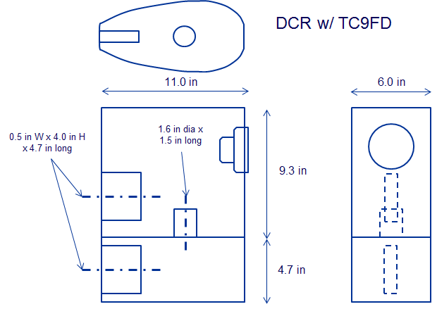

Plans on post # - is the "rib" piece drawn in the correct proportions?
Attaching for your reference.
No, that is not to scale. I have the template somewhere but the key thing to do is make the front flat as wide as you need to mount the driver, I think I used 4in. I made the main body 6in wide at its widest point. The rest self formed curves to follow the flat front to the 6in wide and then tapering towards the tail width. I don't have the speakers anymore, Byrtt has them so he can probably get a measurement for you.

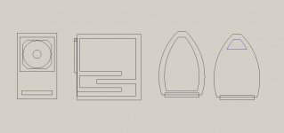

What's the dimensions if you want to do a rectangular version of the DCR? I don't have the skill with foam to do the curves yet.
Erknie,
In X's first post on this thread he mentions the total volume of the cabinet being 12.5 liters, with 2/3 going in the top chamber and 1/3 of that volume allocated for the bottom chamber. Roughly, the internal dimensions of upper chamber can be 8.5" x 10" x 6", and other part 4.25" x 10" x 6".
That's the correct approach - go by volumes and set whatever cabinet size you need keeping in mind need to fit driver width and need for vent to be contained internally. Also, the wider the baffle or closer to a wall that you use the speaker, the less BSC you will need.
