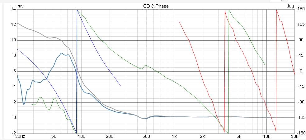

I am not sure, but excess GD in a loudspeaker is caused by eg. non-optimal xo or driver unit physical pathlength mismatch - sort of difference between old-school electric xo design vs. acoustical measured outcome
Measured acoustical GD - theoretical predicted GD = Excess GD (can be positive or negative)

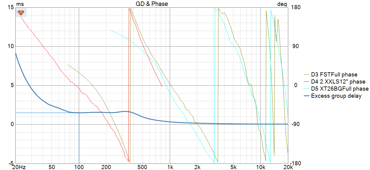

Excess group delay may be due to the crossover, but it could also be the result of acoustic problems like reflections. It isn't possible to correct these electrically, but it may be good to know they exist if you want to fix your listening environment.

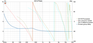

I had to do some thinking with excess group delay, it's relevant question why would one use that instead of normal group delay in VituixCAD?
Long story short it's the most relevant one.
Normal group delay is sum of minimum phase group delay and excess phase group delay. Minimum phase group delay is not shown separately in VituixCAD. A system whose frequency response is wide bandwidth and smooth if not flat, a sensible goal for any loudspeaker, the minimum phase group delay would be close to flat and tell nothing about the system inner workings.
However, excess group delay would show the crossovers and any issues, as said by others. When a system frequency response is ~flat normal group delay would be just the excess group delay because minimum group delay is flat. Thus all the relevant information is in excess group delay.
Few examples to demonstrate, if it helps thinking about it:
Ideal source, excess and minumum phase group delay are flat, normal group delay ends up flat:
Ideal source again, but with a crossover. System frequency response is still flat so minimum phase group delay would be flat, which means normal group delay is just the excess group delay.
Introduce non-flat system frequency response by adding high pass filter, and minimum phase group delay starts to increase on low frequencies, thus normal group delay shoots up on the lows. Move the high pass bit higher and minimum group delay changes with the response, but excess group delay stays the same! excess group elay is due to the crossover and not due to the system frequency response!
The minimum phase group delay can already be anticipated being not flat just looking at system frequency response, so it's much more easier to see and understand the system frequency response than try and figure that out from normal group delay plot.
But, in addition the excess group delay tells a story, here it's crossover around 1kHz with particular slopes adding this particular excess group delay to the system. Hence this is new information to what the system frequency response already tells about.

ps.
if one has now a question what is minimum phase group delay? It is simply this: take frequency response data, ignore all measured phase data and calculate phase from the frequency response instead. Minimum phase is kind of the ideal phase. And minimum phase group delay is simply calculated from that. Phase info and frequency response are the same thing, just from different perspective, and can be derived from each other in this minimum phase sense. However, often there is something that makes measured phase differ from ideal or minimum phase even though frequency response could be the same, for example some secondary sound or phase rotation introduced by filters. This is excess phase, difference between measured phase and minimum phase. One could think the excess group delay shows how much the system differs from ideal.

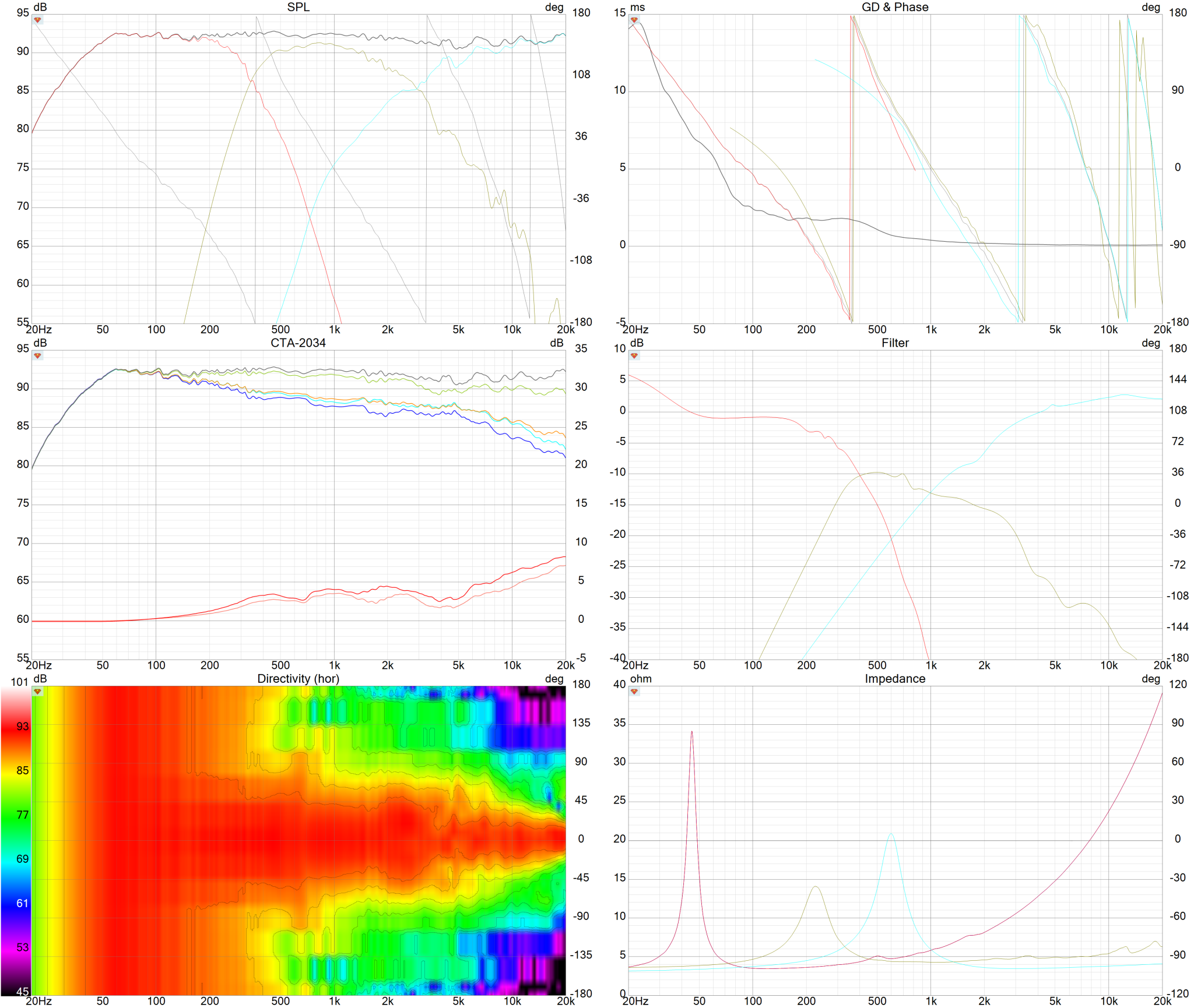

I recently went to revisit my dream speaker's reviews. Of course, the Snell A/III. You don't have to like them, but I sure did. The part for me that was super important was remembering how good the speakers were before phase unrolling was a thing. Here's the two parts of the Stereophile measurements I want to equal. The first is horizontal dispersion. The second is the step response.
Peter achieves this using mostly 4th order filters but possibly a sixth order low pass in the bass (according to Troels here). I know there's the possibility of excess group delay in the bass section, but even so, if I can get anything near these results I'll be giddy with delight. I can always revisit this later if I have time and energy.
I'm not going to attempt a 6th order bass filter, BTW, I just wanted to point out how much he achieved with it.
Just posting this here so my initial project has achievable goals to meet before I start going crazy trying to equal the measurements of say the Grimm floor standers which I haven't even heard.
