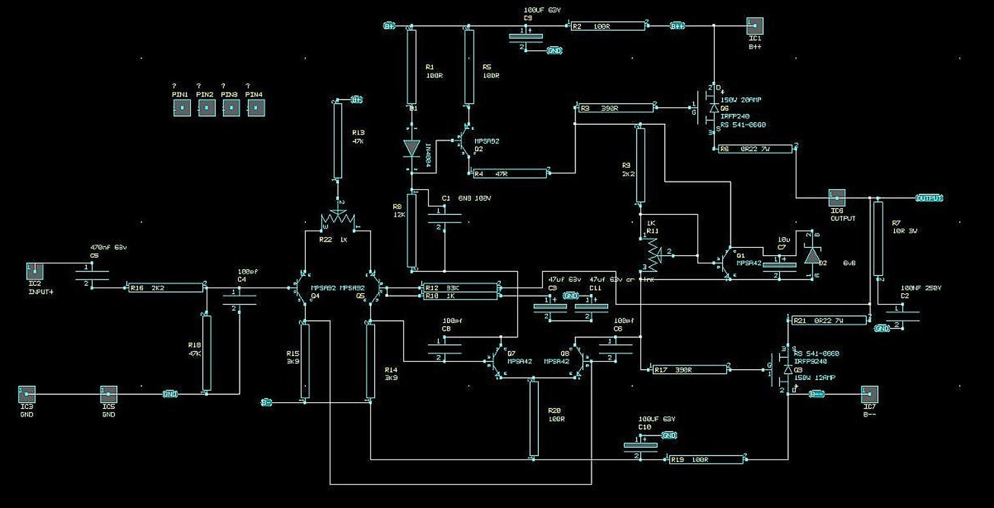

In 1980 I built the Maplin lateral mosfet amplifier.
This was based on a Hitachi datasheet lateral mosfet amplifier schematic.
It worked well.
A few years back I decided to see if I could modify it to use irfp240/9240.
So designed a new pcb with new outputs.
I added a dc offset pot, Vbe multipler and decoupling of front end to reduce hum.
Not a bad sounding amplifier.

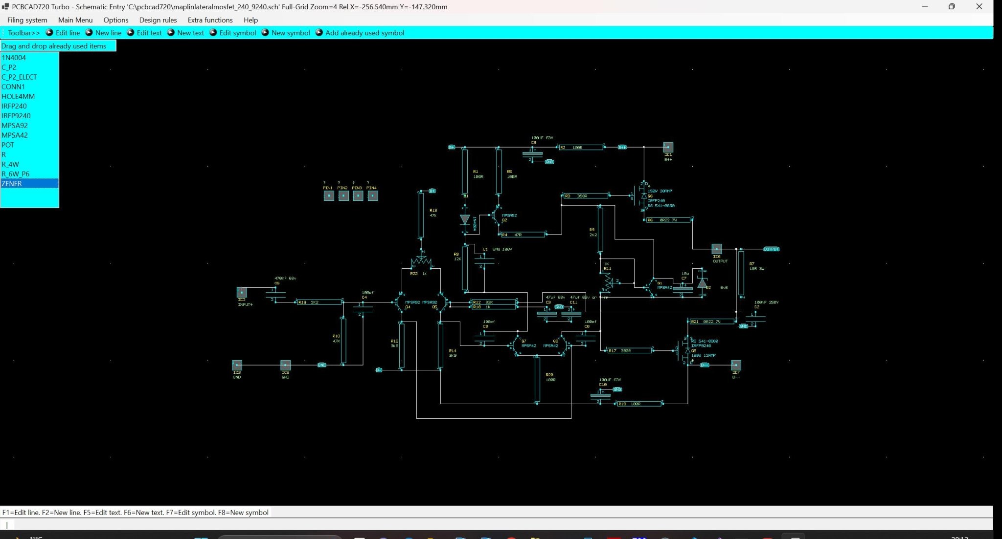

Dear Nigel, with due respect , your schematic is impossible to read.
To boot, it only uses a section of available space and seems to be just a screen capture.
Can´t you please "print" the schemtic, to, say, a PDF virtual printer (think CutePDF or similar), cropping useless space away, black lines on white background (hint: like a printout) and since we are at it, using somewhat thicker lines?
It would be WAY more readable.
Saving to .gif or .png would also avoid the .jpg artifacts which have NO place in a Technical drawing, ( .jpg was created for HIGHLY compressed vacation and birthday party snapshots).
Thanks.
Hi Nigel,
Yes, it will work with those different mosfets. However (don't you just hate that?), the newer ones you used have something called "gate charge" characteristics.. They must be driven with a low impedance, higher current driver stage and they still are not great. The lateral mosfets do not have this mechanism, so it's much more than simple biasing.
-Chris

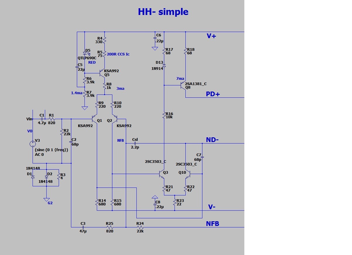

That design is the "olde English" he he (HH audio amps). One of my "5 minute wonders".
(below) is it's simplest form - HH drove lateral mosfets direct with it. I drove a vertical EF with it - perfect.

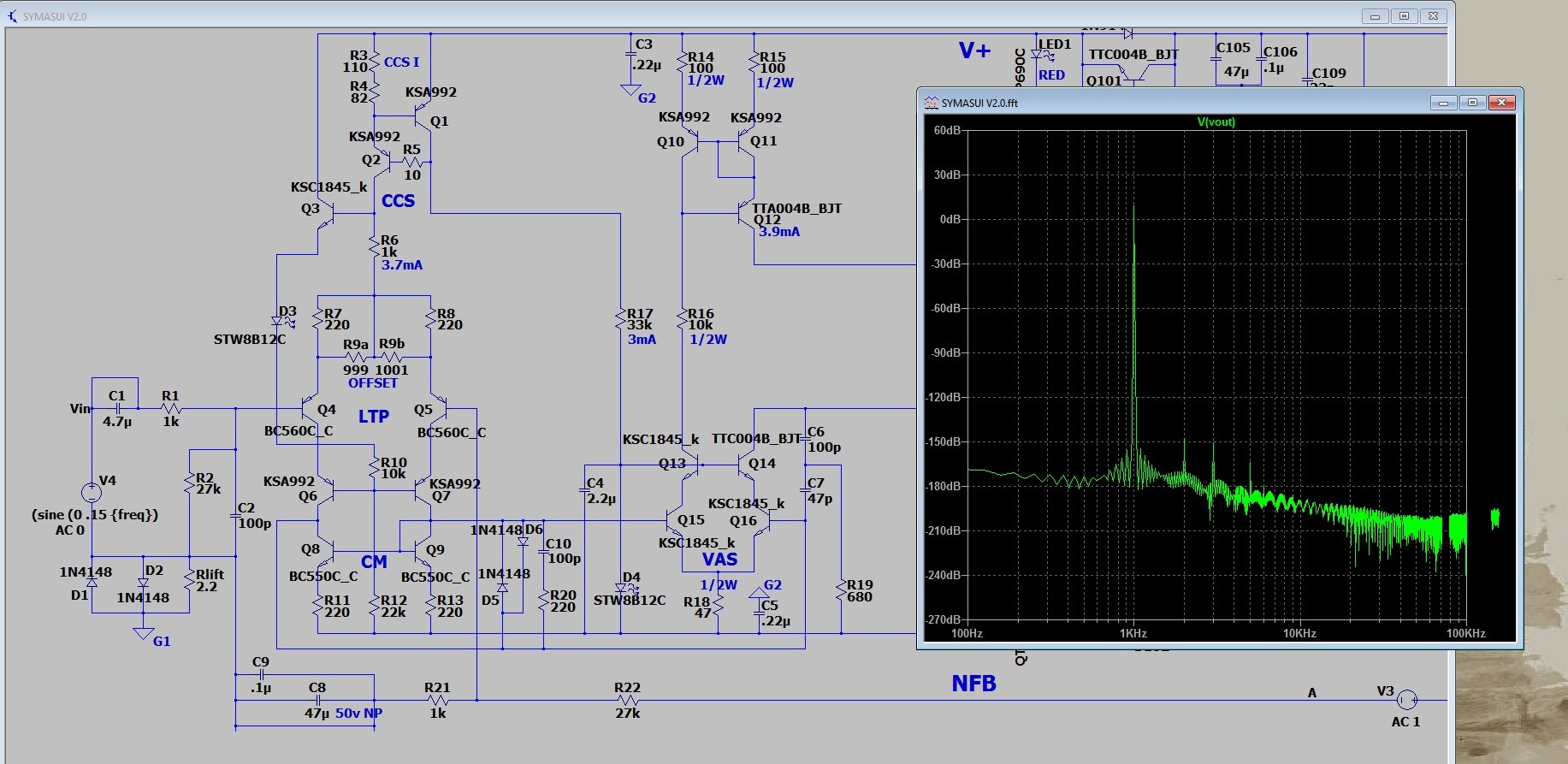

Hitachi did a little better , this topology in "21'st century form" (below 2) can beat the Wolverine !
You do have to add a few more parts .... but get sub PPM.
OS
Yes , laterals have high'ish gate capacitance , but less. HH ran the posted VAS at >10mA with appropriate gate resistances to
"get er done" , Bigger multiple lateral OP stages used a BJT driver pair. Holton "aussie" amps also uses this topology (with drivers)
and lateral (Exicon ECW20N200 with a whopping 900pF gate capacitance.
OS
