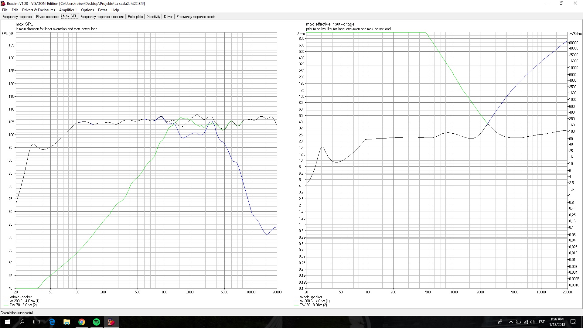

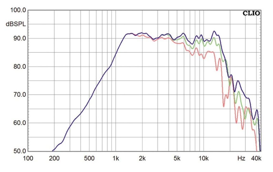

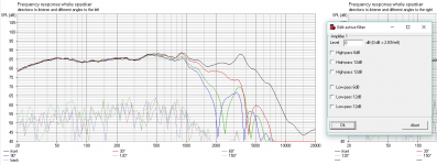

But what about the ht-22. It is only 10W rms. If I cross it around 2000 hz. I copied the MAX SPL graph from boxsim. But I´m not sure if I understand it right. Does that mean, it is comfortable at same power levels as the W200s?

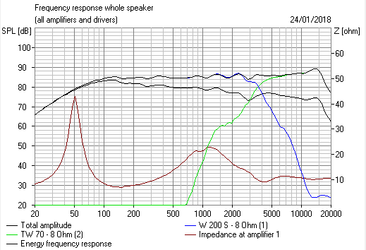

A fourth order filter on the 7 ohm TW70 tweeter and some impedance correction on a second order bass looks good too. I have built something close to this circuit and it sounds very good. Substituting the 6 ohm Monacor HT-22, which is a better sounding tweeter IMO, hardly needs any adjustment. You might give it a slightly more rising top end to allow for the fact it is flatter than the TW70.
Yes, been reading all of your posts that I could find about those drivers. Tried to simulate the crossovers etc. I would like to cross them somewhere around 2000 hz. Mainly because the designer himself told that the tw70 should be crossed over before 3000 hz, because it sounds best. He did not say exactly where, just before. It was in some german forum. And the 2000-2500 region seems to come out every time I try something new. But I´m still not quite sure, if I should be satisfied with the phase response. I have no experience, and every post in here I see has better phase, and every build I look in the Visaton boxsim project site, is worse.

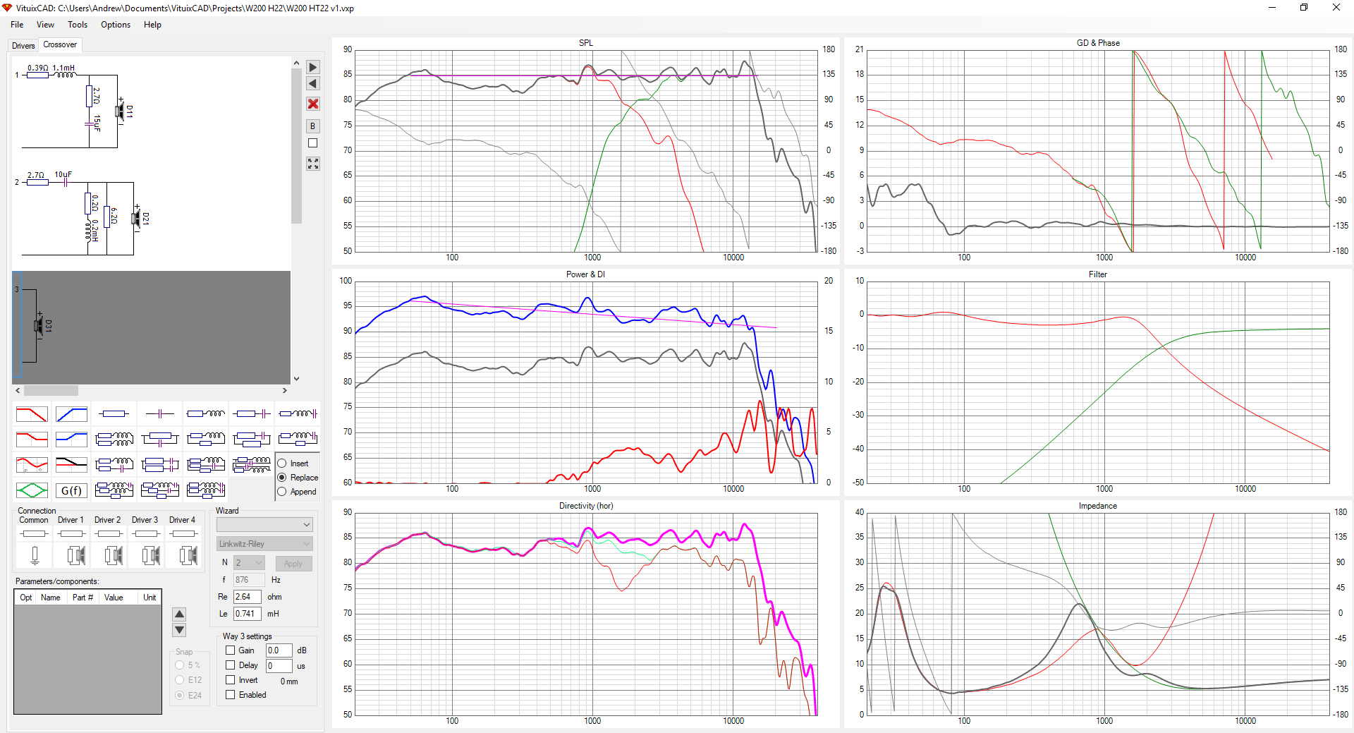

I thought I would see what happens if you combine your initial crossover with the HT22 as suggested. I scanned the file into Vituix CAD from the files I created for the W200S and found some measurements from a foreign language site where they had measure the HT22 you can see the source files below as well as the simulation with your existing crossover. As suggested it comes out a bit brighter.
I will see if I can find a smother solution.

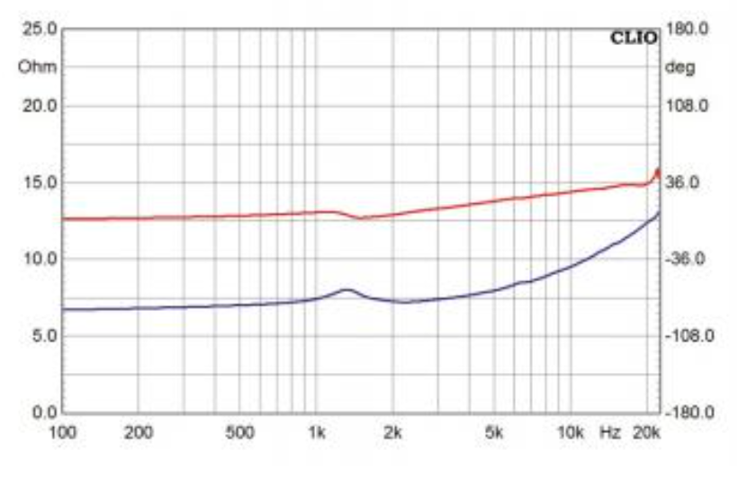

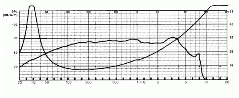

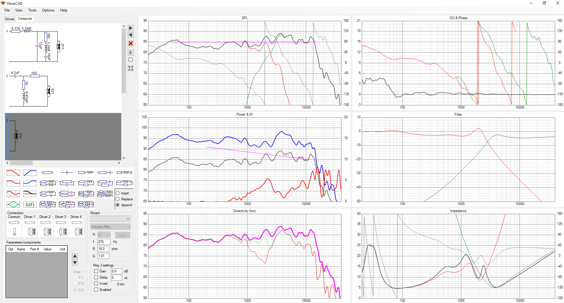

Had a bit of a play. This is the best I have come up with. However it currently includes no baffle simulation or box simulation. My concern with this is it pushes the HT22 really hard but if you don't you get a large variance in the off axis response as the dispersion pattern goes from Narrow to wide at the Woofer to tweeter crossover.

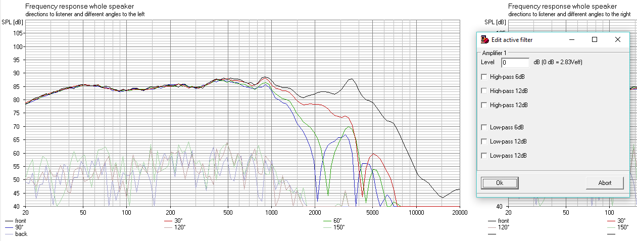

Hey. I did make a simulation with ht22. The last picture is ht22. Not a frequency graph, but max spl, I don't know how to read it. I also made vituixcad simulation with graph from boxsim (w200s), and added the manufacturer graph of ht22. I know it is still labeled as tw70. I just couldnt get a better phase and frequency good enough, so I havent posted those yet, because I'm not satisfied.
The MAX SPL graph is derived from the linear excursion entered for the tweeter. I could not find any data for the HT22 linear excursion. Where did you get the data from and what did you enter. A typical value for a cone tweeter would be 0.25mm but I have no idea what the HT22 actually does.
If you have entered correct linear excursion then your reading of the graph is correct the tweeter has close to the same excursion limit as the bass driver.
Excursion limit is not the same as the power limit as you can see the tweeter will be subject to an instantaneous power of 100W. So the tweeter will be able to deal with the anticipated excursion however in prolonged use it might still exceed the power limitation as it will over heat or the current at 100W might cause the tweeter wire to fuse.

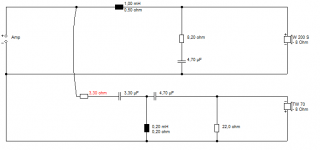

If you had read the whole thread you would know I have already discussed a circuit specific and suitable for the Visaton drivers:
655886d1515564309-visaton-w200s-tw70-system7-suggested-circuit-la-scala-design-png
655885d1515564309-visaton-w200s-tw70-visaton-drive-units-system7-lashup-jpg
http://www.diyaudio.com/forums/multi-way/317015-visaton-w200s-tw70-2.html#post5303698
At some point you have to just get on with it. You might even find some components need slight adjustment to your taste and the room acoustic and placement. I also do circuits that tend to work with most well-behaved drivers. This, I feel is a useful approach for diy. We can't always get exactly what we want, so compromise a little.

If you have a promising equivalent driver, we can look at what adjustments might be good. Loudness adjustment, reflex or closed box, adjusting impedance correction for woofer inductance etcetera. This is the hobby, and the outcome depends on your skill. And you find that it is not very critical sometimes. The perfect can be the enemy of the good.

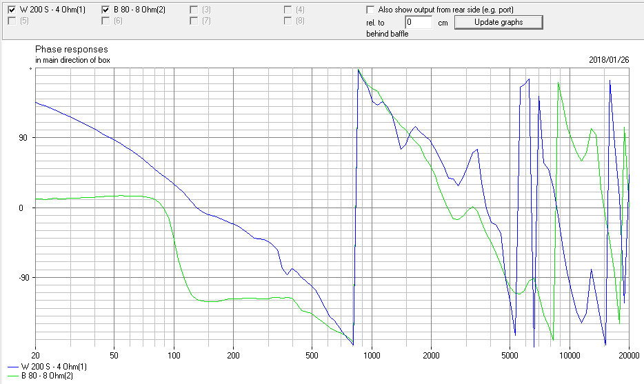

Nice to see another Visaton 2-way build. Steve helped me a lot. What Lojzek says about these drivers doing well in a large sealed enclosure is good advice. What I found is that these drivers are listed as woofers for a reason. They don't do midrange as well as they say. I believe in flattening the woofer's impedance with resistor and capacitor.
As for the Alto II, the crossover doesn't look sufficient - it can be better. My 2-way W170S+SC10N has very tight bass (or defined, should I say).

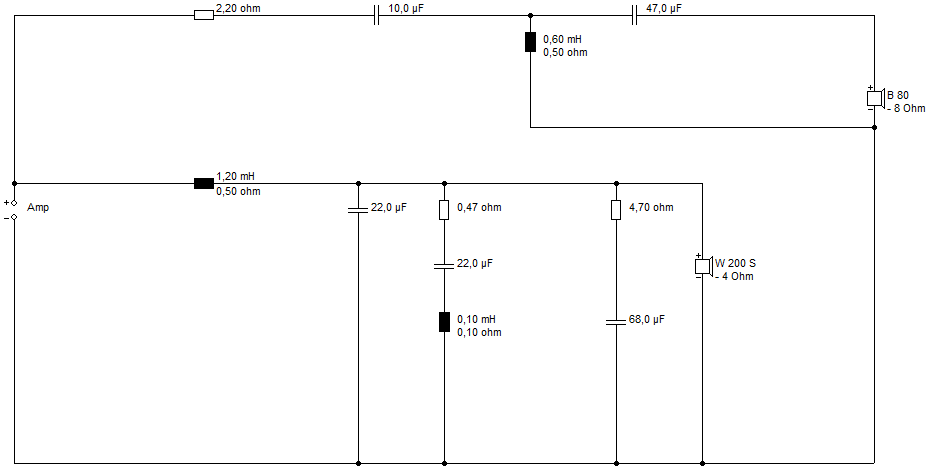

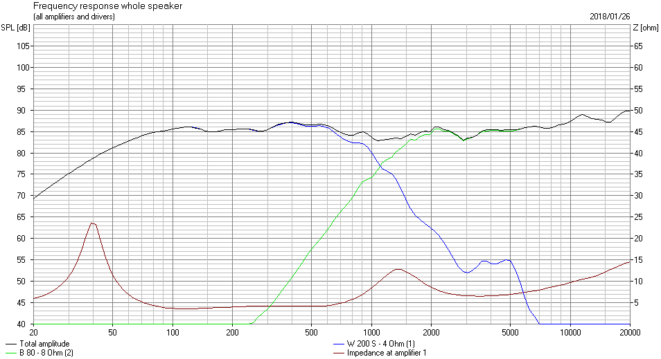

A suggestion could be to use a full-range driver for a tweeter, like the B80. Something like attached to show what could be done. Inner dimensions of box: 85x19x27 cm, sealed. I'm not any expert, so I'm sure there are issues with the crossover, but if you went this direction, perhaps this is a starting point.

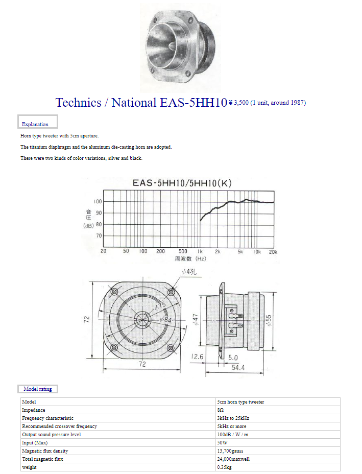

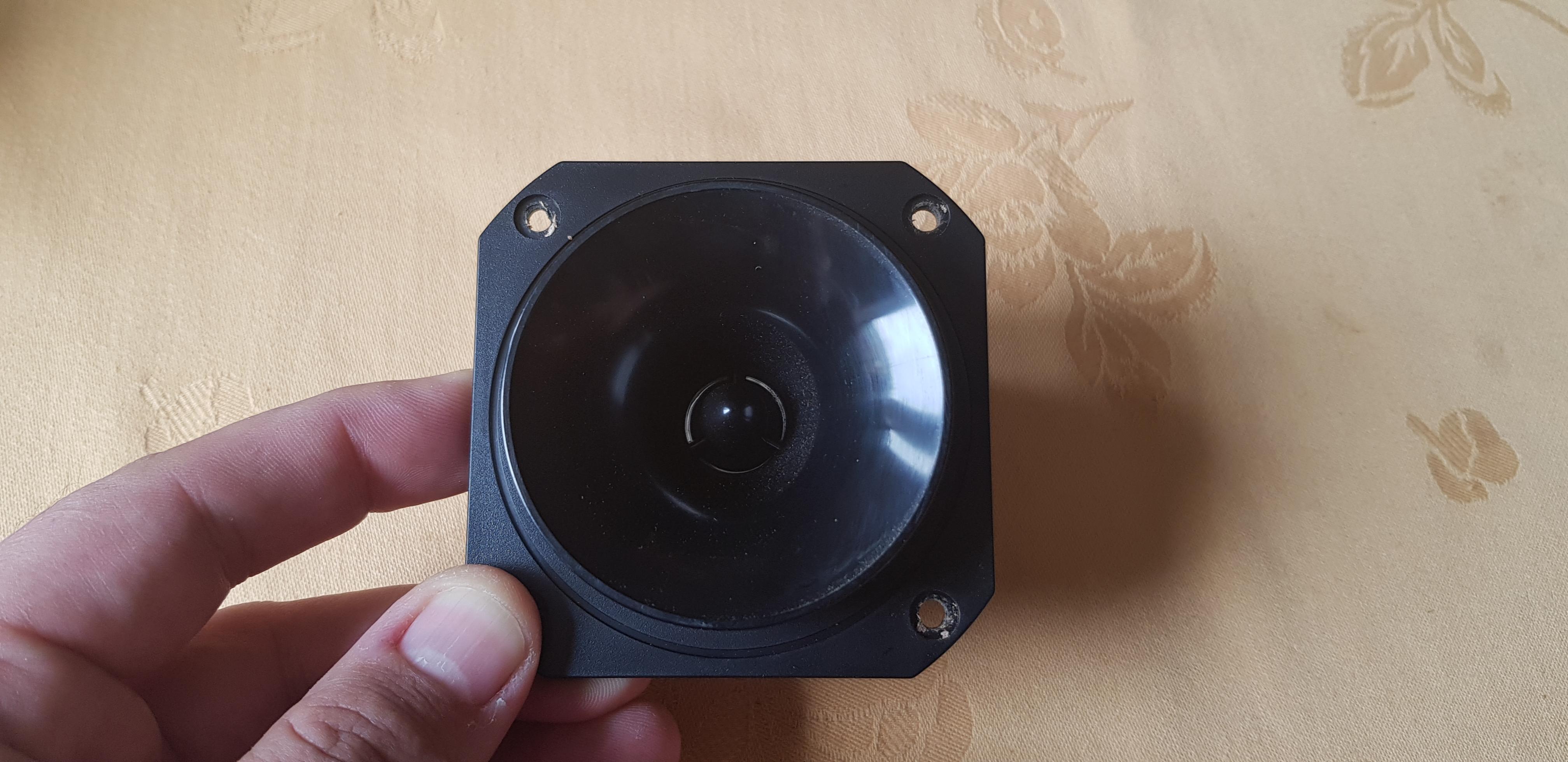

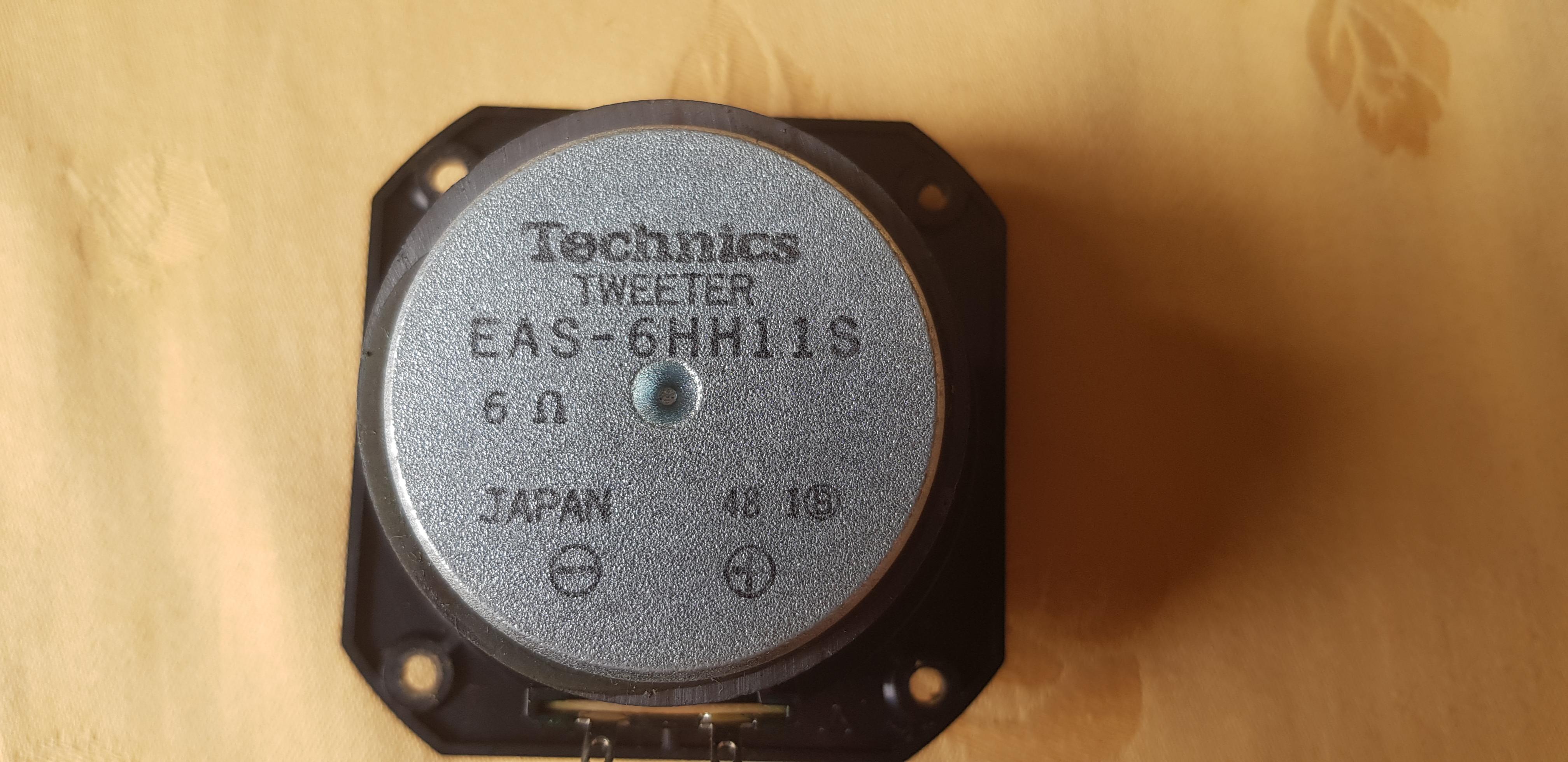

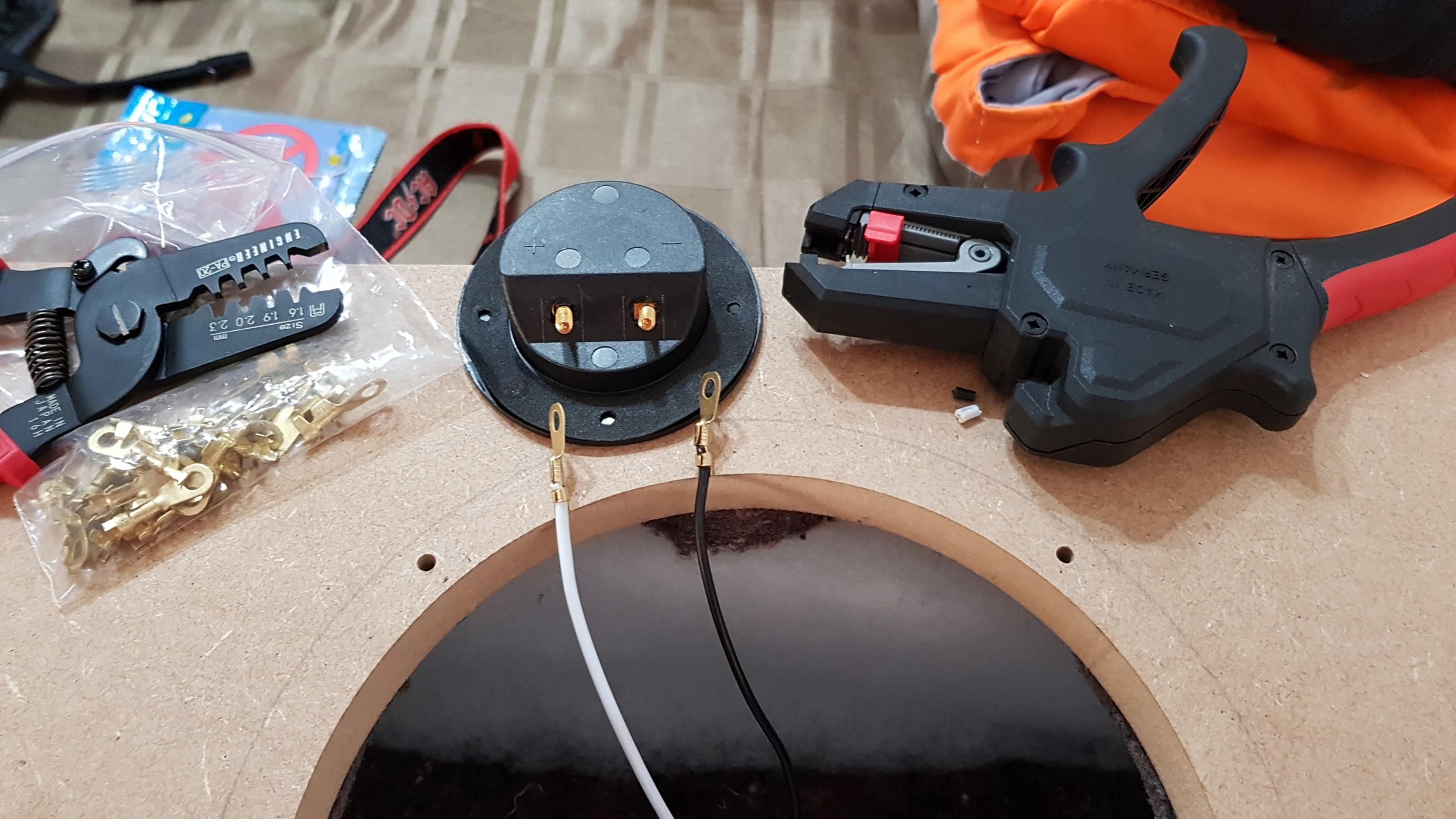

Hello,
I apologize for reviving this topic again. I have these Visaton W 200 S woofers now and Technics EAS-6HH11S horn tweeters, but I have trouble making the crossover for them. The boxes are 20 liters with bass reflex(140mm),made from 18mm MDF.I would be really grateful if you could help me🙂

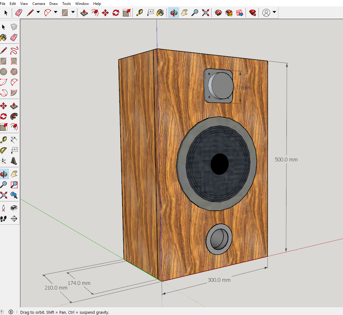

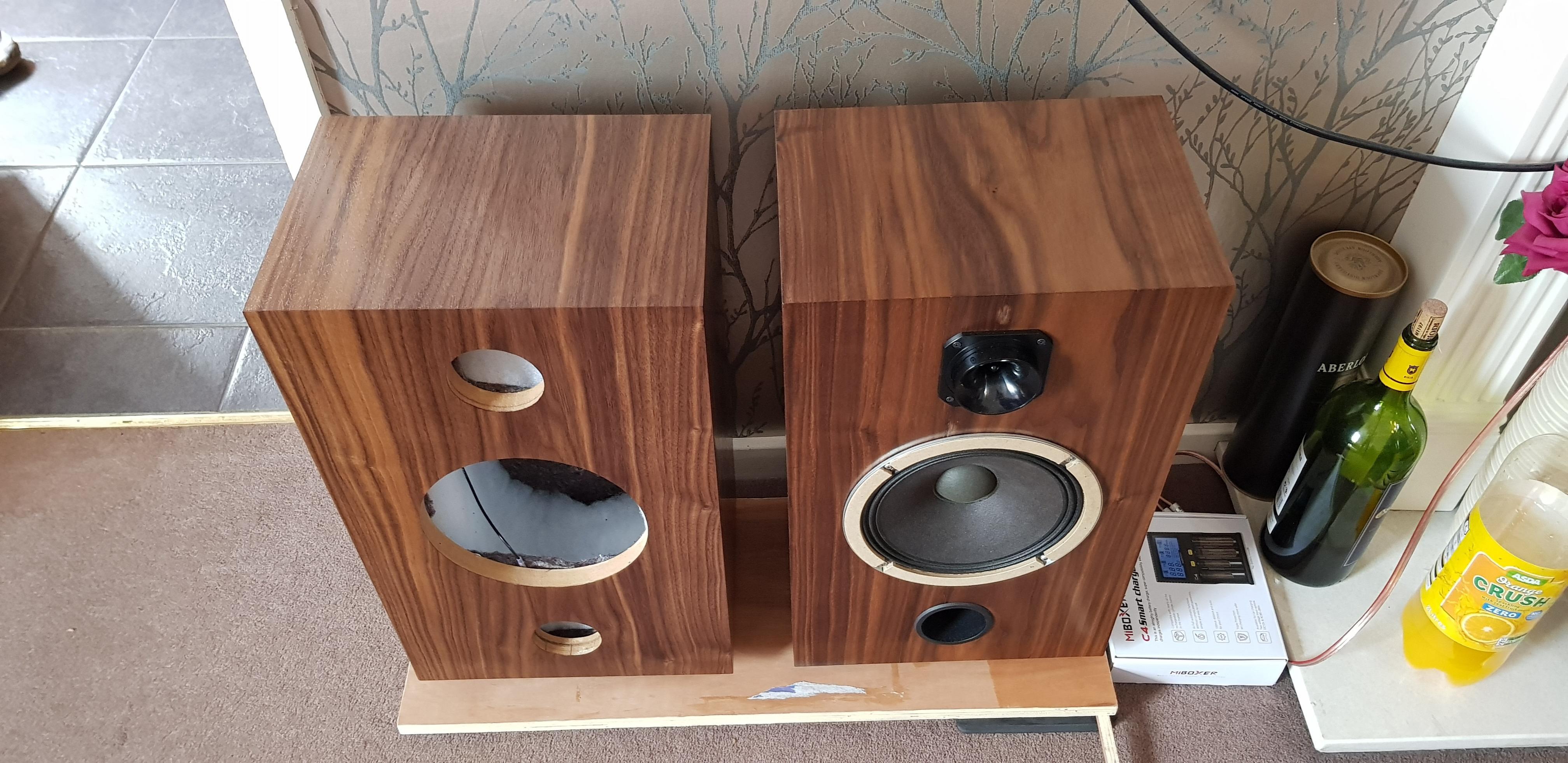

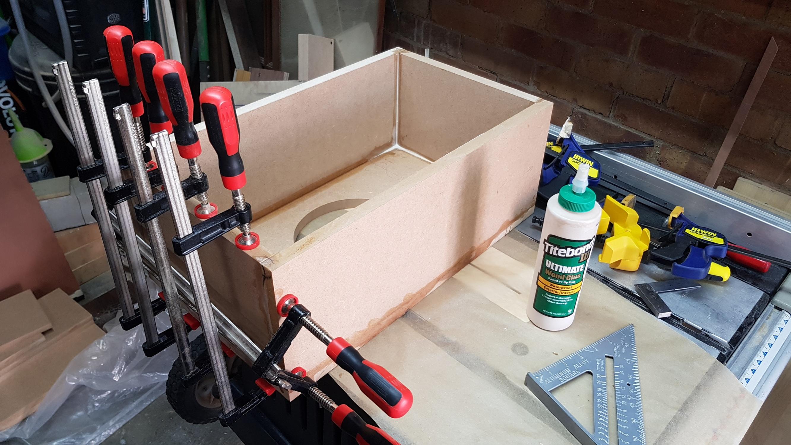

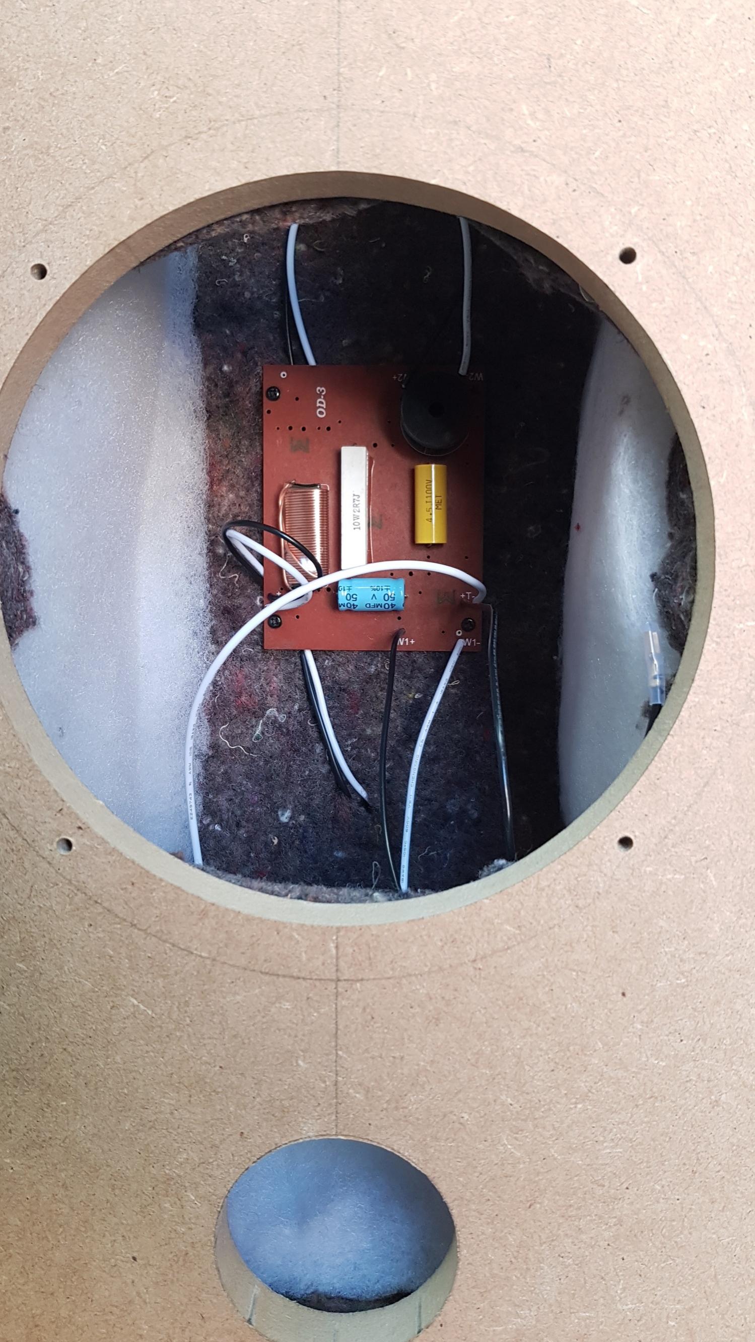

Boxes are done🙂I'm using other drivers with a purchased crossover at the moment, but they sound awful. I think they're midrange drivers, not woofers . That's why I ordered a Visaton w200s.I was able to find some info for the tweeter but it's 8ohm.Maybe I should by new tweeters?

All looks very good to me. You seem to know wher you are going on this.
The box looks about right for 20L reflex. The big vent looks just like the WLM La Scala which is the W200S-4 ohm unit IIRC:

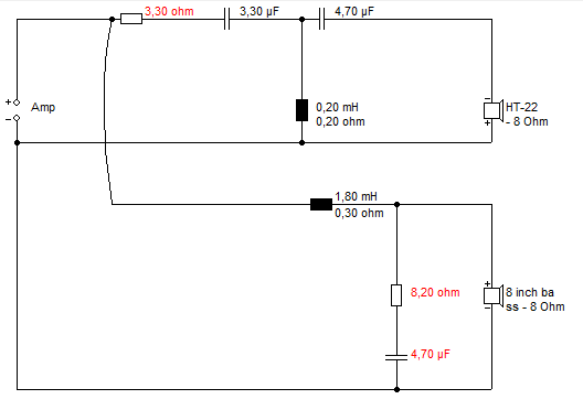

Thanks for the information Steve🙂I can do the boxes but designing a crossover is other story🙁 I like this Monacor HT-22/8 tweeter and this crossover should work for me as well🙂

I don't think you'll go far wrong with that circuit. You don't need any exotic components. That bass coil you have already might work well enough. 250V polypropylene capacitors. 10W ceramic resistors.
Cone tweeters are quite directional, and sound best on-axis, but have a sweet sound.
I don't know what Country you inhabit, so can't comment on availability. A 40W soldering iron and some lead-free solder are essential. Solder fast, get in and out in about 5 seconds having cleaned and scraped the contacts. If it's not working, let it cool and come back later, because plastic film capacitors don't like too much heat. Coils and resistors are tough as old boots.
