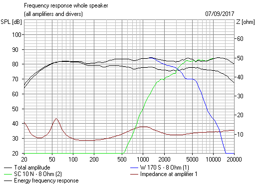

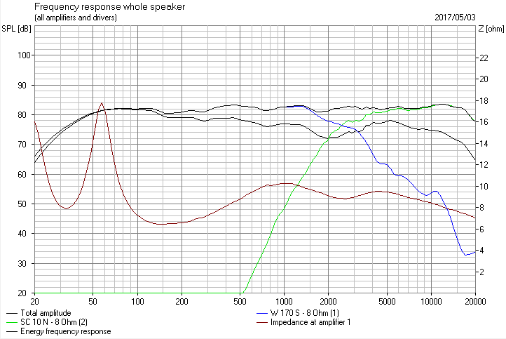

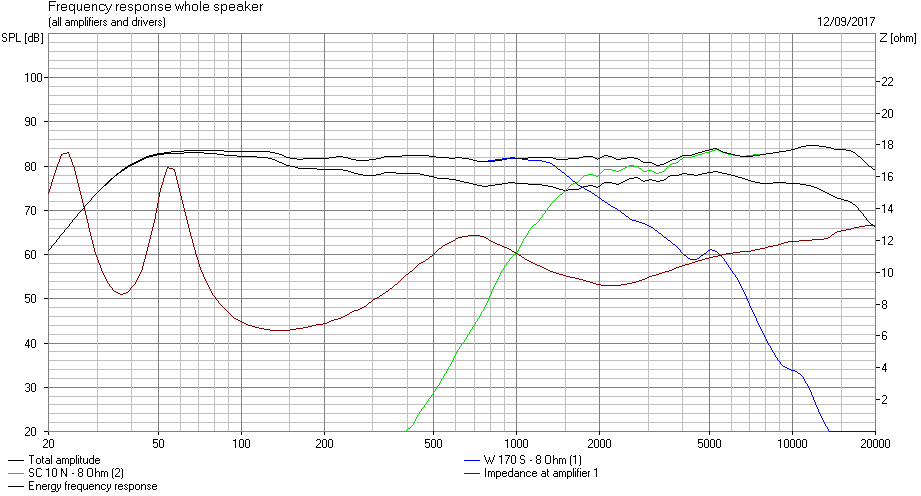

Hi Marc. I see this sound as just what these speakers do! A BBC style, albeit tending to phase-aligned LR2. There's a lot to like there.
The Visaton W170S-4 is an easier driver really, which can work off 1mH and 10uF, but do you want low impedance?
Lead guitar energy is mostly around 2kHz, and these 6" speakers have a dip in power response at that point. Off-axis. I don't think changing tweeters will affect that much. I have some Visaton DT94 mylar tweeters, and they are likeable enough:

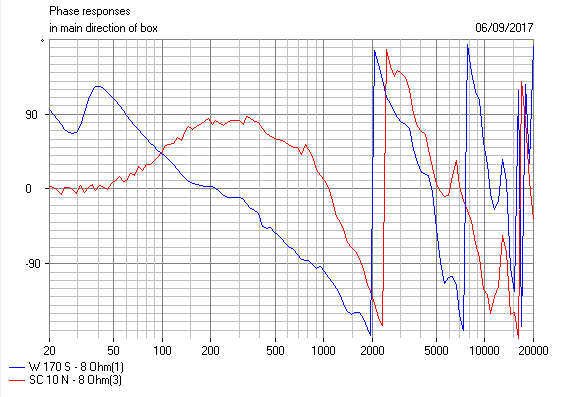

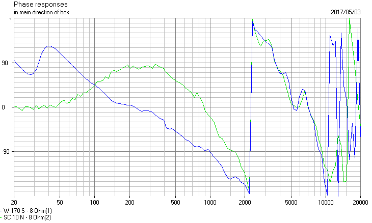

Maybe you could do a BW3 90 degree phase alignment and a bit of boost to both drivers at crossover. That would fix the power response. I don't know. It's another design! 🙂

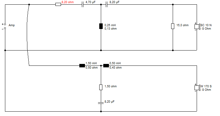

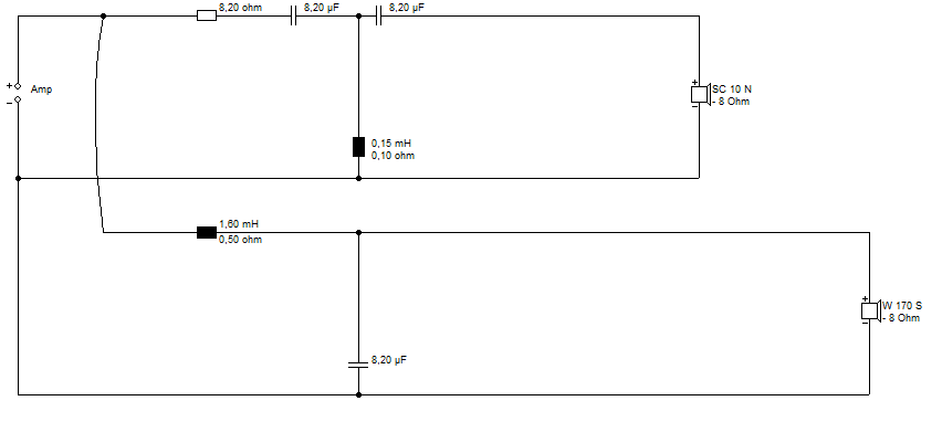

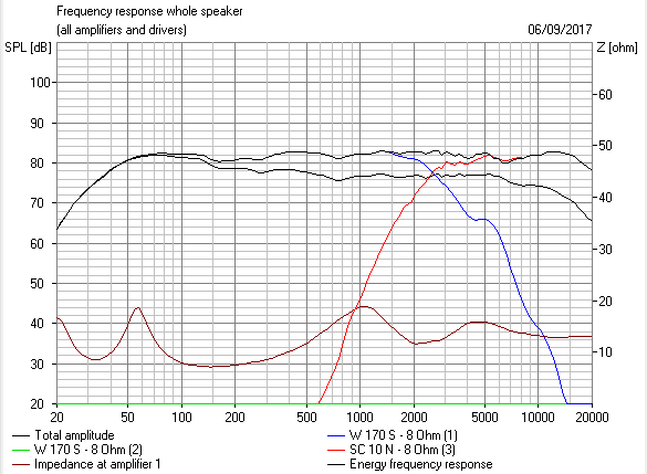

Ah, I've got a BW3 circuit for those drivers. Nearly 90 degree phase.
It's quite simple. Maybe you could fiddle with it more. The idea is it should look OK with either tweeter polarity.

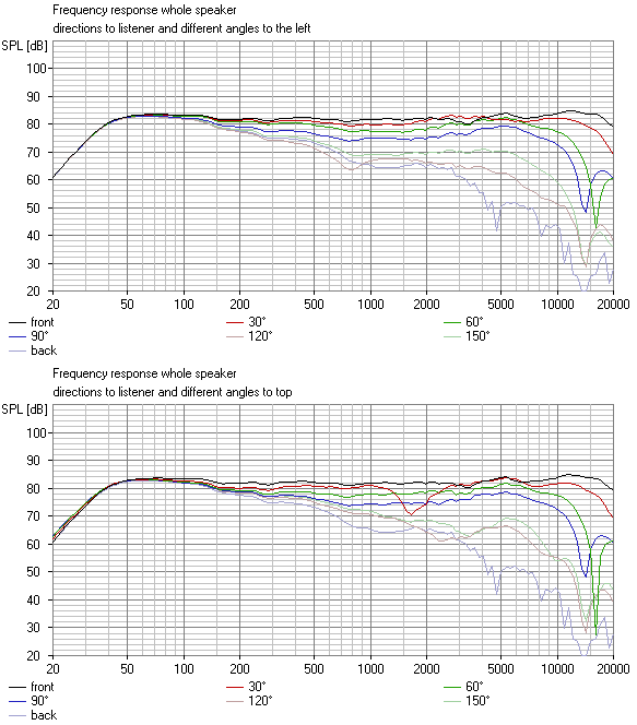

See, the thing is that there isn't much of a problem at all. I just find that when the tweeters are tasked with handling the high ringing notes of a slightly overdriven electric guitar (around that 2 kHz mark), they struggle with the other frequencies in the mix. With pure sine waves, they do perfectly. Because of this, I have done a lot of listening to the detail in the high frequencies, and I just feel the SC10Ns aren't quite as good as I can do. So the plan is to keep everything as is and drop in new, better quality tweeters.
I have found that the driver layout is fine when you move to either side of the speaker, but if you stand, the difference in response is noticeable. I believe the classic layout of a 2-way will be a little more flexible.
In other words, I want to change the layout, change the tweeter, and while I'm at it, try a simpler (and easier) crossover like what Lojzek posted. It doesn't hurt to experiment. What I really like is that I can use three component values: a 10uF, a 0.15mH and a 1.5mH. I also want to hear what putting less between the amplifier and drivers will do.
Still, all I'm trying to do is polish the diamond. These speakers are truly amazing. I gave them another in-depth test tonight, and the definition is fantastic, especially the mids and lows. I just feel they'll really pop with a better tweeter.

We've already mentioned that tweeter coil could be better aligned away from the bass coils. Crosstalk, an' all that.
I'm not overly fond of tank notches. Like the 1uF/6.8R jobbie. Bit of a last resort, IMO. I found that when they break up, they sound very harsh and metallic, and I don't fit them any more.

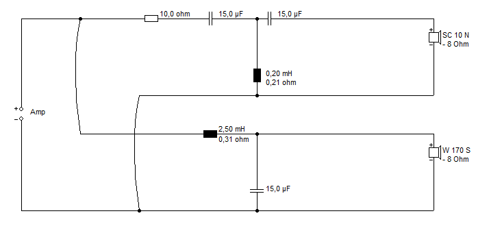

Lojzek's filter is something I've built myself in the past. I was never very happy with the tonal balance. With or without a 5kHz tank notch on the bass. But who knows?
But losing the notch might help. I also looked at some quick and dirty mods to your current circuit. The 15uF on the tweeter becomes optional. It's near BW3 with it, and near LR2 without. But it deals with cone breakup very well. The dotted line is your current circuit.
I was puzzling over this.

Marc, I would be cautious in diagnosing what the problem is here.
I don't think an offset tweeter is at all an issue. Many people feel it has better dispersion being asymettric: SEAS CURV
And this Troels Gravesen SEAS Curv design is phase-aligned. As is yours. Joachim Gerhard is not averse to offset either.
It is quite possible to put your hand over the tweeter and have a good listen to the midbass. I built a speaker that seemed to shriek a bit on certain female vocals, but I found the culprit was the midbass, which was a bit peaky. Easily fixed with more resistor damping.
It may be that it is the whole soft-dome principle that isn't winning a cigar here. I replaced a cheapie mylar Sony balanced tweeter with a Morel soft-dome. It just didn't disappear the way a good integrated setup should. I went back to the mylar.
Before spending big bucks, I'd try the simple things. I quite like that BW3 adjustment without the notch. You could possibly get near enough by borrowing a 4.7uF from the tweeter filter.

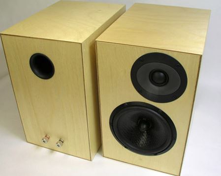

Here is a side note for a new post, so, on to the pressing current affairs.
The tweeter replacement is going to happen. It is decided, and there is nothing that will change my mind (except my wife, perhaps). Speaking of wives, the WAF of my large stand mount speakers appears to be quite low. I also wanted to experiment with a floor-stander. So I started a new enclosure build (I happily had all the wood for a nice pair of 42 L boxes). Half way through, my wife put her stamp of approval on - she actually likes how they look, let alone puts up with them. She doesn't like the speaker stands.
Anyway, I'm moving my entire speaker to this floor-stander, crossover and all. The baffle will be removable for now, and I'm going to tune the box to about 38 Hz. I will do the finishings when the correct tweeter is in, then it's going to be sealed off and shut for good.
It's going to be something like this:
I can change the layout of the baffle quite easily, if need be. 🙂

So the tower worked out extremely well. Better than I could have imagined.
However, they have exposed some things I'd like to change.
What I'm doing is stretching the woofers a bit too far. I don't think they work well beyond 1.5 kHz. What I mean by that is that they seem to not be well matched when heading into the non-linear region. It could be the crossovers.
So, I'm lowering the crossover frequency and getting a pair of Peerless XT25BG60-04 (those things that look like a nipple). I'm going with Lojzek's crossover suggestion - it's the best price-performance-simplicity ratio.

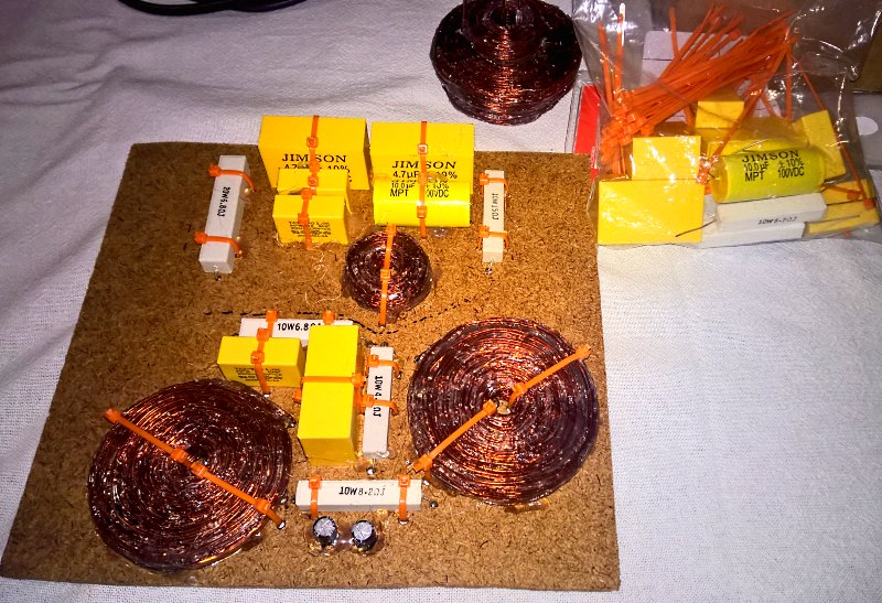

I decided to buy inductors this time, just to ensure the tolerances are small. I have attached the final simulations and crossover design. This is something that will only happen in January. At least it gives me time to tinker with my amplifier. I need to revisit the bias setting - in our current hot weather, the one fan comes on at idle (it must be near 35 C where the amplifier is). While this, I can finally get to wiring the amplifier properly, which is long overdue.
