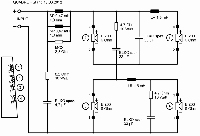

I got to think. To get some more dynamics...How about reproducing the quadro but...in open baffle. My question is would that need a radical re-design of the crossover? I'm really not knowledgeable on crossovers. But it strikes me that the crossover is fairly complex. (Schematic attached) Has this not been done because that could help sell crossover parts? Or am I being overly suspicious? 😀
I understand that no. 3 is the driver that remains wideband. While the others do the lower registers. Would a low pass filter for all three remaining drivers not suffice? I suppose the problem is then paralleling/serie-ing.
Any other comments on the quadro in general would be appreciated as well.
Me think to sell the speakers 🙄
What I see is that only two speakers are run fullrange,the 2 and 3 that are series connected; the 1 and 4 are series connected too...no, wait : the two pairs 1-2 and 3-4 are almost the same ( with parallel component crossover type) and then series connected ; this is done to have a reasonable power response , and to make the listener not confused by too many sound sources.
