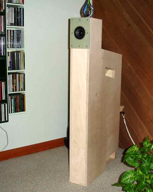

I have a pair here. They're OK for the price (and they're certainly built down to one). Something like an FF85K or Alpair 6 stamps on them from a very great height.
I like them. Decent efficiency, does well paired to woofers. I am listening to a pair now, backed up (each) by a pair of W130S 8ohm, XO at 300Hz, and I really like the sound.
I'd say you could get bass from them with an elaborate horn loading system, but adding a woofer means much greater SPL on offer. The treble isn't perfect either. It's pretty good, just lacking in presence. So, add some woofers, a super-tweeter and you might be better off finding something else, but if you're stuck with them, they're not bad for what they are. Visaton makes some good stuff. The basic FRS8 will do OB pretty well (Qts >1), but these are bigger motor, meaning mounting can be an issue - the magnet is 73mm dia, the cutout is 75mm diameter.
I find that, for general easy listening, they're good. They sound pretty realistic. Drums are very good, as are pianos. If you want to be picky, they need some kind of tweeter, and a woofer/horn system to get them at their best.

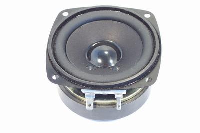

FRS 8 M 8 OHM
8 cm (3.3") HiFi fullrange speaker with high force factor and good sensitivity. Special developed for use in column-speakers and small bass-reflex cabinets, e.g. in miniature subwoofer / satellite systems.
Typical applications :
- Column speakers
- Mini hi-fi systems
Attributes :
- Moisturised cone
- Metal basket
Technical Data:Rated power30 WMaximum power50 WNominal impedance Z8 OhmFrequency response100–20000 HzMean sound pressure level88 dB (1 W/1 m)Angle of sound emmision147°/4000 HzMaximum cone displacement+/−2,5 mmResonance frequency fs125 HzMagnetic induction1,2 TMagnetic flux225 µWbHeight of front pole-plate3 mmVoice coil diameter20 mmHeight of winding4 mmCutout diameter75 mmNet weight0,5 kgD.C. resistance Rdc7,2 OhmMechanical Q factor Qms3,24Electrical Q factor Qes0,58Total Q factor Qts0,49Equivalent volume Vas1,1 lEffective piston area Sd29 cm²Dynamically moved mass Mms1,8 gForce factor Bxl4,0 TmInductance of the voice coil L0,3 mHHeat resistance−25 ... 70 °C

The surround feels like foamed rubber - it's too smooth and frictionless to be rubber.

I really would spend the extra on the Alpair 6 or FF85K. The Visaton is good for the price, but it's still a £10 driver.
Thanks HM for the great picture.

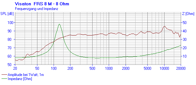

owenhamburg,
do you see the measurements on my HP,
the electric power has nothing to do with the
mechanic power.

[URL="http://http://www.hm-moreart.de/89.htm"]FRS8M measurements[/URL]
No I didn't read your measurements on the FRS8M in your budget Horn , but now I have read them they are very interesting. Thats quiet a system for a low cost.

owenhamburg, do you see the measurements on my HP,
I testet both FF85 and FRS8M, fullrange with good sound only ~92 dB max, the best 3" was for me the omnes Audio

The 30W thermal rating is no indicator of max SPL. They go into cone break-up much earlier, suggesting some kind of cone treatment would be of use.
