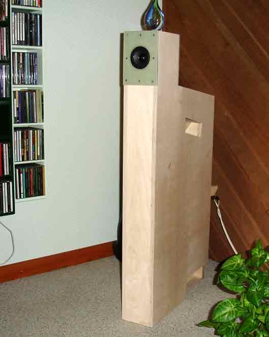

Hallo,
i made good experience with the FRS8M
in my Trombone horn,
best imp, bass down 35 Hz, for max.
SPL of~94 dB.
It is a bipol double horn you need two driver each Horn.

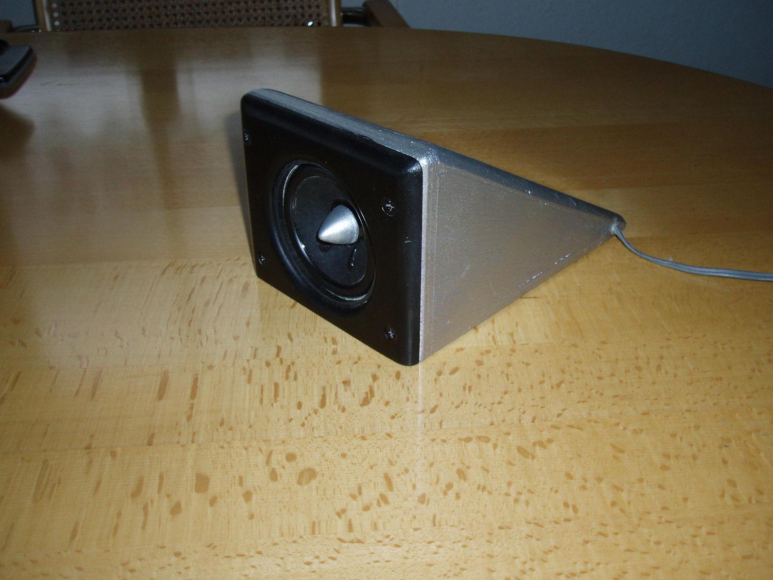

I think, the SPL difference ( if excursion would be the same...) cannot be explained by the stronger magnet.. When you compare it with e.g. 3"Fostex, it becomes obvious that there is something wrong in the Visaton papers ( as per lin. excursion ).....
Well, I already made some mods on my FRS8M car speakers. ( just for the looks 😀 ) Maybe try your coating as well...
The suspension is also a lot softer. This means a lighter cone can be used to get a similar resonance. In total, this would bring the efficiency up, but the lower Qts means the response has begun to fall by 200Hz.
Good luck with the mods, they already look great!
