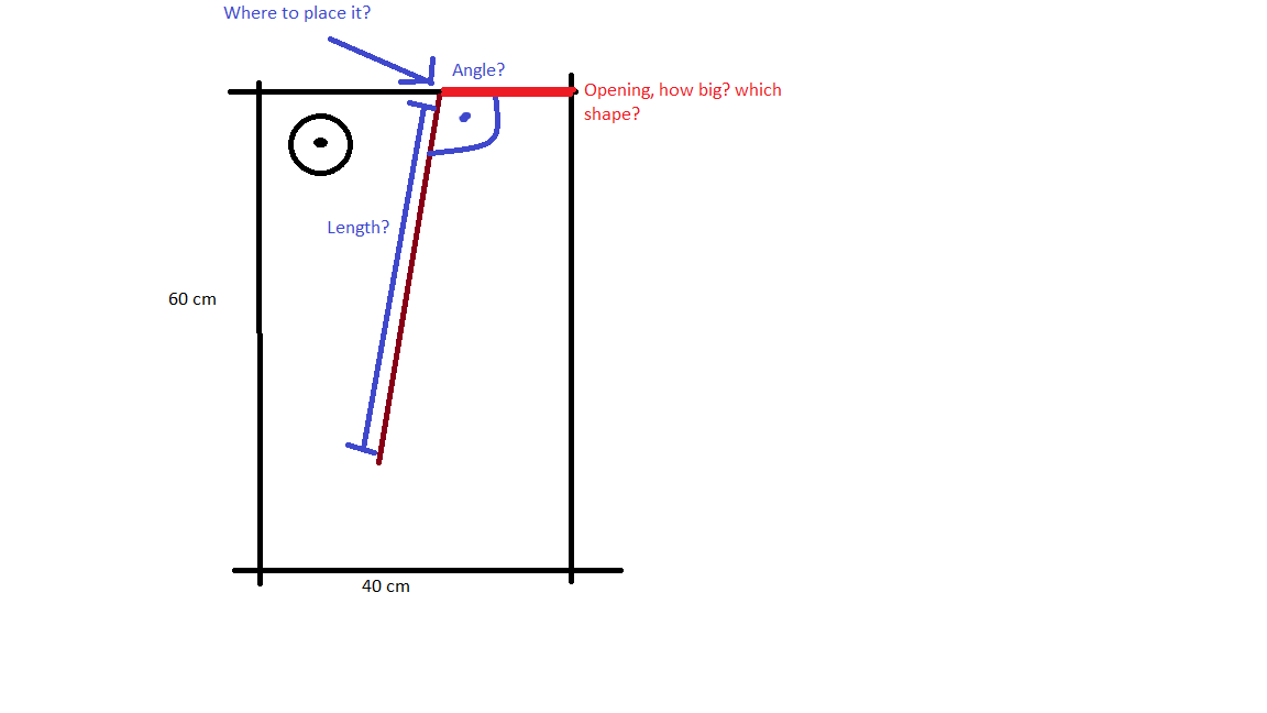

I have two FRS8 flying around and have also just found out about the fantastic Foamcore board possibilities, so I decided to give it a try with a wall mounted, very flat transmission line speaker.
The highth and width of the speaker shall be Din A 2, which means 42x60cm.
The depth of the speaker can be choosen, but should not exceed 10 cm, in general, the smaller the depth, the better for the wall mounting purpose.
The concept should be a transmission line system with a tuning at around 64 hz, and now my big question is, how shall I calculate it. I want to build a single folded design, so in general, there are three questions open:
1. Where to place the seperation wall, how long shall it be and in which angle?
2. How big shall the opening of the tube be? Does only the cm2 matter, or also the shape of it?
3. My idea was to place the driver in the upper left corner of the box. Is this a good idea?

Attached to this, you can find a most beautiful drawing of the ruff idea of the project.

Use Hornresp's Loudspeaker Wizard to find the desired length, parabolic taper to get a terminus [exit] that's at least Sd*0.5 to fit your dimensions [if possible], then in the 'schematic' window, click on 'file', then use the 'export horn data' tool to choose a rectangular horn where it will allow you to select the desired width or depth to recalculate the dimensions and in your case a 'uni' width flare to export to .txt file.

You can take the TS parameters and put them in Godzilla's BIB calculator spreadsheet. Then flatten the design and make a FIB (Flat BIB). Here is an example of one I did with TC9.
http://www.diyaudio.com/forums/full...e-fostex-craft-handbooks-514.html#post3342958
I ended up bifurcating it but still following basic BIB cross sectional area and length.

Schlumpfpeter's design would work if the base of the box was triangular; this to obtain same area in the knee (bent) and to do the tapering correctly.
Exit ( terminus in TL terminology....!?!? ) would then happen to be a hole same diam. as the speaker.

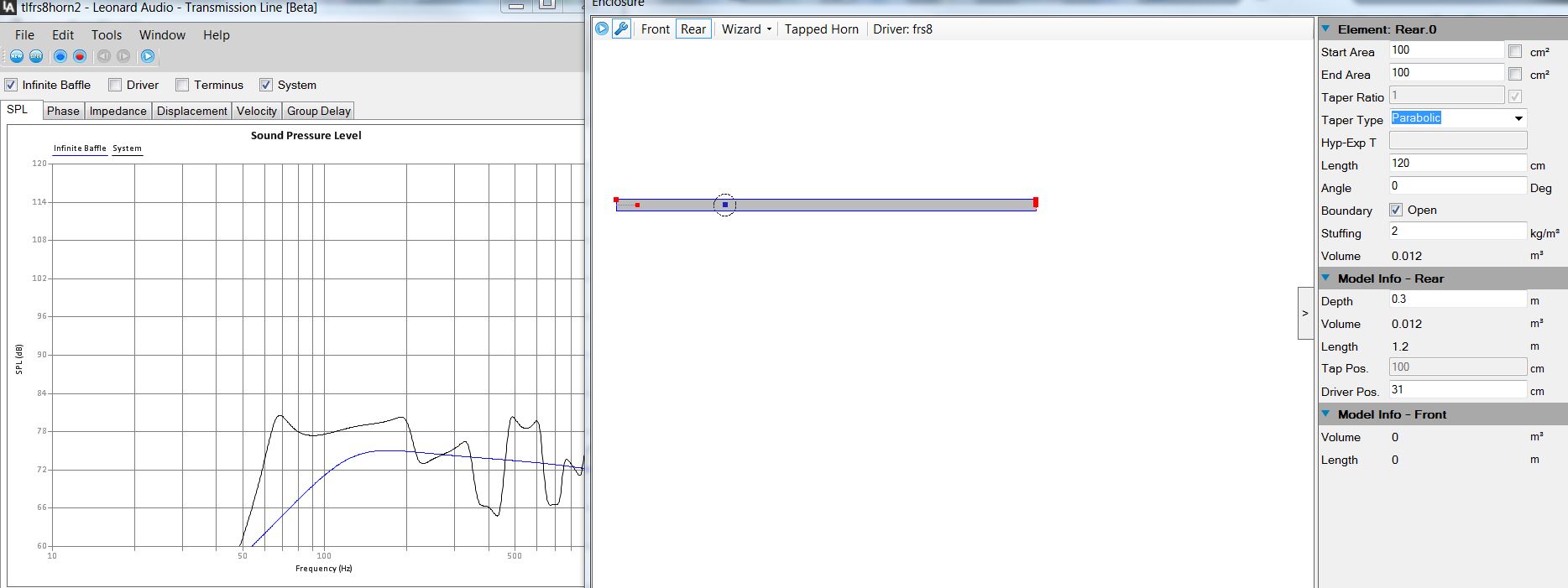

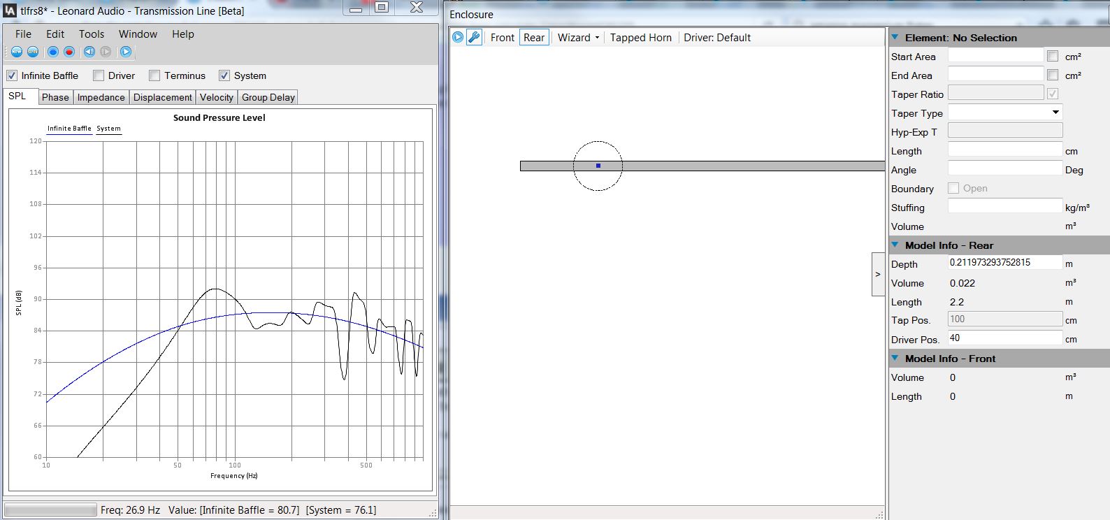

Ok, I think I got it now.
I attached a screenshot of my model. I think it could work out quite well, but I would apreciate if someone could give it a quick look, just to see if I made an obvious major mistake.
Cheers!
Am I right with the assumption that the graph on the left just shows the output of the rear end of the transmission line and is not including the midrange and highs which are directed straight from the front of the speaker?

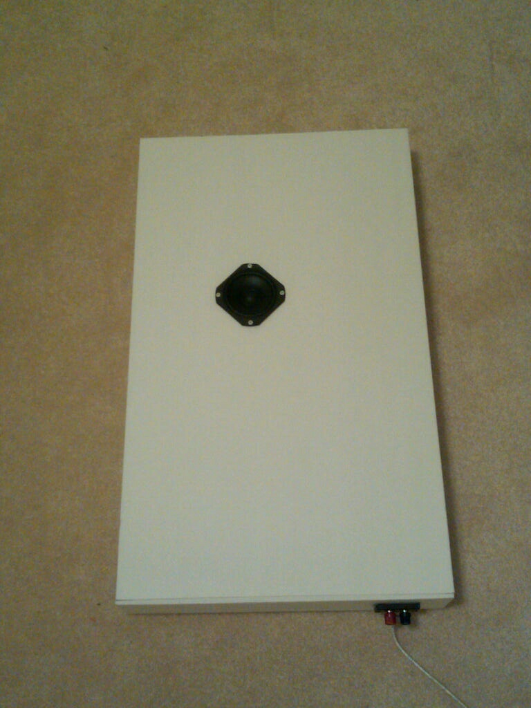

I have finally found the best solution for my Speaker, it is a single folded straight transmission line design. I wanted to tune it to around 65 Hz and and the length of a 120cm long straight pipe almost matches this to the spot.
I already got the foamcore board for one box, the other foamcore board will arrive shortly :)
The design is dead simple with a Din A 2 foamcore board, as it is only a single folded design with a straight pipe. The depth of the speaker will be 5 cm, so really a flat wall speaker.

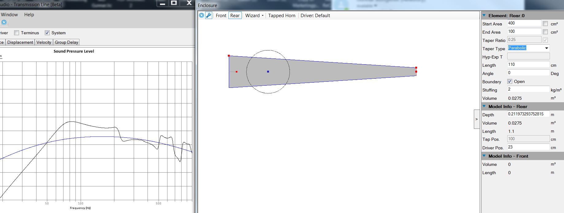

I also considered a double folded BIB design, but for the ease of building, I ended up with the following straight TL design:
You can see a screenshot of the design below:

Hmm, the tapered one looks pretty good, the straight ones not so much. Typically, by the time all the ripple is adequately damped there's little/no real [mid]bass left when tuning almost an octave below Fs. I don't remember if this software calculates Xmax limited power handling or not, but neither will there be any to speak of unless a BIB with vent is used since it takes a lot of acoustic power to offset the lack of a large Xmax.
Anyway, foam core is cheap and for all I know 1-2 W maybe all you need, so let us know how well it works in your app.
