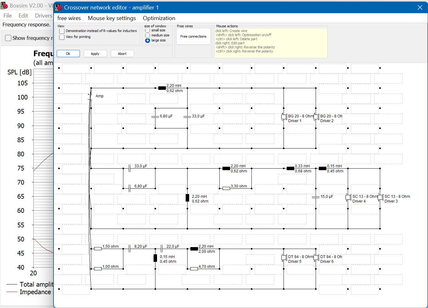

Hello, I have plan to build pair of speaker boxes and my priority was that speaker need to be efficient, so I made plan in Boxsim with 2x Visaton BG20, 2x Visaton SC13 and 2x Visaton DT94. Can that Visaton BG20 handle bass frequencies as I will not power them by amp which is more than about 30w? Also box I putted in Boxsim is 72 liters bass-reflex.

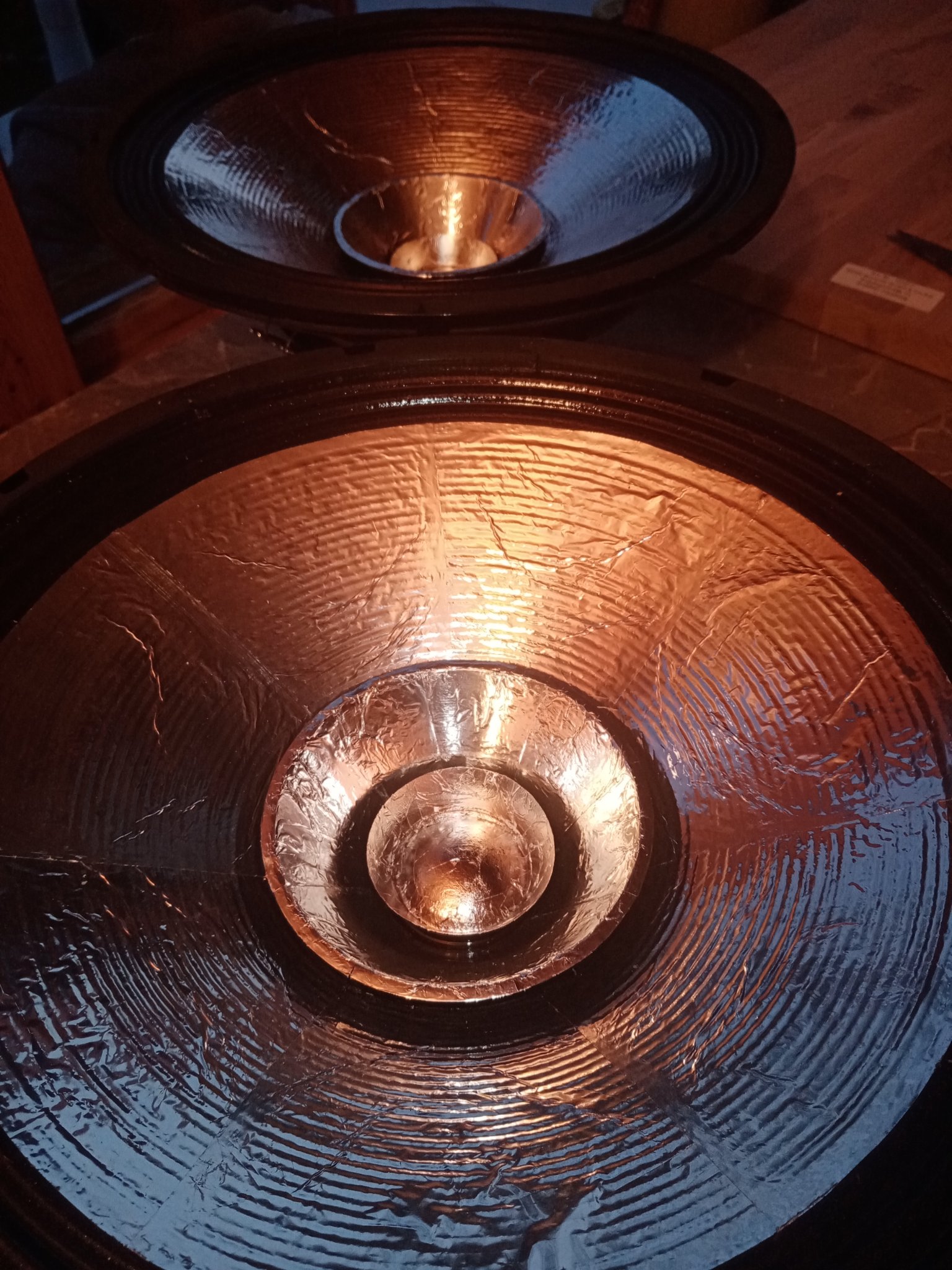

I modified one to a sandwich cone
https://www.diyaudio.com/community/...loudspeaker-sandwich-cone.402917/post-7467924
Awefully small for a reflex with 1 BG20, let alone 2. Well damped about 60 litres per driver sealed, 100+ litres per driver vented/driver.
I’d listen to one FR by itself before i did anything else.

I'm not a Boxsim user, but won't the Max SPL tab show you the output vs. frequency at driver Xmax or your power limit (whichever is limiting)?
Does it really has to be that Visaton BG20?
Because these days I would rather recommend the SB Acoustics SB20FRPC30-8 as a 8 inch full-range.
But to answer your question.
Yes, you can use these in a bassreflex cabinet.
It only needs a pretty large cabinet (around 80-100 minimum) and the xmax is extremely limited (just 2mm).
So you very quickly will reach that cone excursion limit. (about 2-3W actually)
