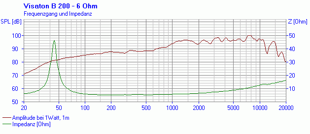

... B200 ... as it is a 96dB driver
Factory specs are optimistic. Early pairs i've had measured just over 91, the last pair i had thru here were just under 89.
dave
Dave,
Did you look at Visaton's specs and curves?
Look at their website, see that the curve reaches 96dB at some 1500Hz (88dB at 200Hz), and when your German is not up-to-date, they speak of "midrange sound pressure level" of 96dB (mittlerer Schalldruckpegel).
You are a loudspeaker man, and you seem to have commercial interest in a competing product when I am right; may I suggest to check things before suggesting that the B200 does not deliver what Visaton claims?

That's pure nonsense! "Mittlerer Schaldruckpegel" means "Average sound pressure level" and has NOTHING to do with the mids!
As always, you are right Dave. There were measurements in German forums stating only 88-89dB for the ASPL (mittlerer Schaldruckpegel) & some nasty HF drop off in the frequency range, many B200 stopping at 10kHz. So in reality Visaton fails to deliver the claimed specs again and again.

I do have commercial interests, but the reason i can report measured data (and that is all i am doing) on the B200 is because they are one of the drivers i sell modifed. Once the rising FR is flattened out and DDR improved they are a very nice driver.
dave
dave
From the Visaton curves some 90dB seems plausible when flattened out, which correlates with your findings.
It does not seem right to me when the B200 is presented as a driver not meeting its specifications; it's all in the curves.
The claim of 96dB can't be upheld by any means - end of discussion.

Horn Tube,
You are right: mittlerer = average.
Look at the frequency curve of the B200, from their website.
There is clearly a rising response; when we take 90 dB (at 200 Hz) as a start even reaching 100dB.
Above 10 kHz the response drops, it is some 10 dB lower at 20 kHz.
So it does not seem too difficult to conclude that we deal with a 90 dB or so loudspeaker when flattened out, and I don't agree with the "false claims".
I have seen socalled full range units which looked worse.

You are trying to manipulate the reality here or maybe you do not know what ASPL means. The B200 has NOT an ASPL of 96dB WITHOUT correction, with correction you land somewhere at 87dB in th ereal world. Even the manipulated Visaton freq.resp. does not add up to 96dB ASPL.
The claim of 96dB by Visaton is pure wrong, false, untrue like the photos of the non-existing manufacturing line on their website.
