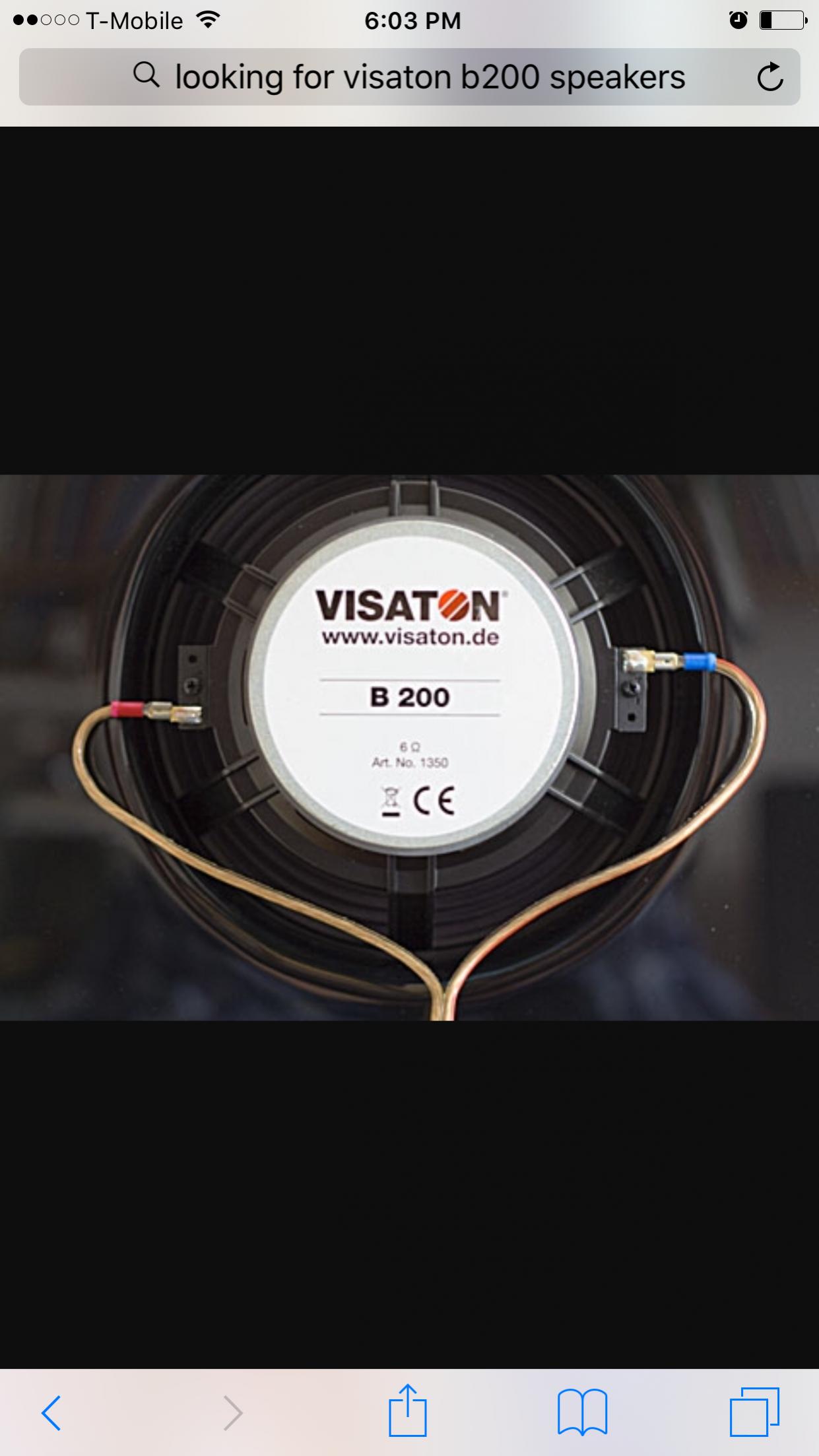

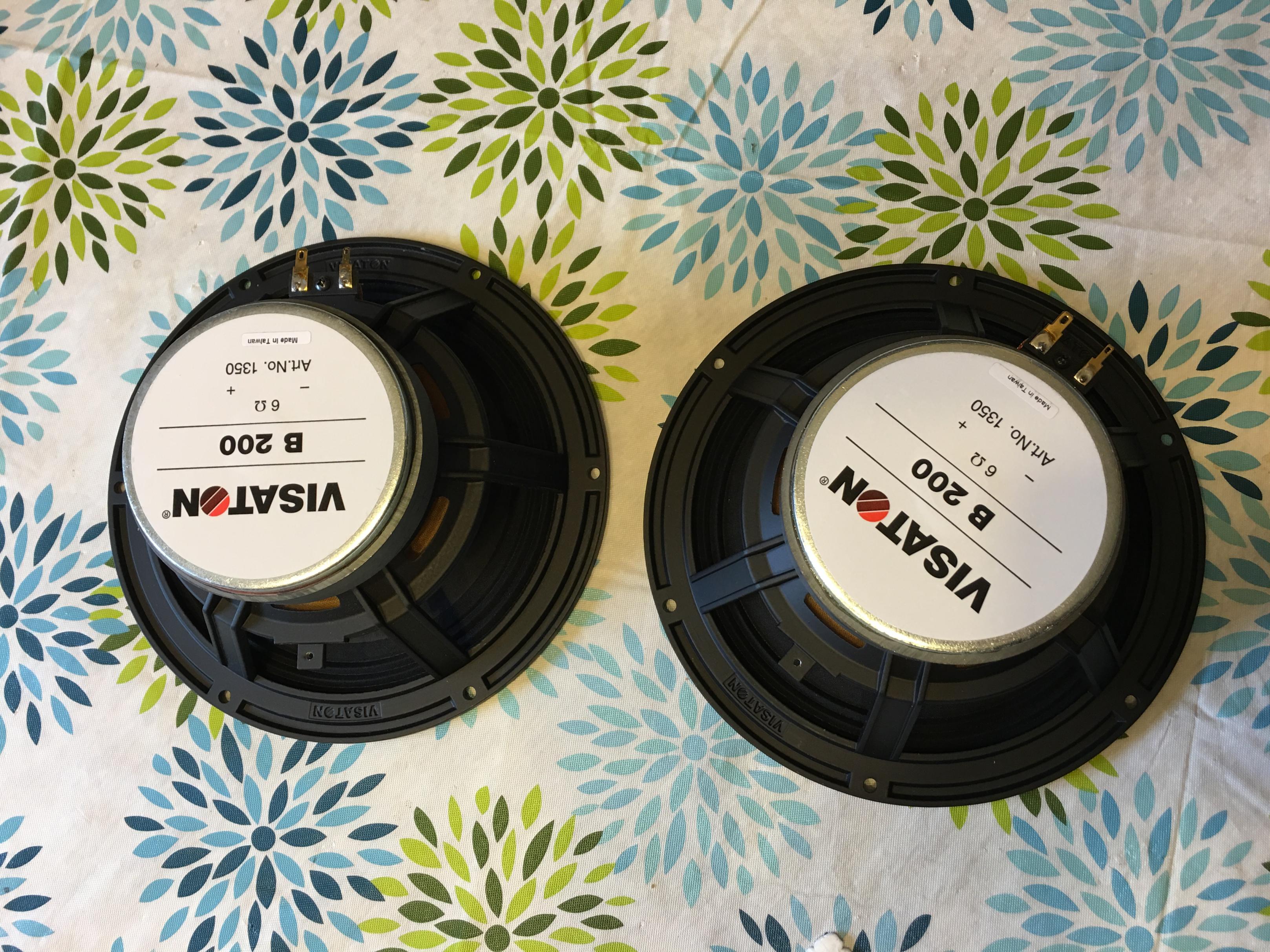

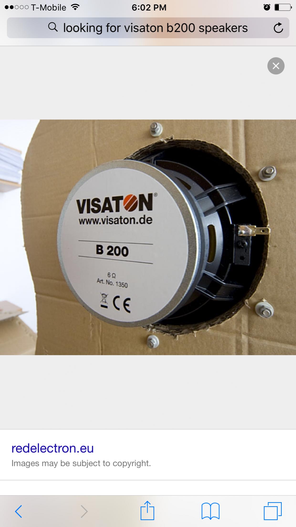

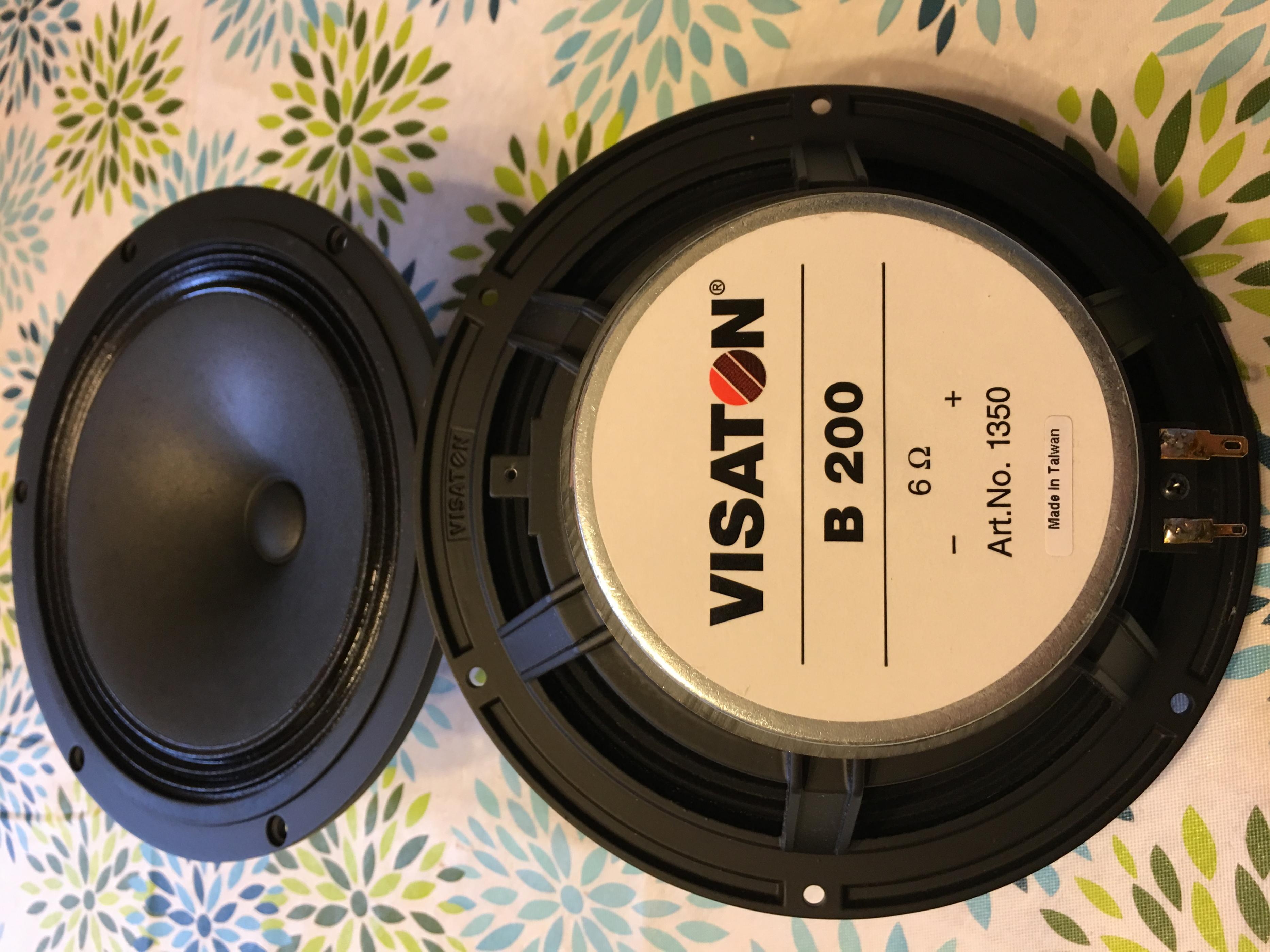

So I got a pair of Visaton B200 for a gift from a friend. I have been looking on the Internet at projects and I notice that there are a few Differences between mine and the ones I see on the Internet?
1. The hook up post are next to each other on my speakers ( but on the ones I see on the Internet have one hook up post per opposite side's of the speaker?
2. Under the name Visaton it gives the web address on other drivers but on mine no web address?
3. It has a little sticker towards the bottom that says made in Taiwan but the ones on the Internet nothing? Where it's made ?
4. There are a few symbols on the ones on the Internet but on mine nothing?
I am just asking because I notice this? Could they be knock offs? I just don't want my friend wasting his money over false advertised products? Maybe someone has a fresh new pair so I can compare them to the ones I got? Jeff
I will post a side by side picture if I can figure it out? Jeff
Heres a few photos I took off the internet. Jeff

Look genuine to me 🙂

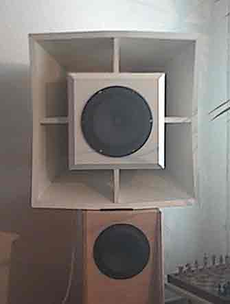

I used mine in the Visaton Solo100 design and loved them. Costs a fair bit in inductors though but effectively turns them into a large floorstander that seemed to sound great with everything. Bass response was surprisingly good, easily down to 40hz and went rather loud without issue. Really wish I had kept them.
The equalisation network the Solo 100 design uses meant pretty good on axis treble(no tweeter needed) BUT they beam pretty hard so you end up with a fairly small sweet spot. There was no shout at all and no real bass boom(you can tweak the internal resonator with damping material)
Very good driver, probably best used in my opinion with a decent high efficiency large bass driver(PA driver) and a good efficient waveguide type tweeter driven actively.
