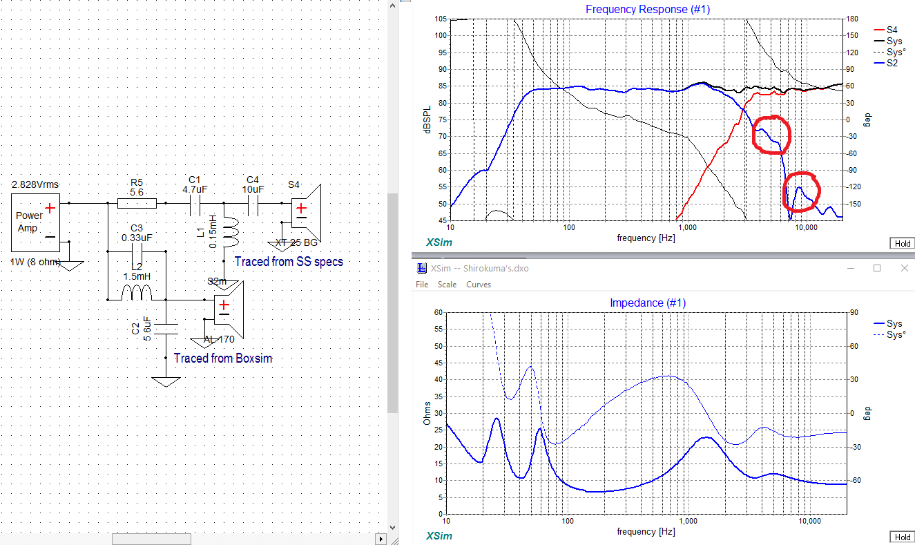

Indeed, now that you mention it, I thought it strange there was such a big difference between the BG and TG version. My spec sheet (from the store) claimed 589Hz. Lojzek, you rule! (I know that statement is a bit not done between grown ups, but with so much ruling going on here, I couldn't resist.)
If I change the specs in boxsim, and use the suggested Hp 3rd order, combined with the 22Ohm on the woofer, it all starts to look promising.... Although I now -albeit small- get a bump @2600Hz
And on another note: the filter used for the AL170 is a very flat filter (looks like 6dB) that might cause a lot of cancellation when used with an improper tweeter network.
You might have to try other filter toplologies... just changing the tweeter Offset in BoxSim has a pretty wild influence on the "summing". Or the lack of... 😛
I suspect you can get bogged down in worrying about the approx 600Hz Fs resonance of the undamped non-ferrofluid XT25 tweeter.
It traditionally benefits from some shunt resistance. Maybe 10R.

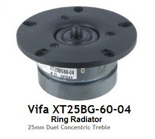

On theoretical grounds, I approve of ring radiators like the XT25.

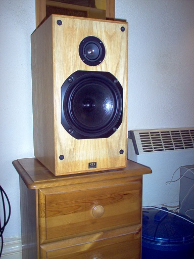

There's another way to get to the same place, IMO. You can model the tweeter like the cone Visaton TW70. But the 92mm Monacor HT22/8 is hugely similar.
MONACOR - HT-22/8
This style of speaker gets very little love in the modern World. But I like it. It needs a 3rd or 4th order tweeter filter around 3kHz to sound good. Which is an improvement on the daft 1st order (single capacitor) filters people used years back.

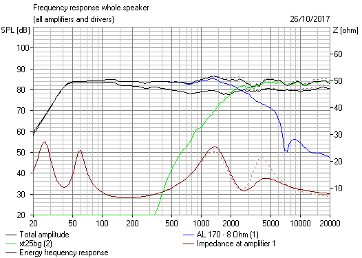

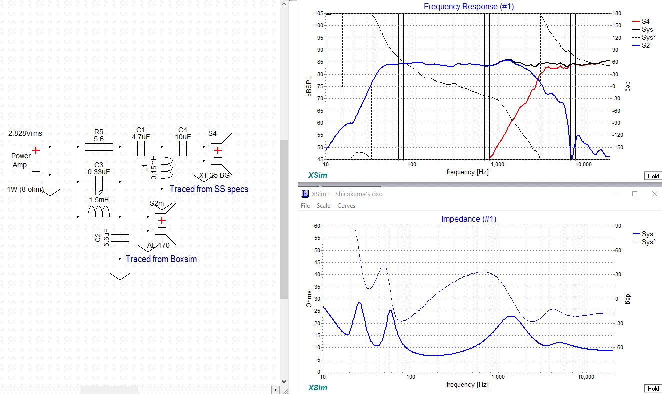

Shirokuma, I ran your .BPJ file in Boxsim. The one in the first post.
It doesn't have any FRD or ZMA files!
I only have some Tymphany XT25SC-30 files from Zaph IIRC. This tweeter is 3dB quieter than the double magnet XT25BG-60. I am prone to making mistakes when importing files, because their is a lot to do. But I certainly found your original filter was too quiet on tweeter. I assumed the XT25SC-30 files were the right shape, so just added 3dB and enabled use frequency response and use phase response on the driver page.
Lojzek's works much better on level. Slightly peaky on impedance, the dotted line, and I preferred series 3R (or 2.7 0r 3.3 is very similar) before and after his 4.7uF/0.33mH/8.2uf filter. The solid line. Because these are 3 ohm tweeters and the 3R takes them up to 6 ohms..

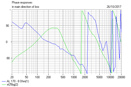

BTW, this is interesting, but may be simply an artifact of how the file was created, but the phase for the ring-radiator XT25 has none of the s-shaped kinks and resonances you get with most tweeters, which indicate stored energy.
Group delay is the rate of change of phase with frequency IIRC. So if it's straight, it should sound very clean.

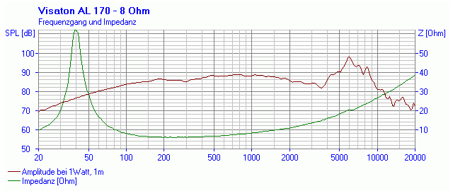

I'm more interested in measurements..Okay, I'm interested too what will it sound like once it's all set up.
If Al170 have these two peaks which is predicted in sim, sound can't be good..
Aluminium midbas drivers must have 3rd or 4th order xover..

vulejov is right up to a point. 3rd or 4th order with impedance correction is one way to do things. With massive complex choral and orchestral pieces involving 150 performers, we prefer the low-distortion route. With light and spectrally undense stuff like a Jazz combo of 4 people, we might enjoy low order crossovers.
IMO, there is a lot to like about ring-radiator tweeters. And a lot to like about metal drivers. But some compromises involved in both. My own feeling, since we are all trying to get somewhere fast before mortal death intervenes, is we should just tell people what we did and how it worked out.

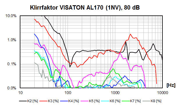

Measured Al170 THD..I love the way they sound.
Like this..vulejov is right up to a point. 3rd or 4th order with impedance correction is one way to do things..

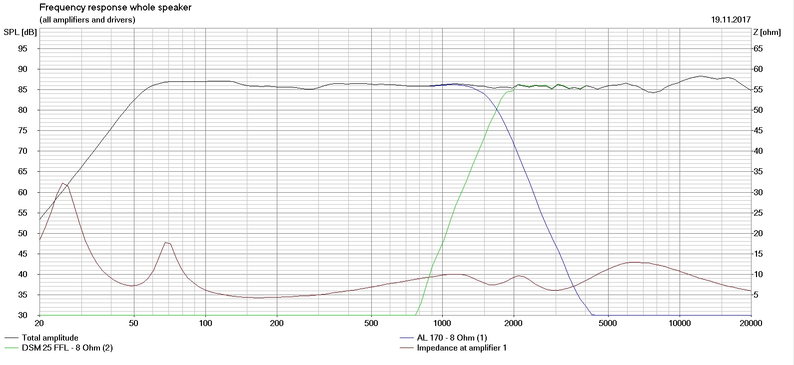

Vulejov, Your dsm25ffl build is also quite interesting, Especially since I have one lying around here.... Have you built it already?
No, this is only simulation..Vulejov, Your dsm25ffl build is also quite interesting, Especially since I have one lying around here.... Have you built it already?
I used AL170 as woofer, 400-500Hz xover.. there are better and cheaper 6-7' drivers for midbas..
