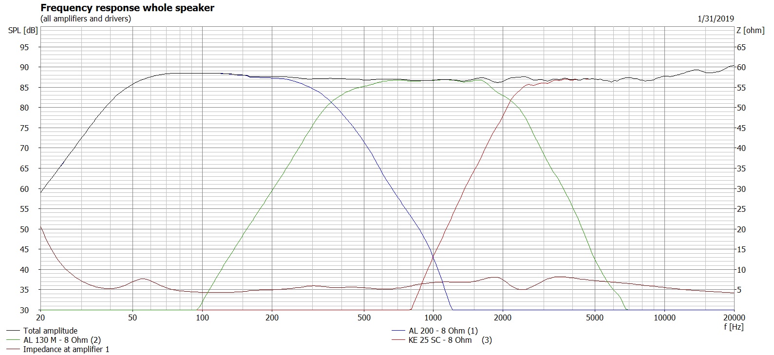

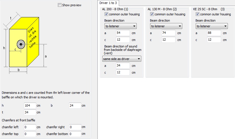

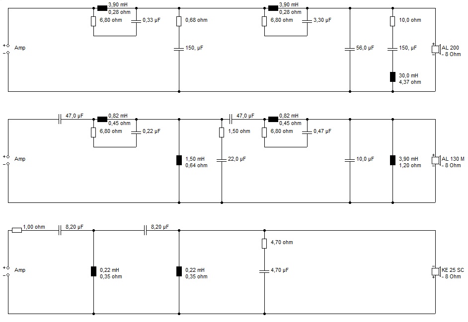

Right way to use AL200 can be something like this..
