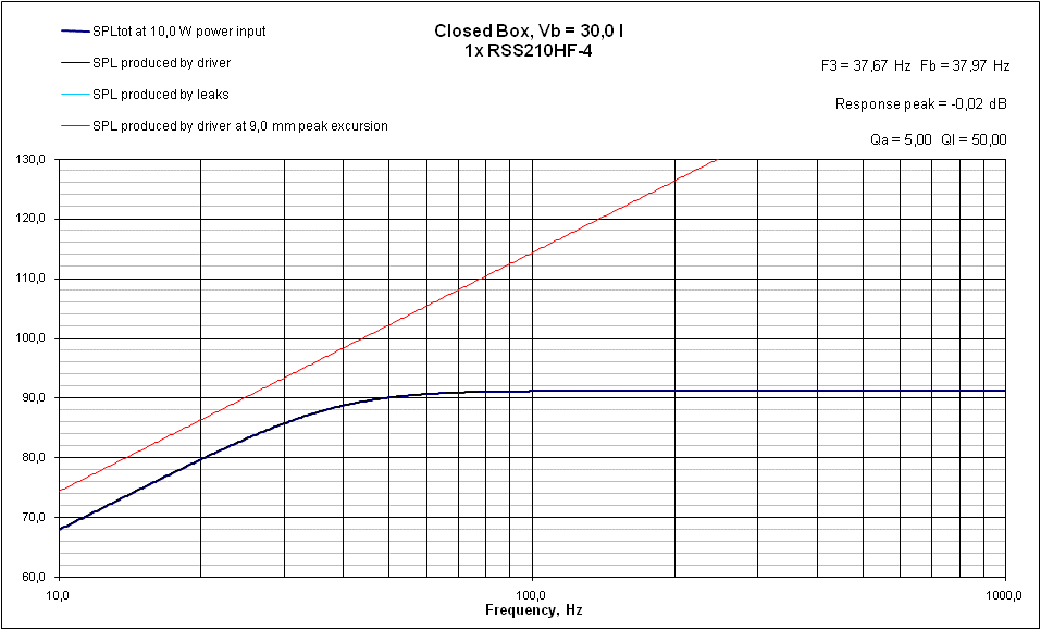

Hi, do prefer sealed enclosures, my room is db Gainer so no need bassreflex.....
Passive xover only, max net box volume 1-1.2 cu ft (30-35liter)
F3 40-45 will be enough for my listening raste od music (rock,metal,jazz sometimes)
AL200 wouldnt do that as I can see tech.specs....

Dayton Audio RSS210HF-4 does all of that.
