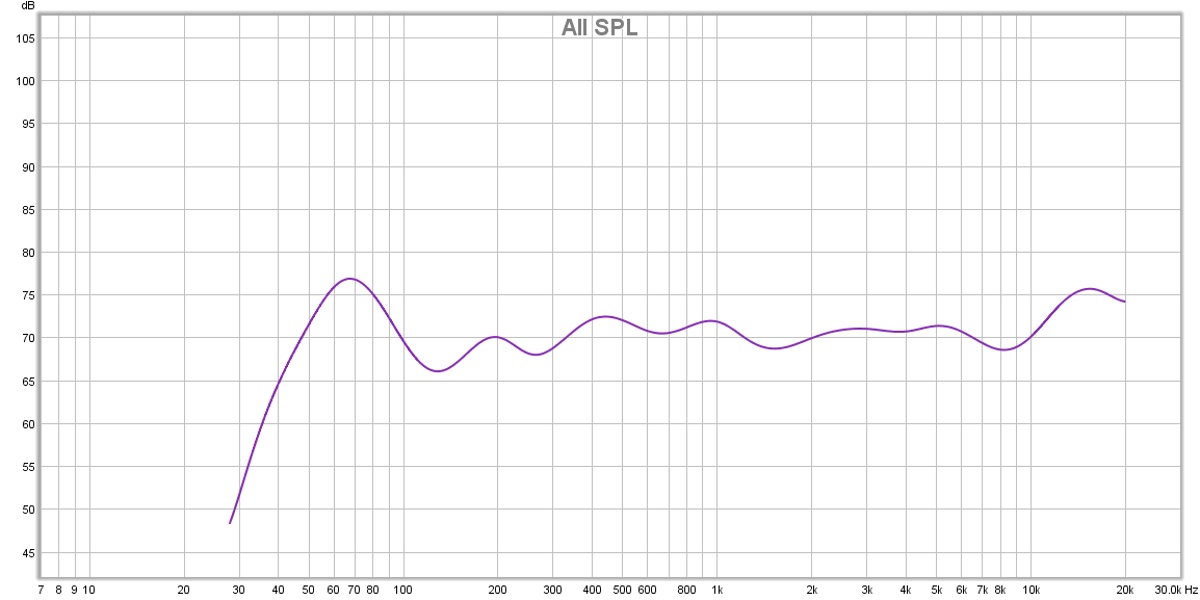

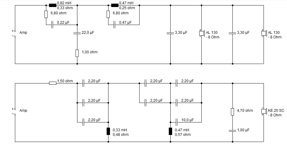

Visaton 2xAL130_KE25SC

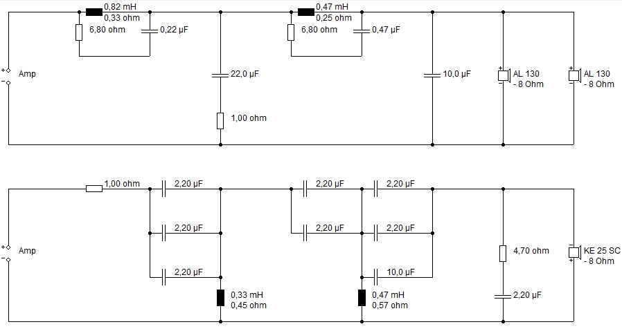

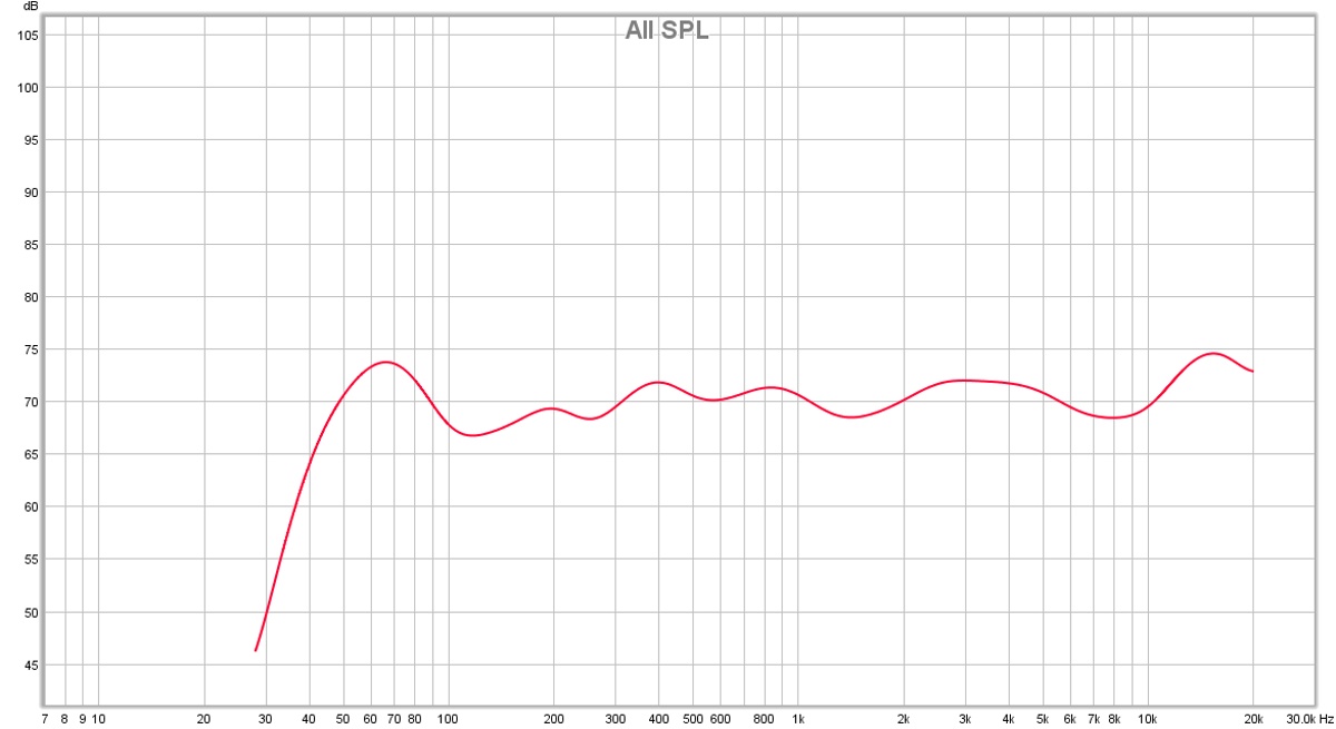

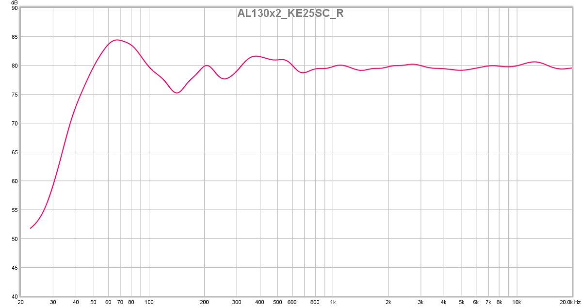

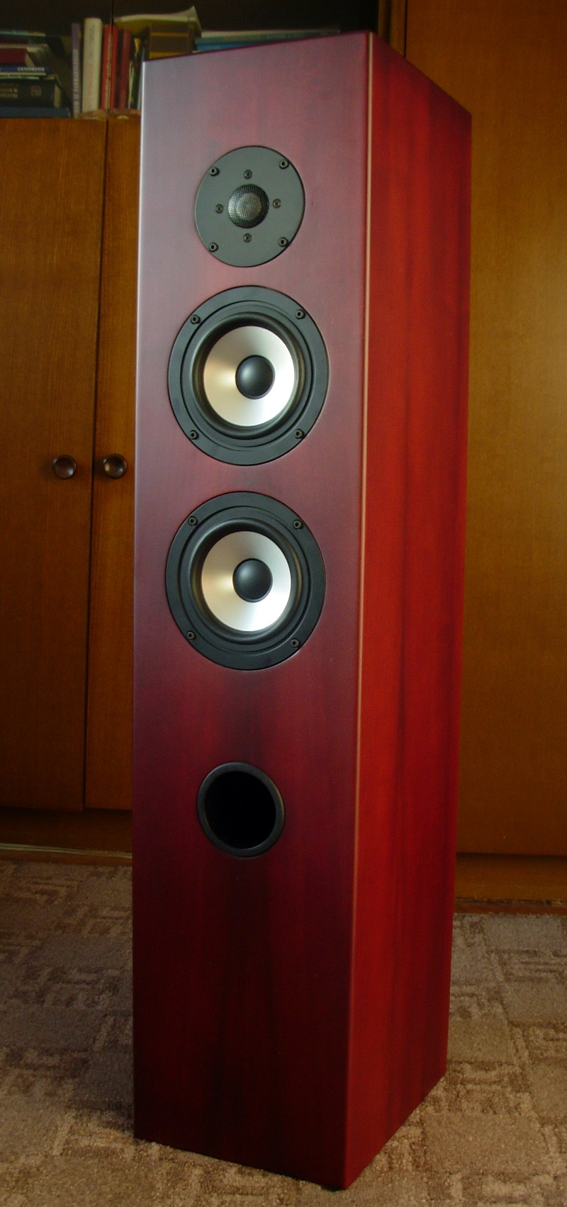

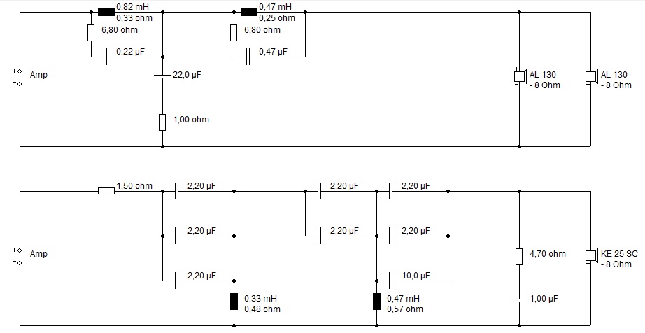

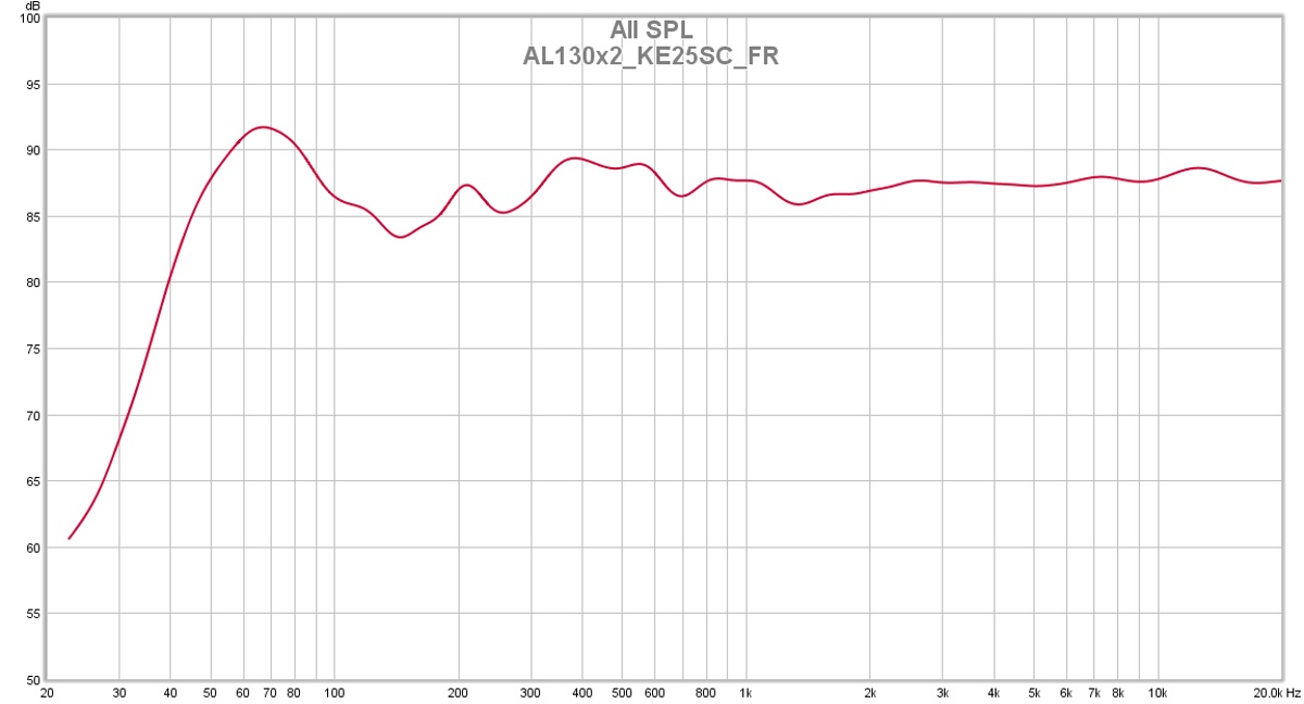

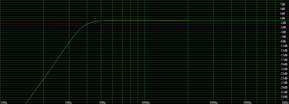

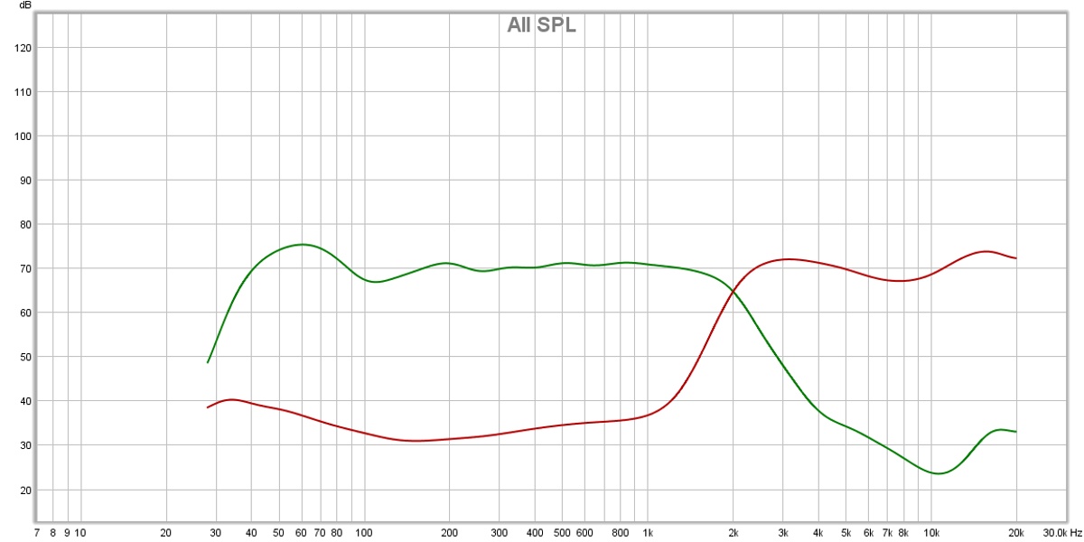

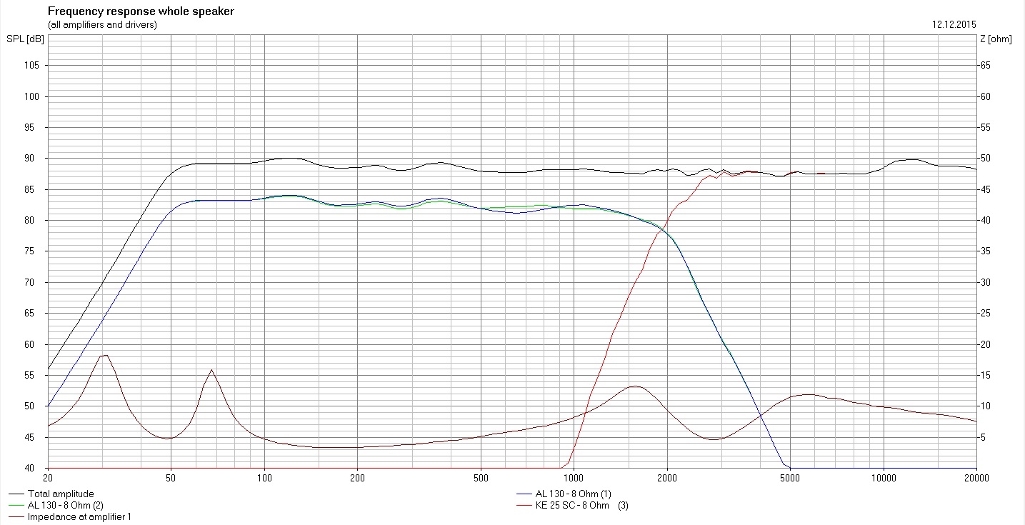

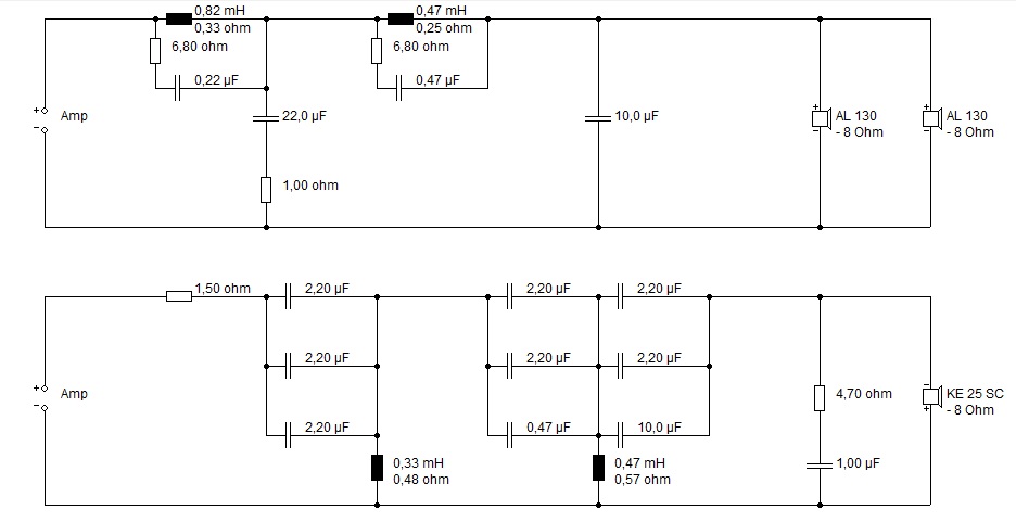

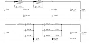

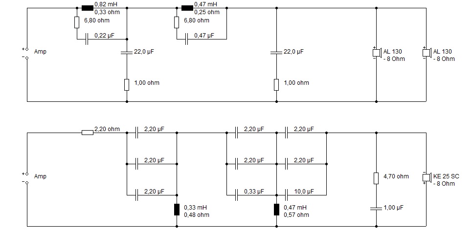

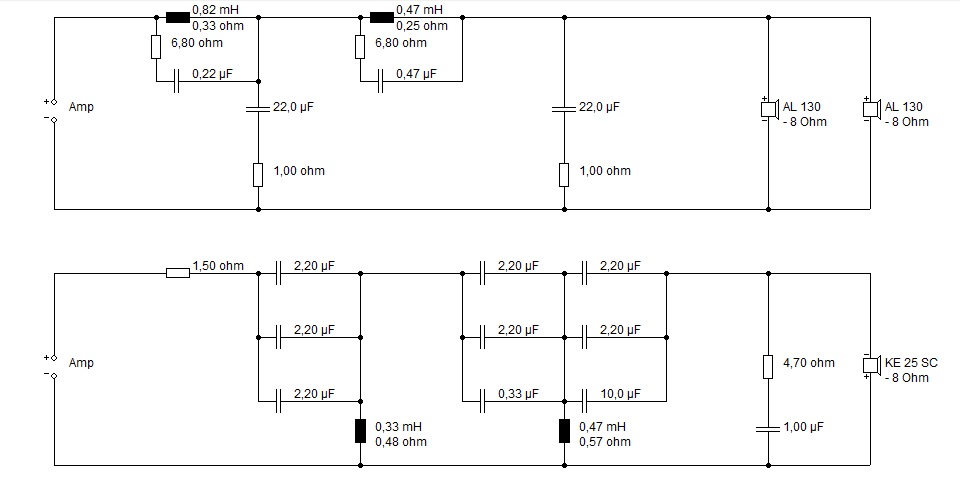

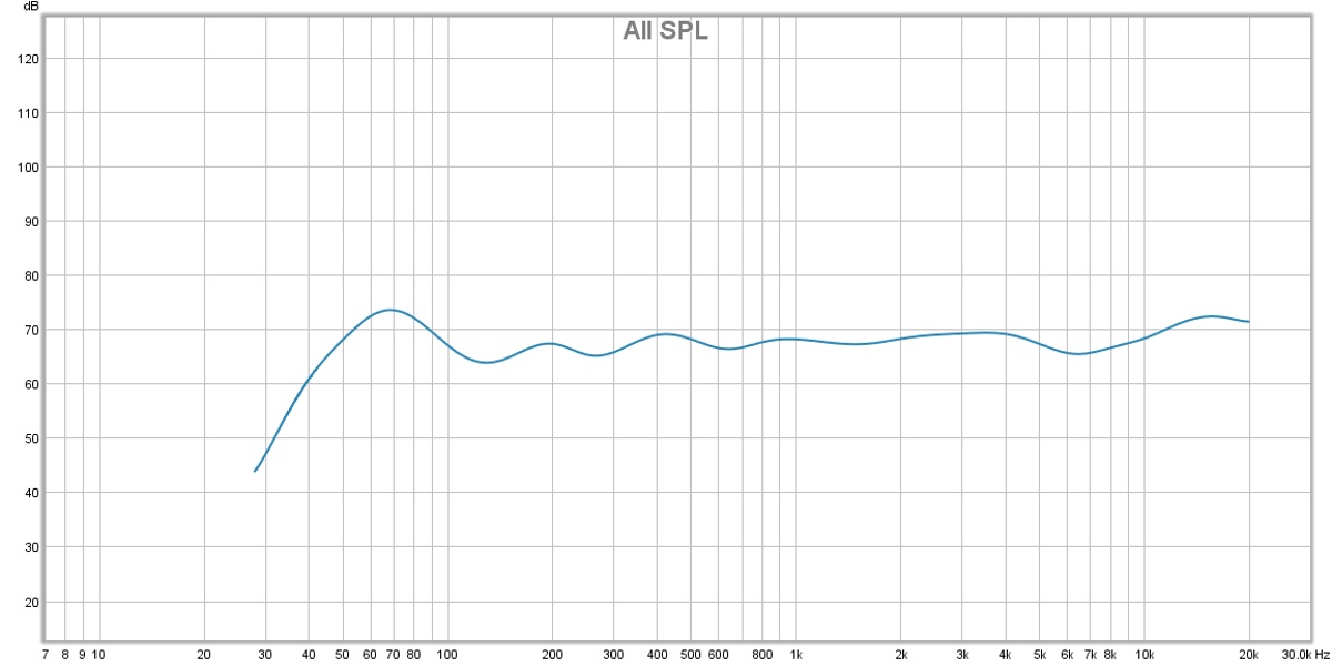

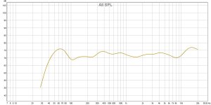

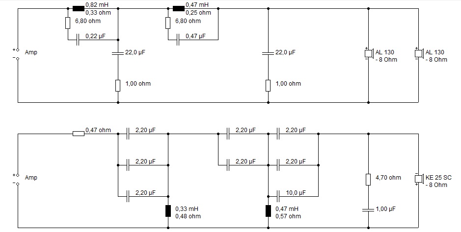

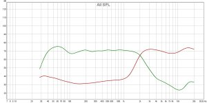

This is how it looks now..
Very unproffesional mesurements with iphone..
Final XO version probably will be without second 1R resistor on AL130, and maybe 1R5-1R8 instead of 2R2 on KE25SC.. but all that after serious measurements..

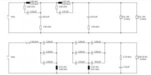

That is a very high order network! Especially on the high pass section. Remember in your simulations to account for distance differences between tweeter and woofer, and that each woofer will be a different distance. 🙂
Best,
Erik

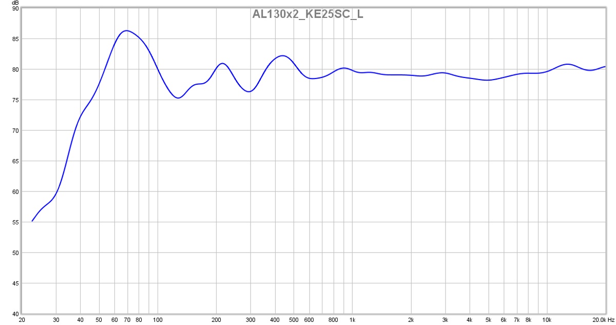

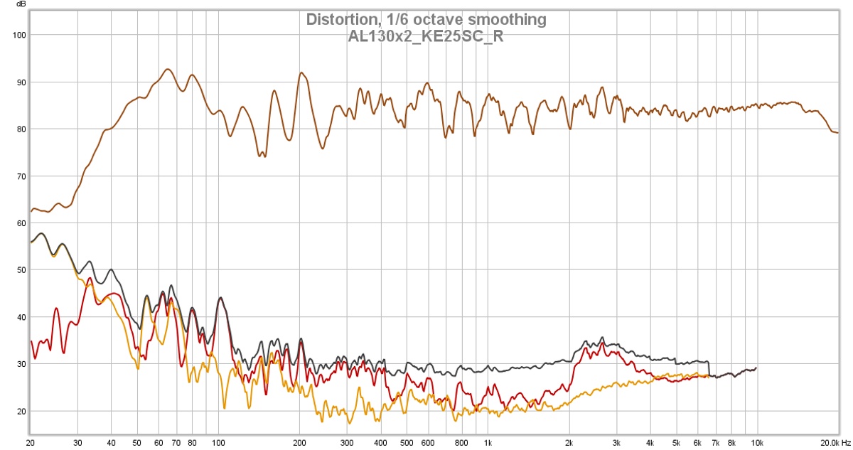

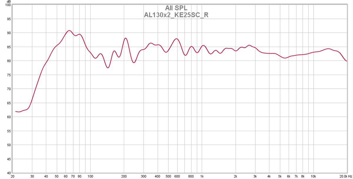

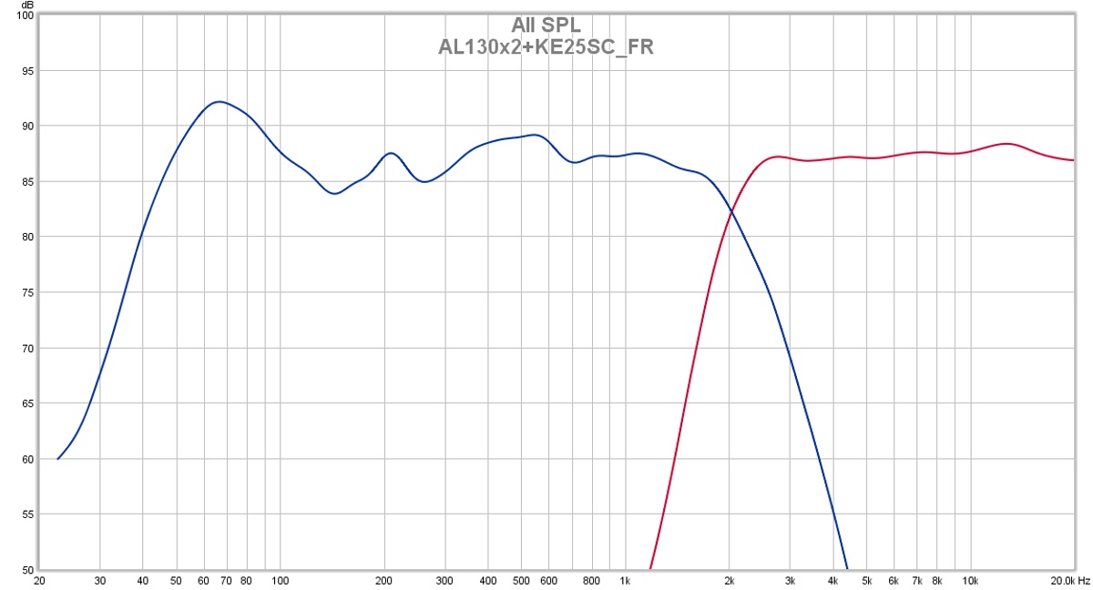

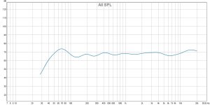

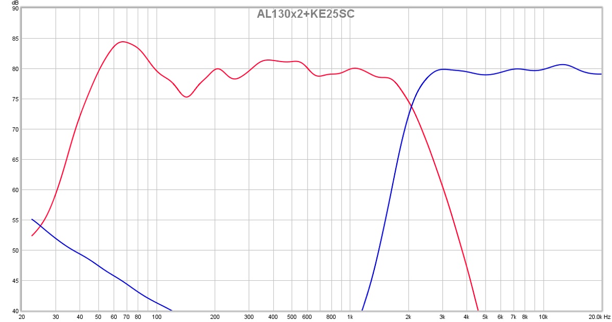

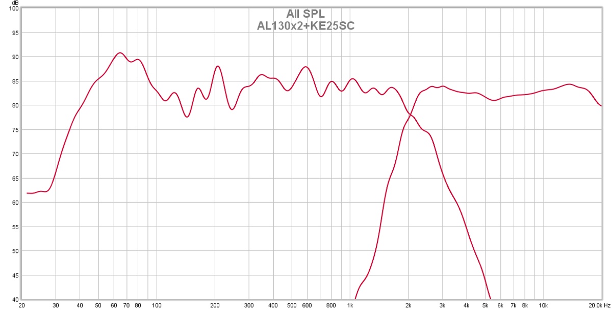

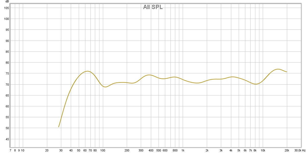

Measurements with Behringer ECM8000 instead of Iphone 5C..

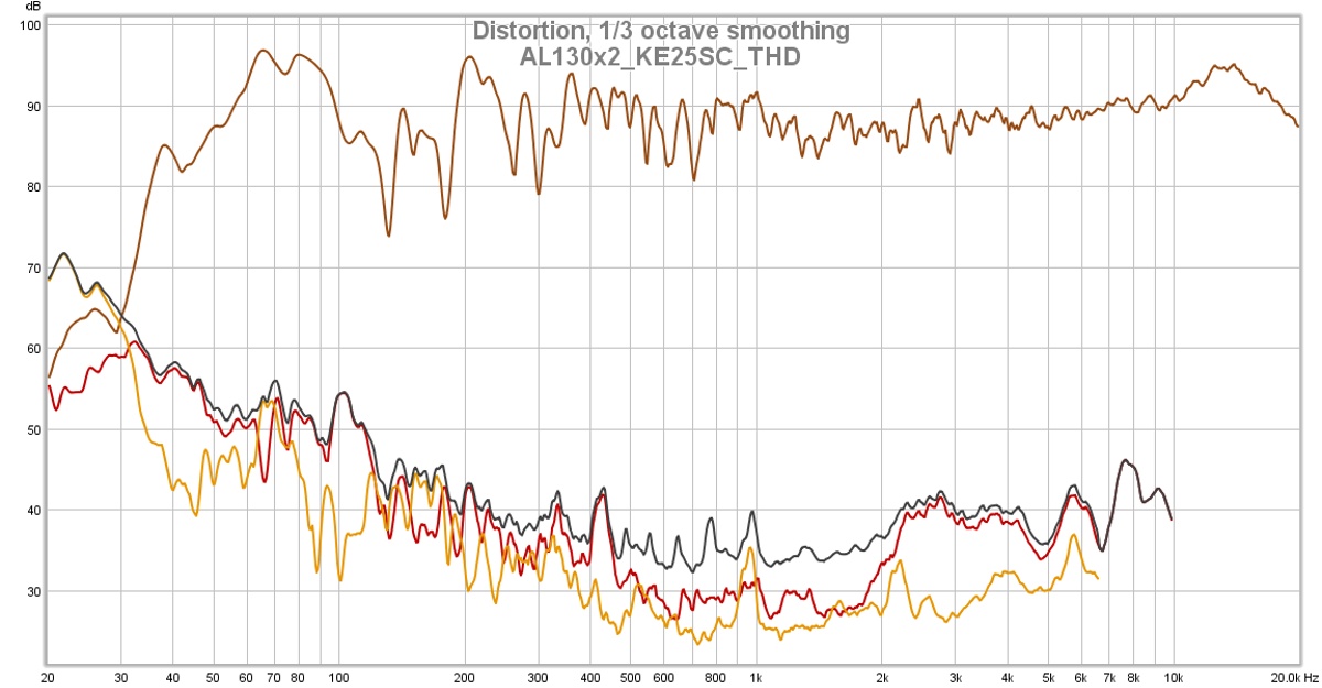

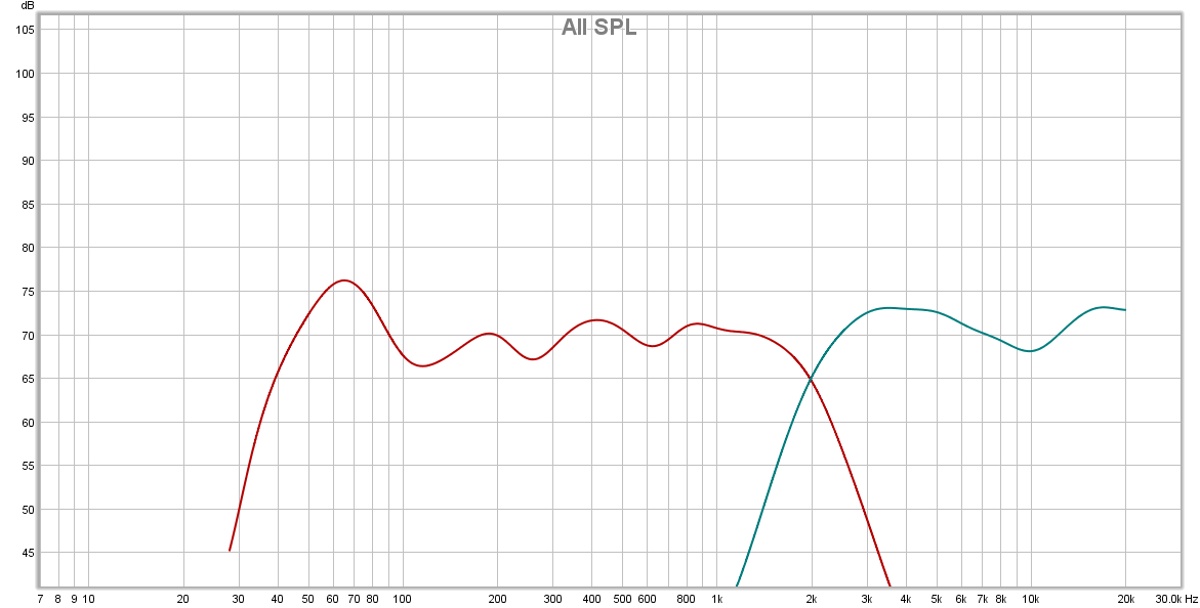

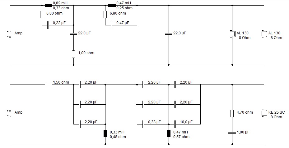

Small Changes

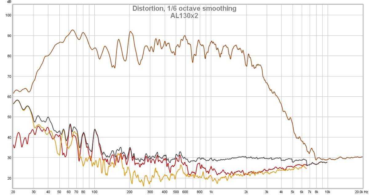

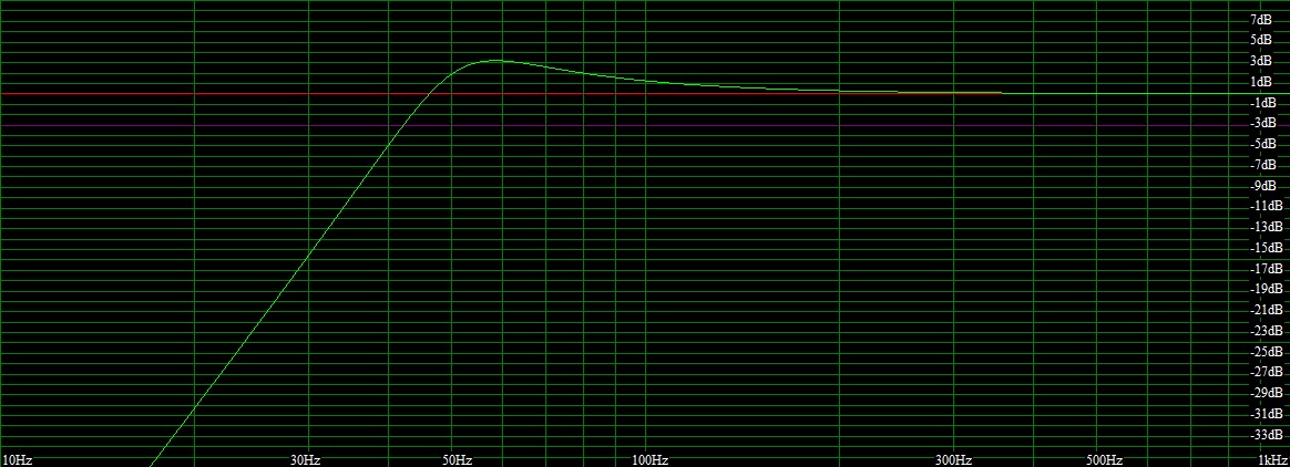

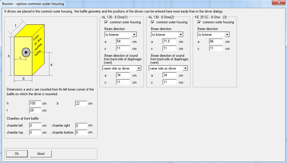

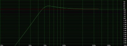

First simulation, pair of AL130 units in 35L box, port tuning about 40Hz.. second 35L-50Hz..
In measurements you can see room modes, far from ideal simulation, Fb-37Hz..
