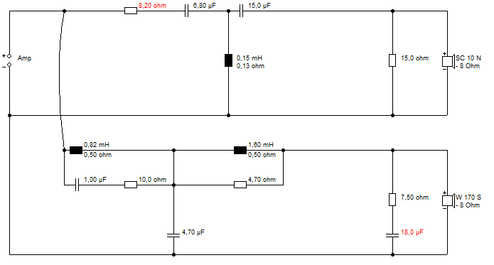

First you need a good idea, and what better than the BBC monitor designs for the filter:
Rogers Loudspeakers › LS5/9
A quick insertion of the W170S values (5.9R and 1.2mH) at this website gave me some bafflestep and impedance equalisation:
mh-audio.nl - Home

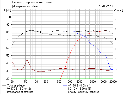

There we are, on a 32L 22cm baffle. Glorious impedance which any amplifier will love, and everything else works too. Who knows if this sounds any good till you build it? But definitely a poor man's DeVore Gibbon 88. 😀

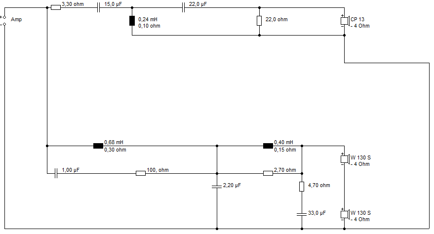

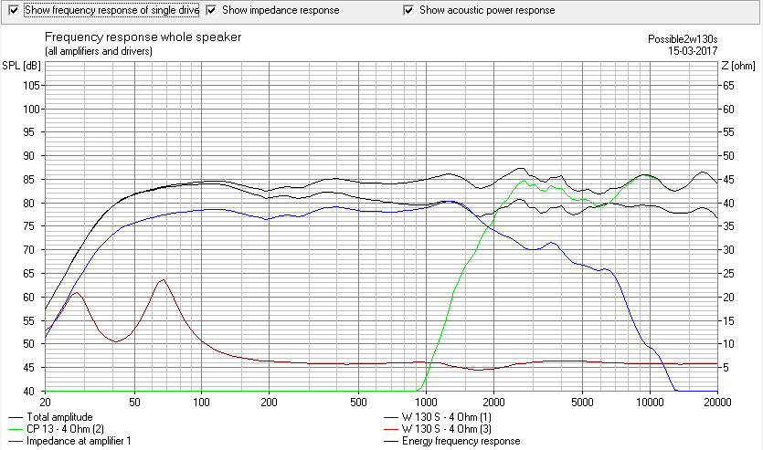

So I think after looking at everything, my option would be to use two W 130 S's (4 ohms), each in a 20L ported chamber, and one SC 10 N, like this:
That will give me 100 W and > 88 dB sensitivity (in other words, enough).
Will this sound big?
What I'm going to do for now is build a pair of speakers with my Philips 9710M pair I do have (and follow the advice in the link). I think they'll sound nice. I need to fix them up a little. The only problem is volume. They're only 10 W each. And I believe they're only 91 dB in a sealed box. I want to compare them to my Celestions.

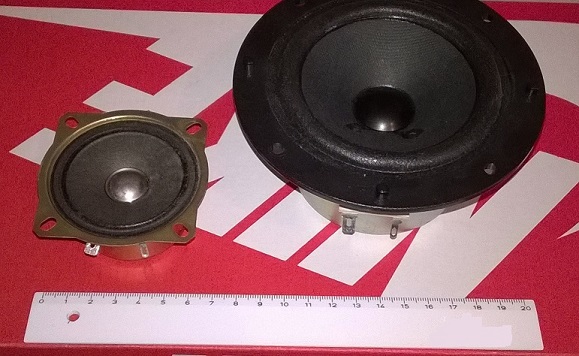

Mrcloc, yes I think it has the potential to sound big and with plenty of bass until it gets out of steam which can be simulated. I have worked with this unit (W130S) too and crossed it to a Visaton G20 which gave superbly detailed sound and I atribute it to this silk dome tweeter that reminds me of the Dynaudio D21/2. I'll try to do some simulations in Boxsim but not right now for I'm in the middle of doing something else. The attached photos is something Steve might like to see used more often and I have taken these out of a poor sounding Aiwa mini stereo. I'm working on a chip amp powered by a single ended 12Vdc these days and later I'll try to build small enclosures for the speakers. The basic idea is to use whatever I can find for free on a junkyard and stuff laying around on shelves. So far, so good.

That won't work at all. Puny tweeter just not up to it. 😀

There's no replacement for displacement with bass. But the SEAS Bragi MTM is a good one for an authoritative sound. And series wiring two 4 ohm basses is also a good one. Or you can add a sideways firing bass or two as in the Devore Fidelity Gibbon X.
Your impedance correction can't be right for two series wired W130S-4 basses. You need to check that. I get 8.75R/15uF.
mh-audio.nl - Home
W 130 S - 4 Ohm
You have to double the DC Resistance (3.5R) and Inductance (0.6mH) with two in series. Bafflestep is a moveable feast. 4dB is usually about right. But if you want more bass, you definitely need bigger drivers.

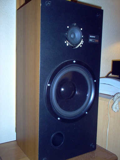

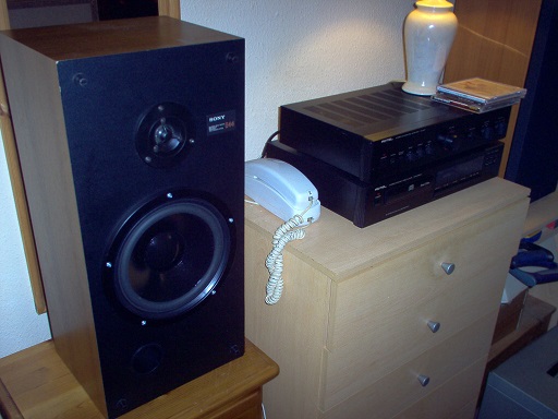

Here's some Visaton experiments I did a while back. Both pretty good.
8" W200S-8, DT 94 and TW 70 cone tweeter. Actually the port was a bit small, so I fitted an old Sony 8" bass I had lying about.
