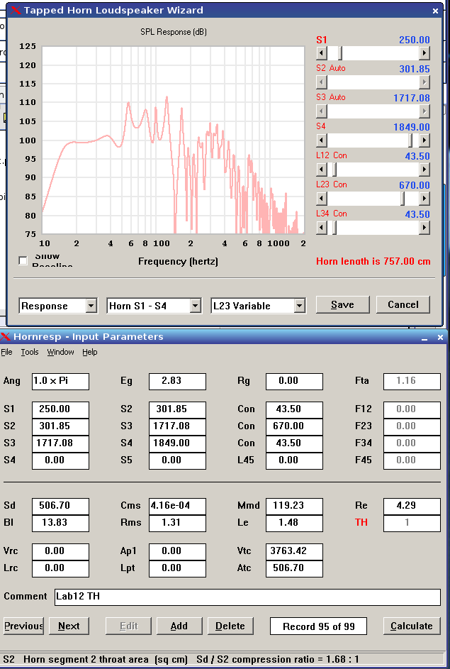

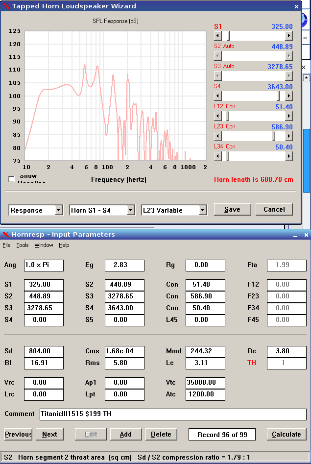

One thing that might give us a little bit of wiggle room is that the horn can be tuned a little bit higher than 16Hz (actually I believe the actual frequency is 16 point something) as long as it doesn't unload enough to damage the driver and still provides enough output to be useful.
The opening into the room from the chamber is 6' wide by about 5' high on one side and about 6' or 7' high on the other however back from the opening a few feet we have at least 8' or 9' of width. So a stack of up to four horns (front, back, tapped or whatever) could be accommodated up to 8'x6'.
The chamber in which I plan to put the pedal and great division has an electric overhead screen several feet in front of it leaving only a couple of feet of the opening above the screen. I assume that the sub-woofer would have no problem with this and the smaller speakers could be installed in such a way as to allow them to speak over the screen. Getting an acoustically transparent screen is a possibility as well.
Do you have 8' tall? aka a quad of up/back TH that's 8' tall by about 20"x24"

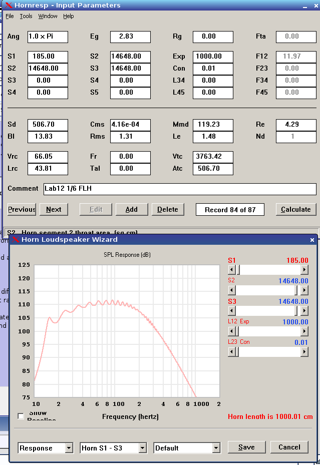

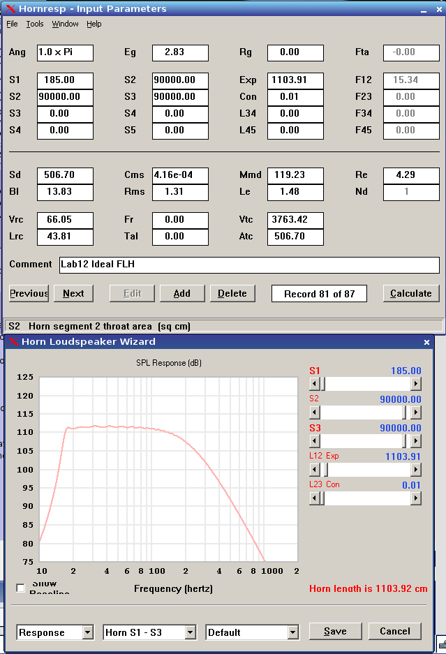

Interesting that you should mention that driver. I looked at it some time ago as an IB.
attachment.php
It seems to like a TL even better. No need for EQ in the TL and maybe a couple DB more output.
attachment.php
The distortion might be better with IB but I am not sure once you add the EQ. Might need 8 drivers for IB. Four drivers gives about 135dB Max SPL in the TL v.s. 116dB in the IB (x-max limited). 8 IB gives about 122dB. Might even be able to get away with two in TL.

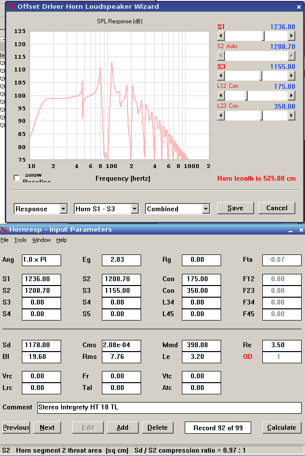

So, regarding the manifold IB, I was wondering what effect the manifold would have on the parameters/alignment of the woofers. It seems that just like the rear chamber has an effect the manifold ought to as well. I would like to hear from anyone who has investigated that.
I thought that maybe I would try to model it so I set up Hornresp with a large sealed rear chamber in a short straight horn with offset drivers as my best first try at modeling it. Of course it doesn't model the two drivers firing into each other but it was the best thing I could think of off of the cuff. Is there a better way to model this.

The way you model seems correct.
"V" shapes do seem to be less peaky than parallel wall plenums.
If you do decide on IB, I'd suggest flush mounting at the front of the chamber for a smoother frequency response.
