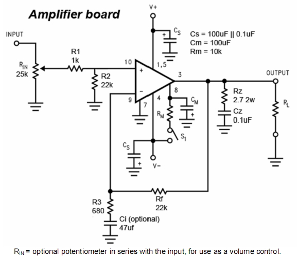

Sorry for the delay. I was away from internet for a bit. Here is the schematic for the amps, pretty straight forward chipamp. As I said, PS at this point is regulated 72V and I need to split it to +/-36V.
I have extra LM3886 chips, so that is not a problem, but I am always interested in more 'elegant' solutions.
Thanks for the input.

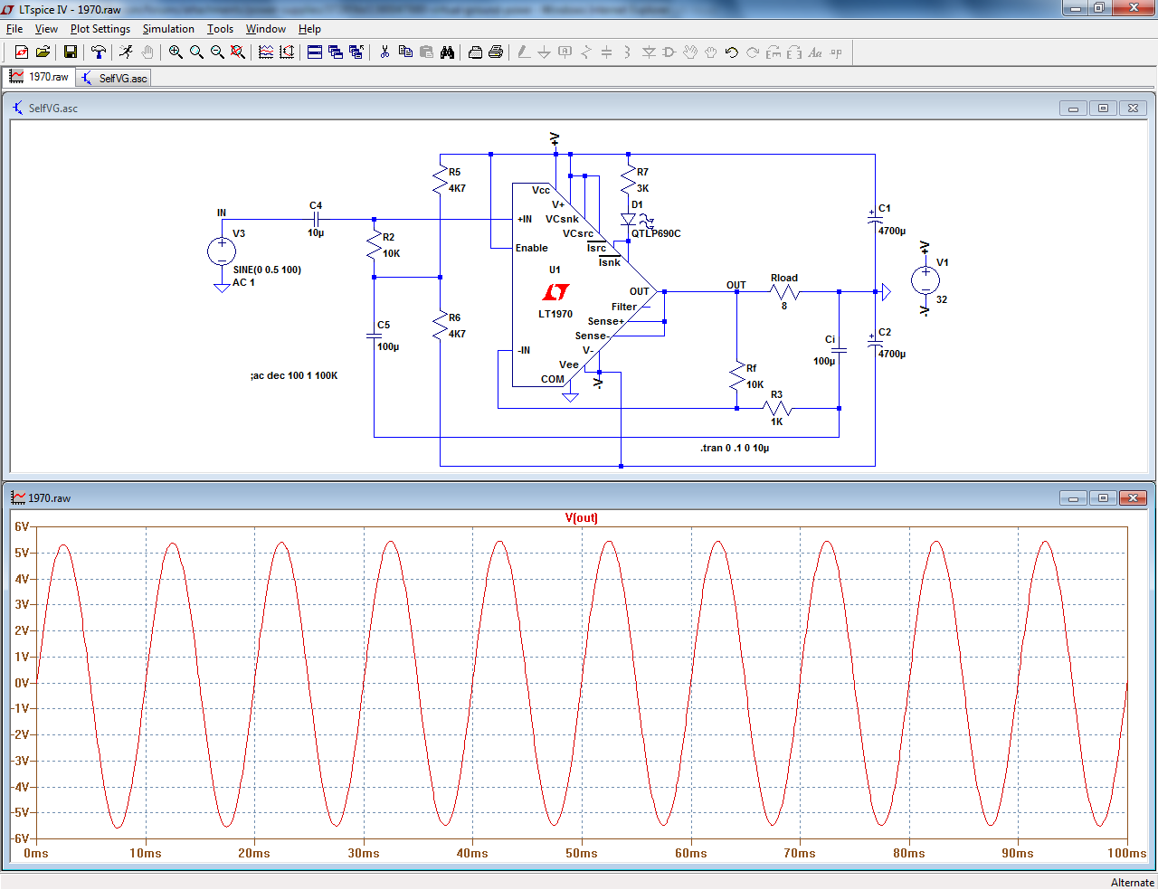

You can use a circuit like this one: the components designators are the same as in your schematic where it applies.
C5 and Ci are not critical, they should just be large enough and preferably bipolar since they will see the offset voltage of the amplifier which could be either direction.
C4 is optional.
The virtual ground potential is enforced via the load. If you want to have a predictable behavior when no load is connected, you can add another resistive splitter in parallel with the 4700µ capacitors

The schematic has omitted the DC blocking capacitor on the input.
It has also omitted the RF filter on the input.
