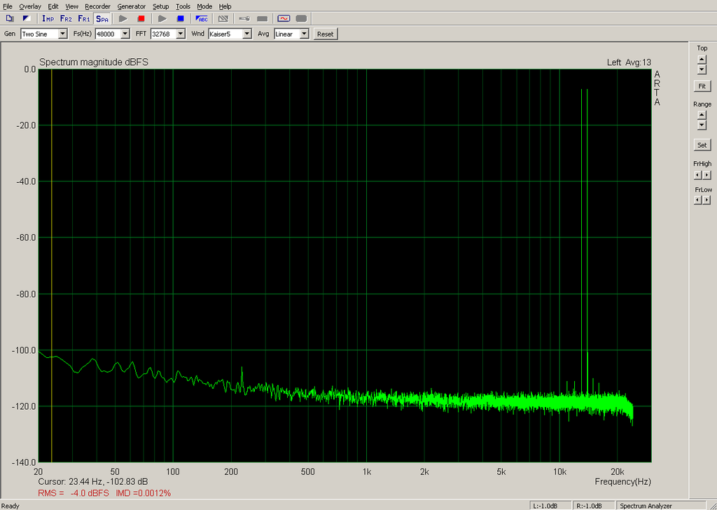

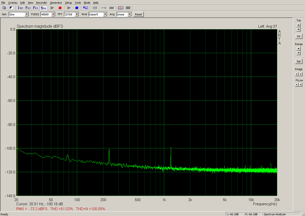

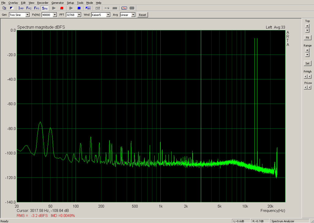

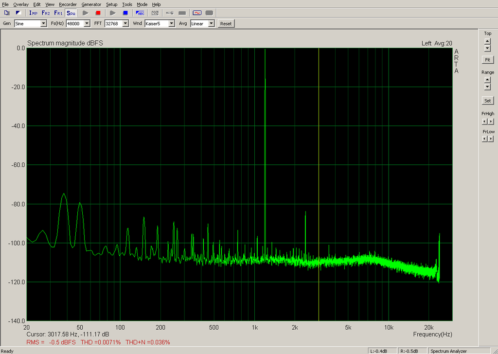

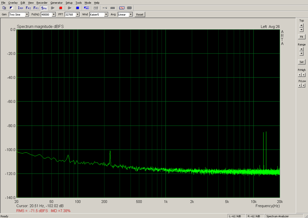

Measured results:
Line-in jack on PC front panel was hooked with line-out jack on back panel with a regular thin long curly stereo jack cable. Older power-consuming workstation producing lots of EMI/RFI (Dell Precision, 2 x dual Xeon, 72GB RAM), internal Intel HDA with 24bit codec AD1984A.
Measured in arta under wine (wine must be configured to offer alsa software devices)
Code:
winetricks sound=alsa
Sound - WineHQ Wiki
Useful Registry Keys - WineHQ Wiki
Measured results show that even a simple integrated soundcard in the extremely noisy environment of a loaded PC offers very good CMRR (70dB).
With a stereo soundcard such setup can enable measuring bridged amps and/or significantly reducing ground loop effects in measuring.
A multichannel soundcard can be configured to provide stereo balanced output for longer runs and/or reducing the ground-loop issues.

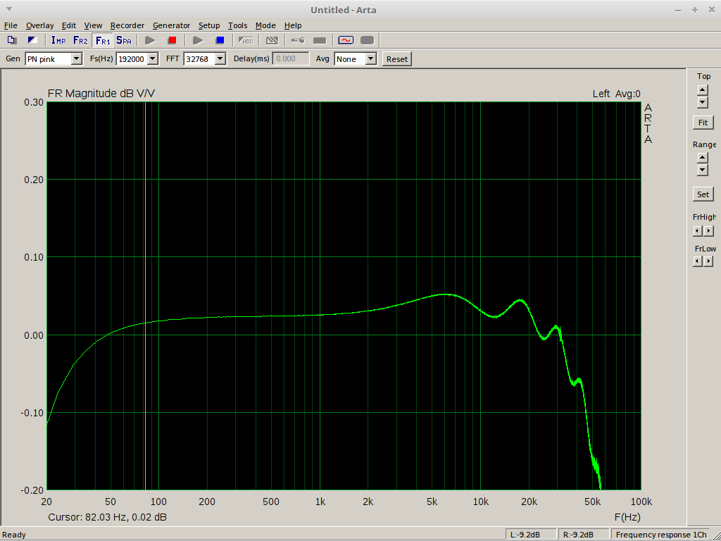

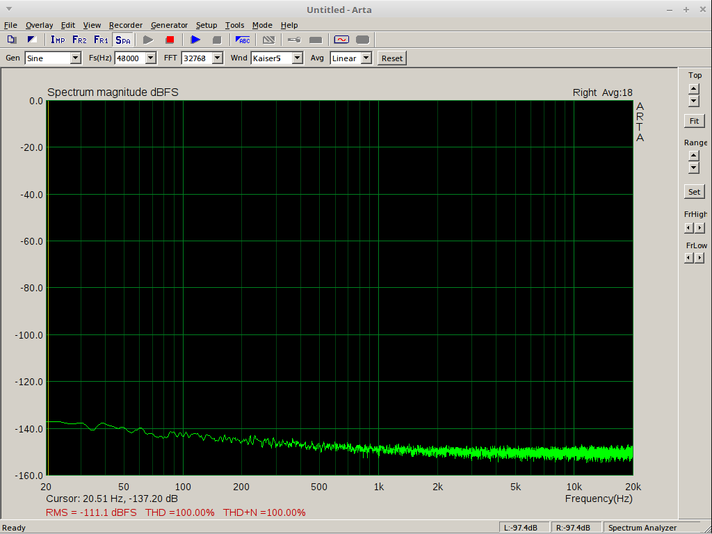

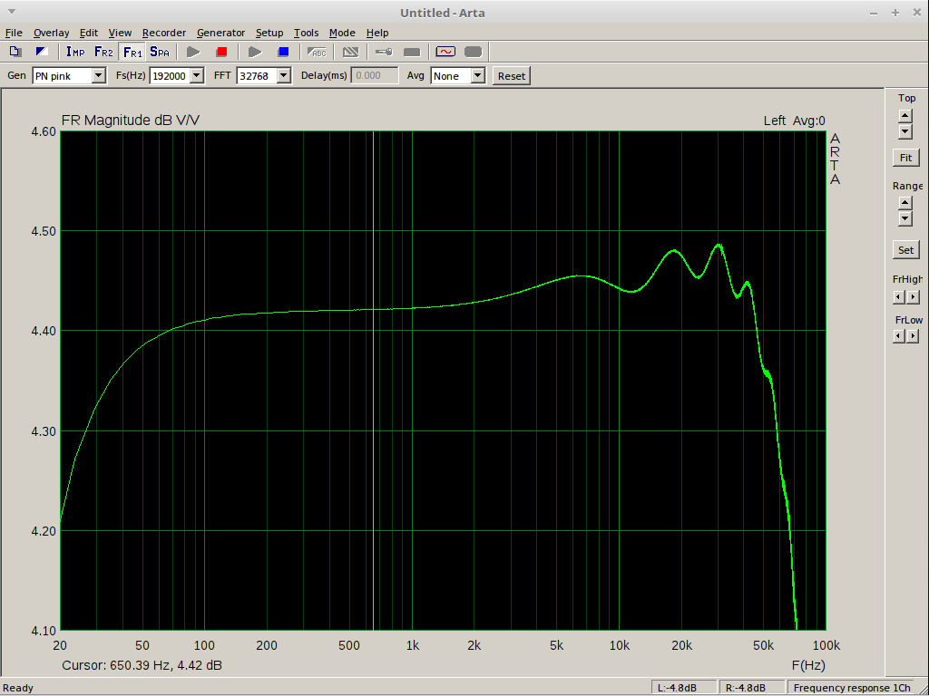

I'd like to show measurements of two amplifiers giving 1Vrms into a real loudspeaker using this method.
Measurement equipment:
- virtual balanced input on line-in of internal soundcard [Realtek ALC892, ADC with 90dB(A) SNR] in a PC with ATX supply
- Linux+Wine and ARTA measurement software
Both measurements are direct input from loudspeaker terminal into L+R wires of line-in input - no divider (ground wire was not connected). Voltage on a speaker terminal 1Vrms.
Notice: without virtual balanced input measurements would show much more power line frequencies and their intermodulations with a signal.
Amplifier #1: NAD D3020, USB input [Class-D]
Amplifier #2: DPA222mk2 fast SSE [Class-AB, designed by Pavel Dudek (Upupa Epops), built by me from DIY kit]
In this case I used internal sound card as a signal source. It has a higher noise floor at least by 3dB than it would have with a better signal source.

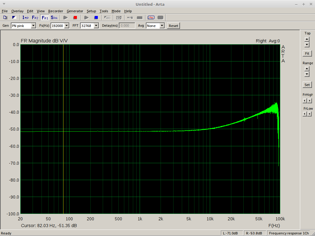

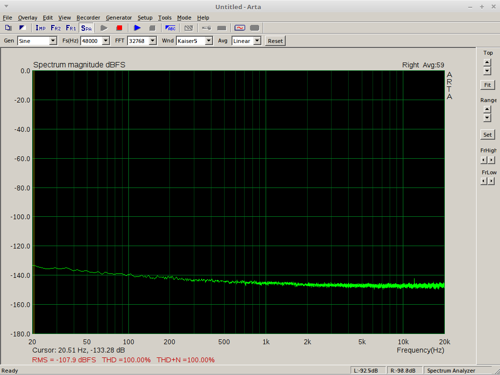

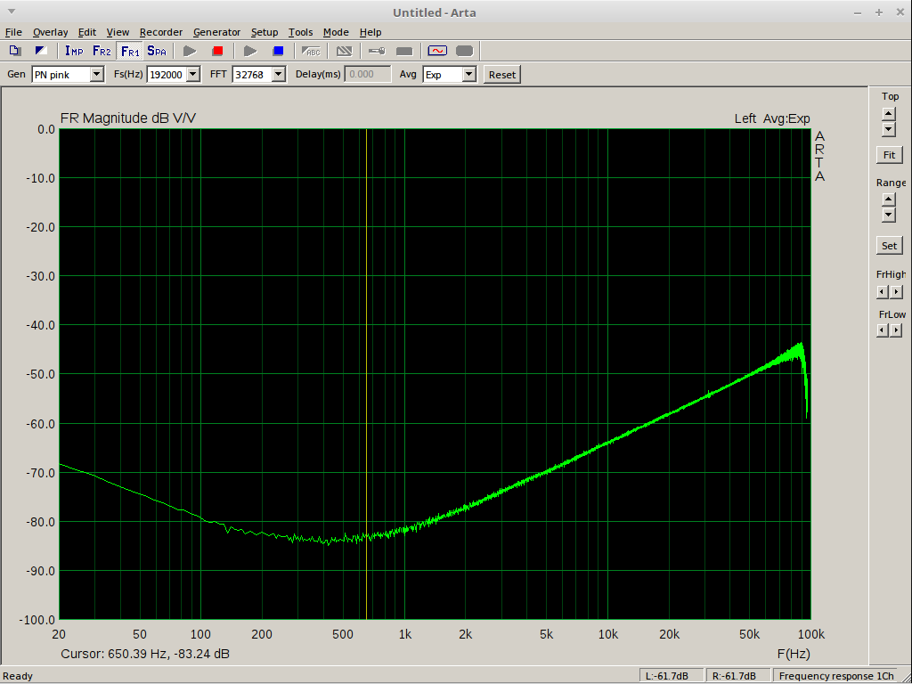

Comparision of virtual vs. native balanced input of ESI Juli@ in my measurement station Headless Amplifier Measurement Workstation
The poor CMRR (-50dB) of native balanced inputs suggests Juli uses a fake balanced input similar to one described in Audio Note
When shorting the corresponding SE (cinch) input, the cold balanced input sensitivity drops down to -50dB.
IMO the performance of calibrated virtual input is clearly better than that of native fake balanced inputs of Juli.
Of course a proper balanced input with good differential amp does offer a significantly better CMMR (e.g. -100dB for Lynx22 with standard INAxxx).
While this sounds plausible, there is absolutely nothing "fake" about this circuit as long as R1/R3 and R2/R4 are matched. It is a functional balanced line receiver and used like this in loads of lower-cost (home) studio or PA equipment - power amps, monitor speakers, digital crossovers, you name it. It merely involves some nasty tradeoffs between (common-mode) input impedance, gain and noise performance, so it's not really good for anything more than a basic line-level receiver, where levels are high enough and thus lowest noise and highest CMRR aren't of utmost importance. Some particularly cheap manufacturers have also used it for a balanced mic preamp of particularly meh performance - not recommended.
If you take that same circuit and add a buffer in front as outlined above, performance can be improved dramatically. Likewise, a discrete variable-gain balanced frontend turns it into a pretty decent mic preamp (ESP P66, Behringer mixers). And of course, the two amps of the buffer can also be used to form an instrumentation amp.
So lower performance - yes, but fake - decidedly not.
This will work fine if you just do a loopback measurement, however in a real-life application you'll have to determine channel gain delta for input and output separately. No way around making cables or plugging up adapters so you can split one output channel across both L and R inputs or alternate between the output channels on either input.
Very true. That is what my automated calibration tool with preamp was planned to provide measurement-station/preamp-schematics.png at master * pavhofman/measurement-station * GitHub But since then I have moved a bit further and the planned calibration tool will have to change https://www.diyaudio.com/forums/equ...ensation-measurement-setup-2.html#post5584029
Once you've matched your input channel gains well, there is no reason why CMRR couldn't be pretty high
Well, it is not only about gain, each channel has a tiny bit different transfer function which again lowers the CMRR. This is not the case of a good differential amplifier feeding just single channel.
On the other hand the DA conversion involves errors which cancel-out in virtual balanced setup - like the small fs/4 peak in native balanced spectrum of ESI Juli (the second screenshot above ) - gone in the virtual balanced mode (the first screenshot).
Thanks a lot for the explanation. A Lynx card with proper INAxxx differential amp measures CMRR -100dB, while my Juli does only -50dB and virtual balanced inputs perform far better. That is why I called it fake :)
