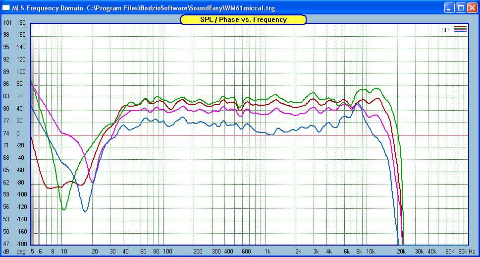

I've been busy with things the last few days, but thought I'd share this pretty little graph. This is 0deg, 30deg, 45deg and 60deg. I measured it outdoors, 3.5m in the air, at 1.85m, and it is effectively ungated. 30deg is the listening axis.
Read it and weep! -6dB at 30Hz!
Dude, that is one sweet polar.
How flat's the phase?
Terrific! I am still wiping my tears off. 😉
I have seen such a response only in simulations before. Considering that you could achieve this with such a modest system (cost wise) makes it even more remarkable.
