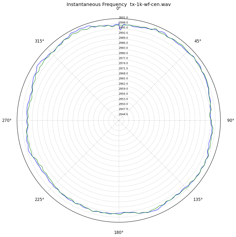

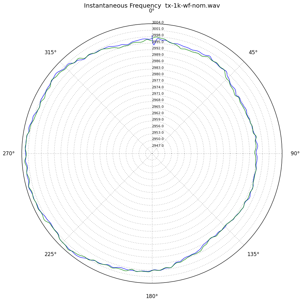

Last, two polar plots, before and after centering, attached. IIRC, the error on this record was ~0.15mm. I still prefer the SP-10MK3 for ergonomics, but when archiving I use the TX-1000. Once I paid attention to the errors they became impossible to ignore, and the majority of records I've played on the Nak have rather meaningful errors.
