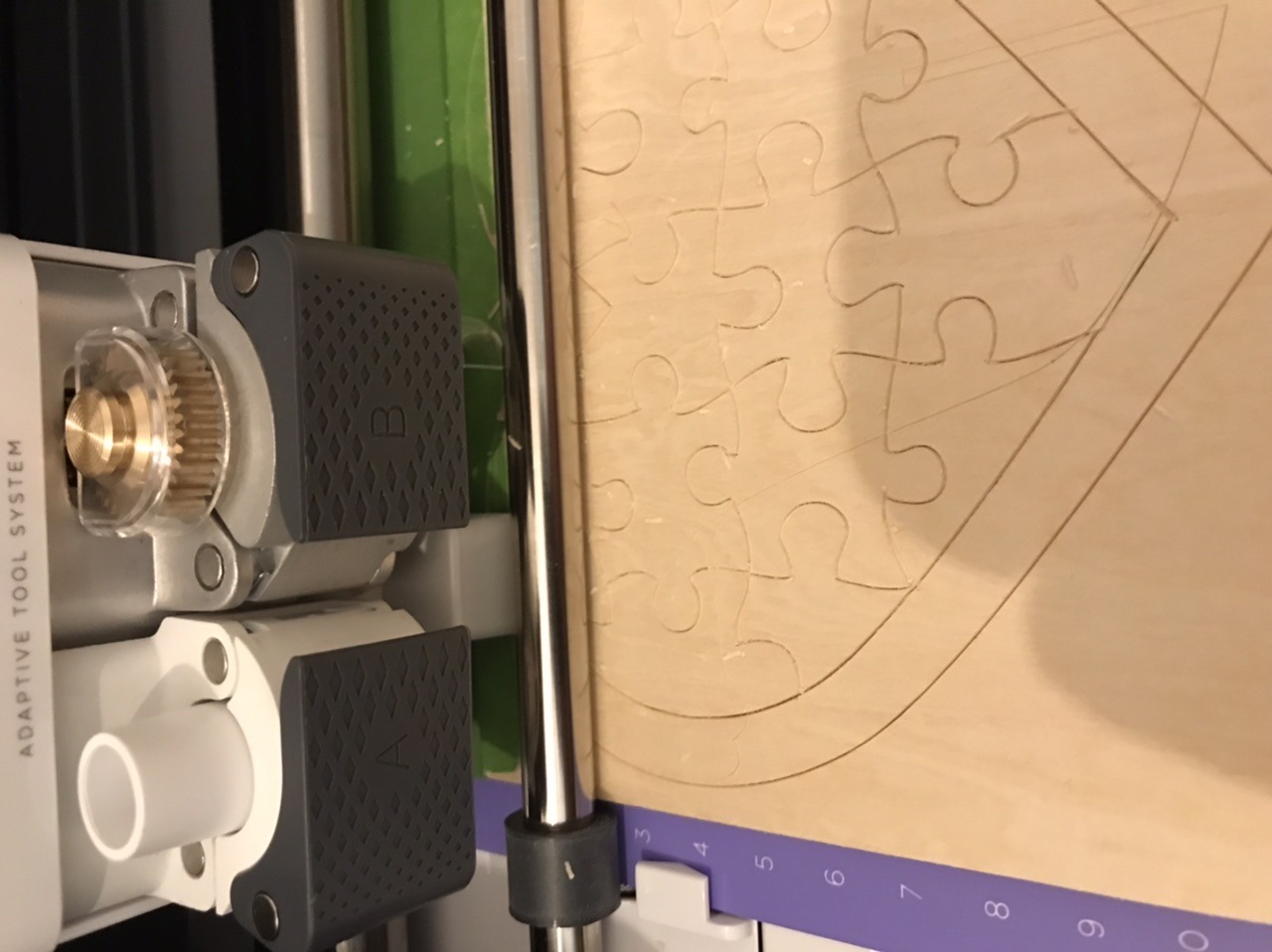

I bought the Mrs a Cricut Maker for her Xmas present, previously she’s been using the cricut joy for a while.
I tried the same svg file output that failed a few posts back - the same problem exists (it can render the image correctly but the layering sees the white centre of the pcb holes as a different colour.
I will try a postscript to see if the software handles it. It’s certainly capable of cutting thick materials and plotting quite accurately after it’s been calibrated. The maker has a motorised blade rotation as well which it uses rather than relying on the direction of the cut - that makes tear outs less of a problem

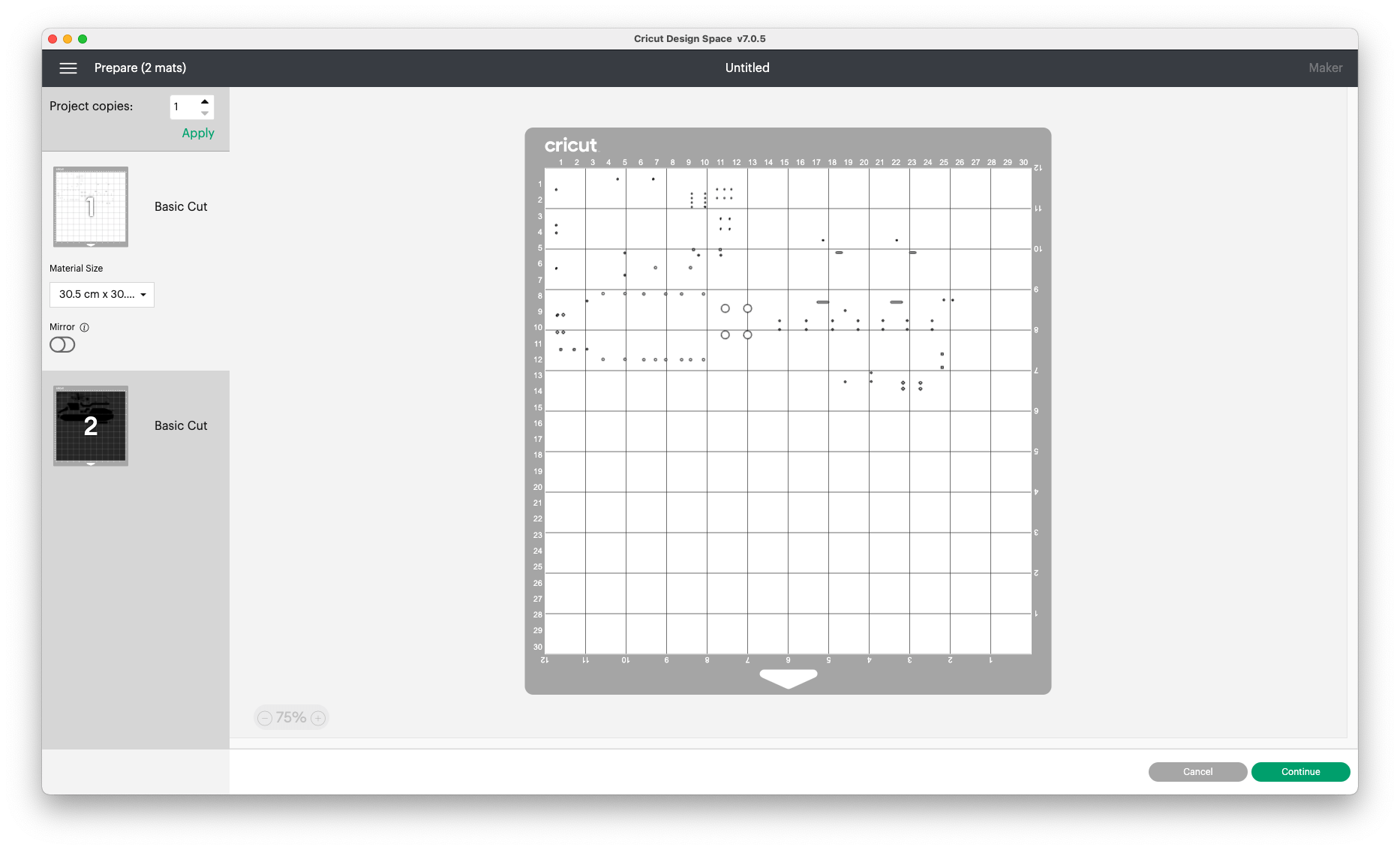

I've been playing - it seems Cricut design space (the app) can also import DXF which it does a far better job of than SVG.
I have got the the point where you can see the holes on the prepare screen - it helps taking the drilling DXF and then using that to create the holes by splicing the the drilling and the top layer together. "Splicing" is Cricut's terminology for cutting one layer out of the other. Too late now for more playing bit seems that it could be possible with alot of messing about. You'll also need to "weld" the images so the pieces of the images are kept together in the correct layout.
