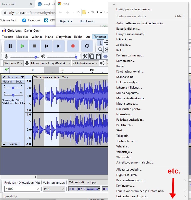

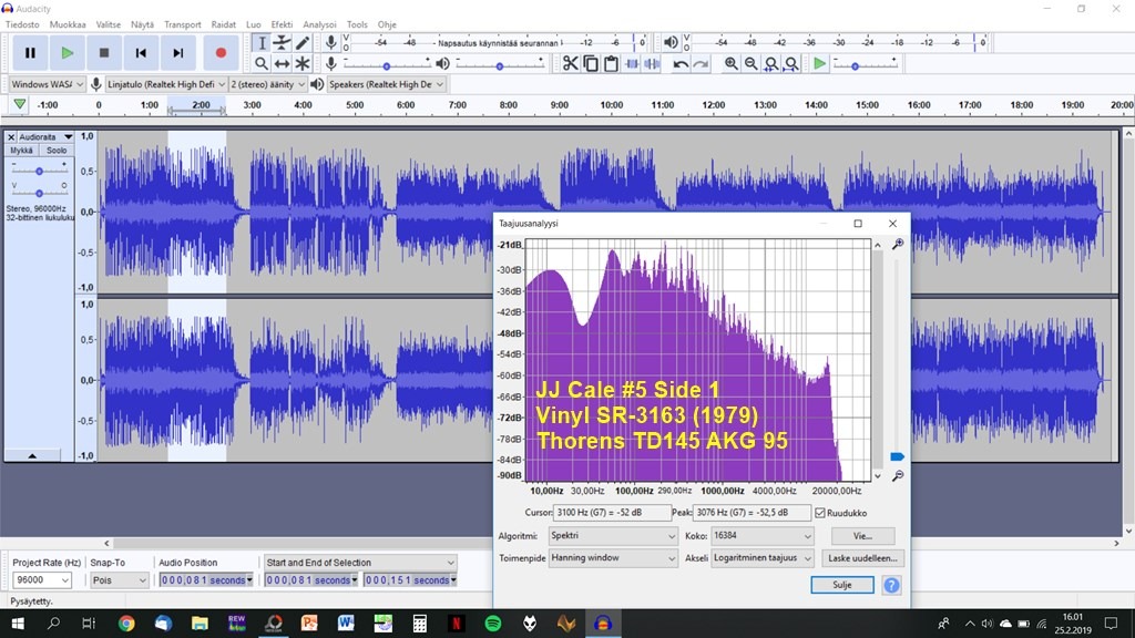

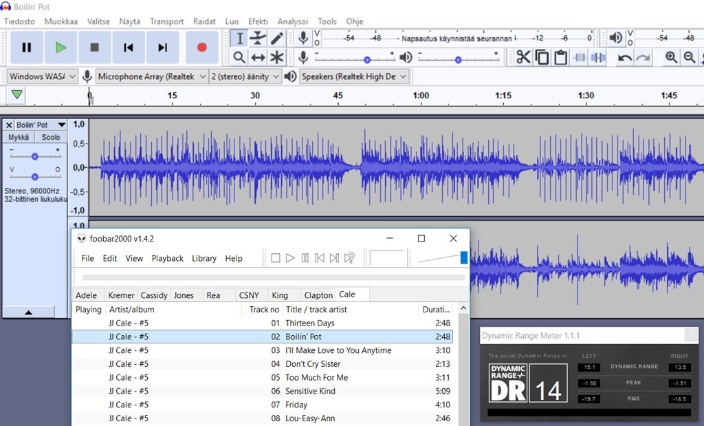

Humbug,
looks like you are using Audacity for editing - like me. Some tips:
Take recording 24/96 because it's best for editing, I play one side of an LP nonstop, then split tracks before editing. Check level so that no digital clipping happens
Edit tools can do wonders for analog copies
- remove clicks and pops.
- remove rumble (highpass)
- PEQ tone adjustment (is seldom needed) if your preamp doesn't have RIAA
- etc.
Like others have stated, analog recordings during 70-80s were mostly very good, with high dynamic range. Also early CDs had high DR. LP noise is much higher than digital, and that cannot be fixed. But after rumble highpass, it's not a problem, just a feature...
audacity tools.jpg cale 5 vinyl rip boilin pot 12dB2 5Hz.jpg cale 5 vinyl rip raw.jpg cale wave dr.jpg
