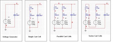

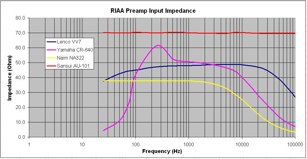

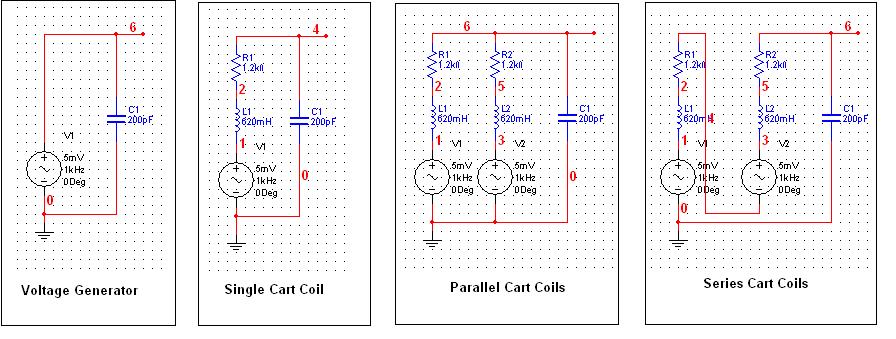

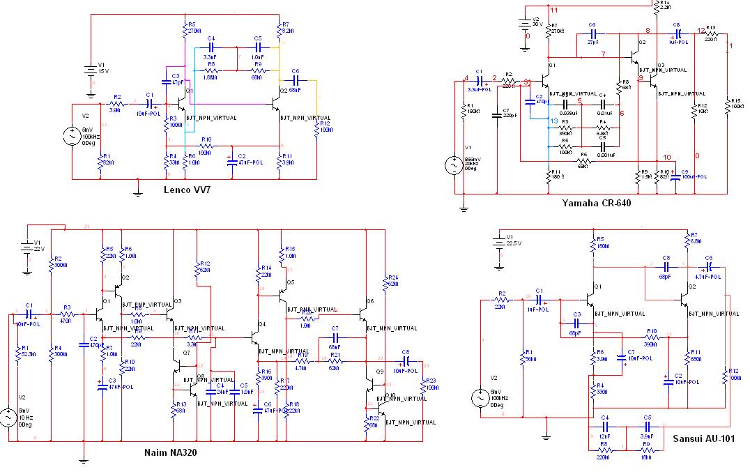

I am reading the opinions about coils loading with interest and I thought of the input impedance of the RIAA preamplifier.
I simulated the input impedance of four different circuits.

Yes, that's interesting, the joys of servos. It's the case where |Zin| dips significantly that might be interesting I think for certain carts. Perhaps it's a small step in your sims to look at input current when driven from a cartridge LR source, George, might be interesting?

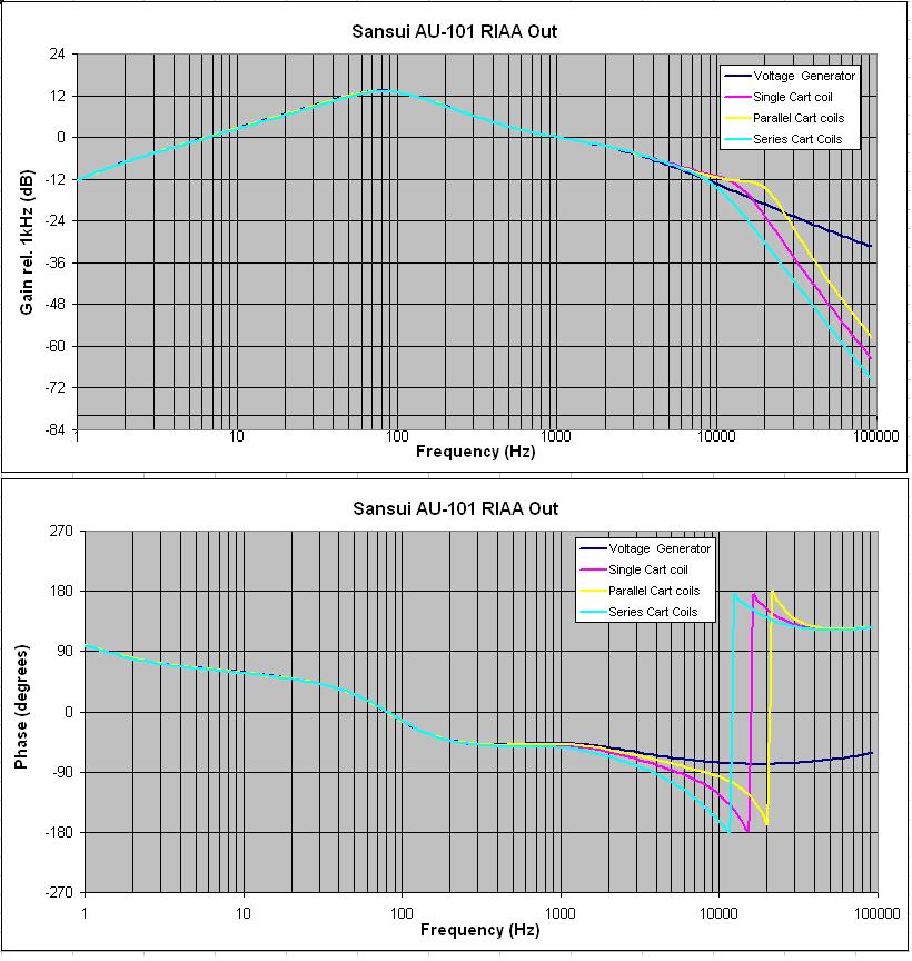

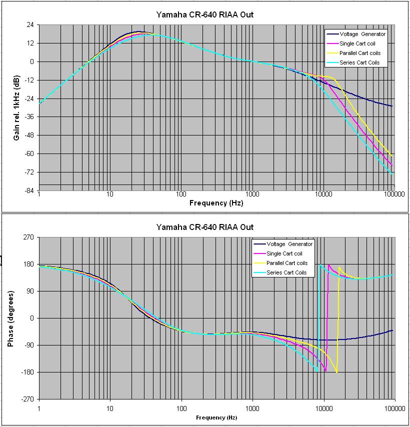

I chose the Sansui AU-101 with the flattest input impedance and the Yamaha CR-640 with the most varying input impedance for to sim the preamp output when the four different sources are connected to their input (note the gain is rel 1kHz in each case, so the +6db for the series coils is not shown)
lucky, I have reservations as to how well these source models are able to show what really happens when coils are in series or parallel connected
Yes. Thanks for posting those sims, George. I agree that source models as a voltage source with series RL probably typically doesn't say it all under abnormal load conditions. Not least because of non-ideals in magnetics and mechanics which might vary with operating point. IME yes this can vary greatly between cartridges, unfortunately.
