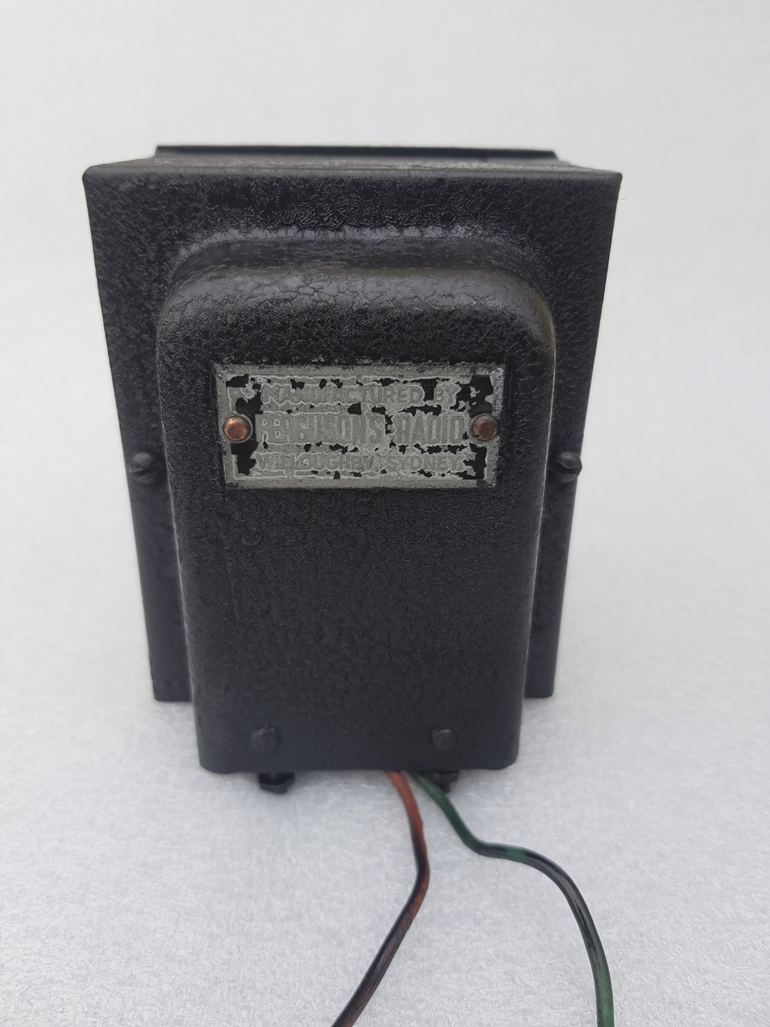

I just wanted to share some pretty decent results in obtaining the vintage wrinkle paint look/finish we see on old electronic equipment, The brand paint I used is
called 'Dupli-Colour wrinkle finish' black.
The instructions on the spray can indicate, apart from the usual making sure the pieces are oil, dust and wax free. To spray one thick coat in a horizontal fashion then leave it for 5 minutes, Then spray the second thick coat in a vertical fashion, Another leave it for another 5 minutes, Then spray the third thick coat diagonally.
The instructions also indicate that if the paint doesn't start to wrinkle to give the piece a fourth coat, However, I then placed the two pieces under a 500watt indoor work light for approximately 30 minutes, The results look pretty spectacular.
The work light I used is the type painters and decorators use indoors they do produce a lot of light and heat, I don't know whether the heat from the work light helped with the wrinkle process of the paint but I was blown away withe the results.
The instructions on the spray state the normal drying and hardening process takes two days. The test pieces I used are the covers of a filter choke. I hope this can help others out.

In the States, it looks like this paint is called VHT Wrinkle Plus.
https://www.duplicolor.com/video/wrinkle-plus-how-to-dupli-color/
The guy in the video uses a heat gun to accelerate the drying/wrinkling process.
It would be nice to make a drab little Bud box look reminiscent of Gen-Rad gear from the '50s. Unfortunately they don't offer that nice tan color, just black, red, grey and blue. It looks like it's available from auto parts chain stores. Cool beans!

IIRC, wrinkle is a mix of a very slow-dry solvent and a real flash-off-fast solvent. The differential shrinkage makes wrinkles.
