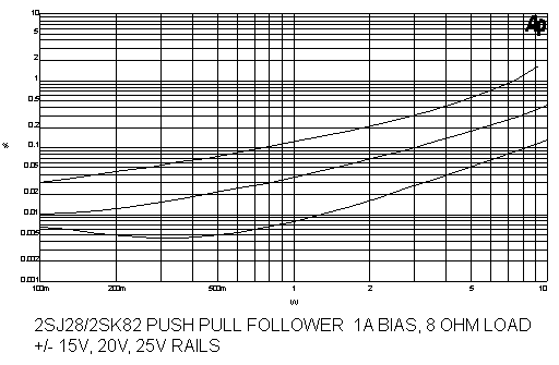

Is it too early to ask for a working circuit, papa?
In this case we are simply looking at a complementary pair of
followers. Perhaps one of our regulars would like to jump in
with a circuit. For 1 amp bias, it takes about -7 volts or so
from base to base for bias and there are no Source resistors,
only nominal Gate resistors like 100 ohms to preclude parasitic
oscillation.

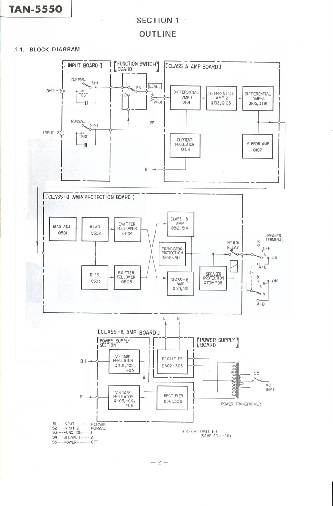

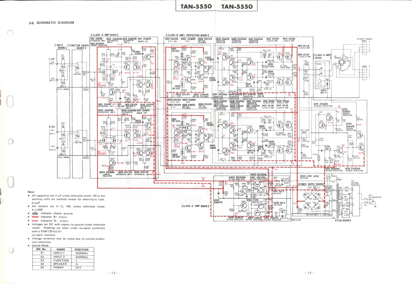

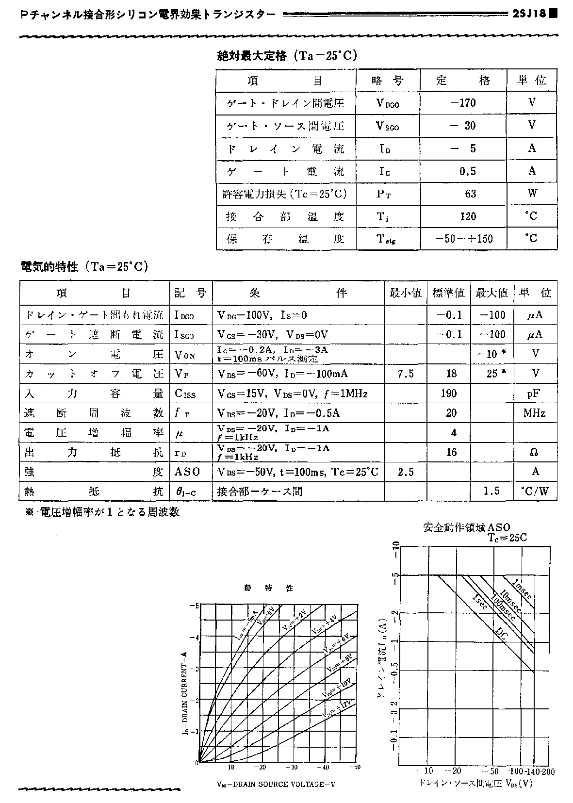

I thought is a nice idea to set up a thread dedicated to amplifiers based on old so-called V-FETs from the 70-ties (and 80-ties maybe). Transistors made by NEC, Sony and Yamaha, and to my knowledge in amplifers from Hitachi/Lo-D, JVC, Sansui, Sony and Yamaha way back then.
