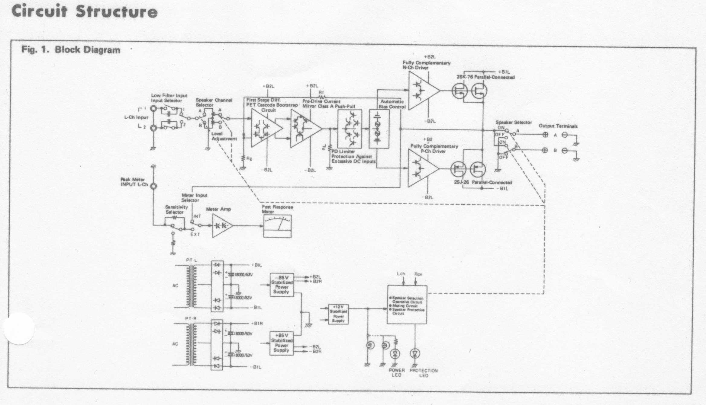

Lack of complementary symmetry devices. Safety, as the schematic of B2 shows a power supply = 200 V plus the +/- 80V supply of the output stage. The B2 is more complex than the run of the mill power amp. It has additional circuitry to sequence its turn-so as to protect the V-FETs. At the end of the day it boils down to cost-performance.

From what you bring up I doubt if you actually know the B2.
I do know the amp; had one which got all electrolytics replaced, sounding great then.
The input/driver stage has a regulated +/- 80V supply; the output stage runs on +/- 55V unregulated supplies.
When you look into the schematics, it looks more complicated than it actually is.
I agree with you pieter t regarding my ignorance of B-2. It was due to a momentary lapse of good recall!. Sorry for my misquote. I do not have the amplifier like you; but I have the service manual of its father the B-1. The B-1 is a brute. It delivers 360 W continuous RMS power per channel into 4 or 8 Ohm loads. I also misquoted above the power rails of the output stage of the B-1 which were/are equal to +/-85 V instead of +/-80 V. Regards.

Agreed, to build an amp like the B-2 from the ground up today might not make much sense as far as cost vs performance goes but there are enough of them out there that can be picked up fairly cheaply and with a little DIY restoration like new caps and protection relays these amps sound spectacular and will likely continue to perform magically well into the future at relatively low cost as compared to the cost of a more modern amp.
Yes indeed! :up:
attachment.php
