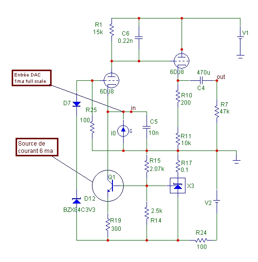

Hello
I'm working too on a valves I/U. But I want 0v on input, to avoid stressing my dac wich is based on ad1865.
This is just ideas on paper for the moment...
V1=160V
V2=8V
I : 6ma in first tube, 7ma in CF
Tl431 for negative voltage regulation and as ccs reference.
The 15k resistor on the anode of the first tube gives 15V for 1ma full scale on the ad1865.
The simulation works.

Bonjour
Very interesting, I see many similarities:
- cathode input
- DC coupling
- CF
Main difference: you use a current source for the input tube.
What is the purpose of D7 and D12?

Hello
The diodes keep the grid voltage constant and negative.
In fact, the grid is referenced to the negative voltage with the two diodes (a zener and a normal one : better thermic coeficient).
The negative voltage is referenced to the ground by the tl431.
Like this, the grid is referenced to the ground.
As my input has to be 0V, I have to maintain the grid to a constant negative votage.
I could also put a battery on the grid...
