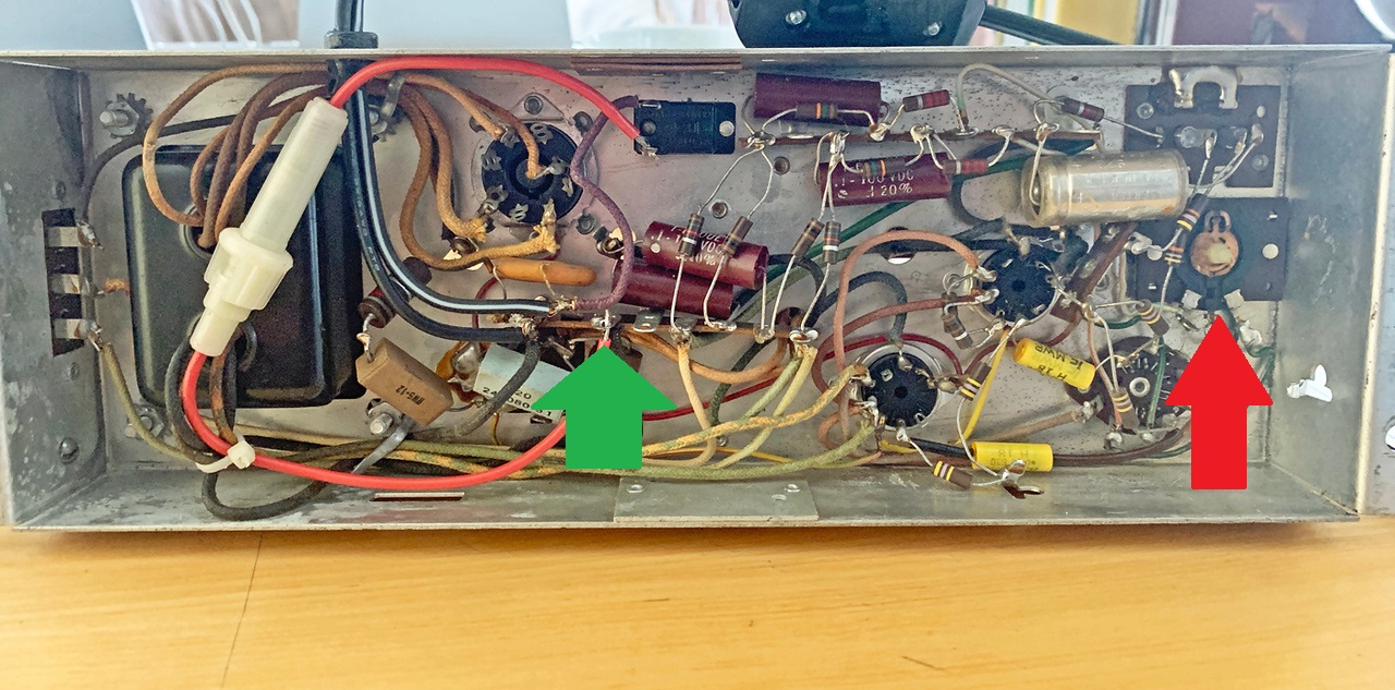

I've done a little study of this "death cap" that was mentioned earlier. I now have some rudimentary idea of what it is, what it was meant to do, and what it can do in certain situations.
There is a ceramic disc (?) capacitor wired across the hot and ground leads coming in to the amp. But it is a three lead capacitor, the third lead is wired to chassis ground. See pics.
My impression is that if the amp is correctly converted to a three wire power cord, then a death cap could/should be removed. But the cap in question on my amp does not quite match what I've read about how death caps are usually wired.
So it's an AMP-597-00, not a 196 as claimed.
The WHITE striped AC cord wire is the GROUND side - going to the WIDE blade of the plug.
That is how it's supposed to be wired, per electrical code.
And those "flying connections" are dangerous slop messes that amateurs do.
All parts and wires have to be anchored to tag strips, not left unsupported in the air like that.
That amp needs proper attention and re-wiring, among other things.
Hmm, ok. Thank you.
Yes, you pointed that our earlier, thus that is how I represented the power leads in the picture. As wired, not as they should be.
I assume this means two components soldered together at a point in midair. For sure in a high vibration environment this would be bad, but then one would not be soldering anything, it would all be crimped connections.
Maybe thermal expansion and contraction could cause the joint to flex and crack eventually? Sitting here with the amp in from of me, I only see one such connection. But trained eyes might spot more.
I have not personally done anything to this amp. I'm just trying to learn.

FWIW, that ceramic cap. appears to be wired across the AC mains. It also appears to be unswitched. 🙁
Yes, the ceramic cap is wired across the AC mains, and the third capacitor terminal is wired to chassis ground. There is no "ground switch".

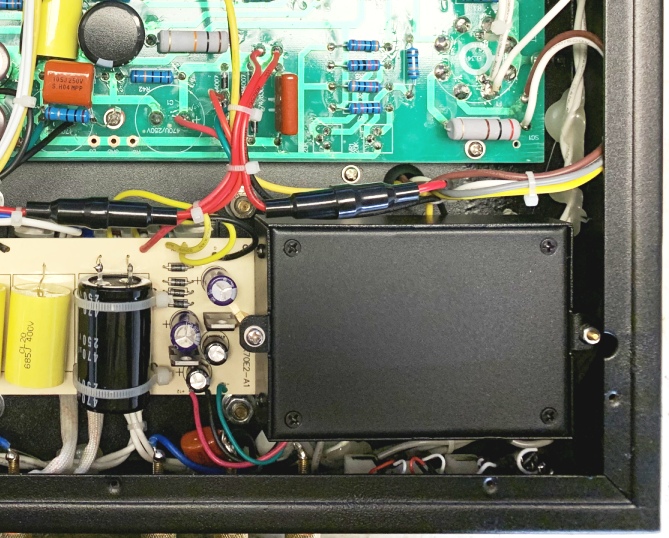

If something like this can fit, you will get better protection against "nasties" riding on the AC power mains.
I will look at it, thanks.
Eli..Agreed, the orange double section disk cap appears wired directly across incoming AC from the wall without the benefit of the fuse; this could be a fire hazard. A shorted section of that cap could put line voltage on the chassis (the death trap) since there is no 3 wire cord and plug to ground the chassis. Looks like the fuse protects (using a low voltage holder) only the power transformer. Looks like the RHS side of the disk cap appears to support some wiring; this is really not kosher...Also looks like there are some cold solder joints.
wiseoldtech... good idea on the polarized line cord. In my years I have not had a power transformer short to chassis, primary or secondary....

The neutral line cap-to-chassis keeps a lot of noise down, and helps reception in tuners/radios.
Just about anything "vintage" benefits from converting to a polarized cord.
