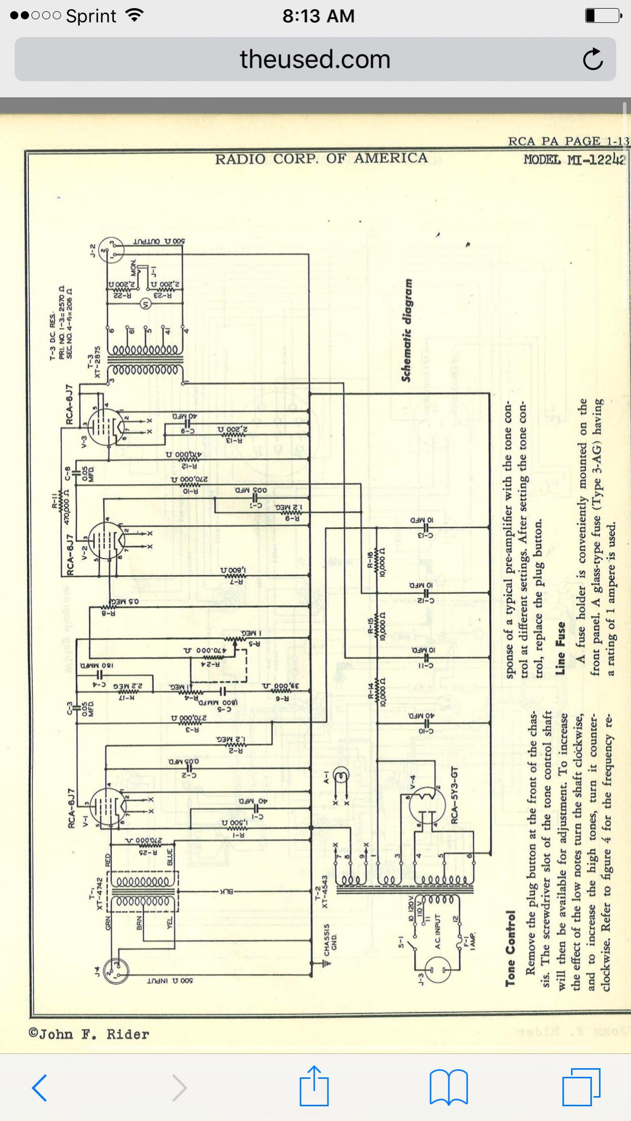

Thanks. I've been looking at that schematic. I wonder if I could make a tube power supply to use with the preamp or would I have to stay with the power supply as drawn? I'm wanting to keep this build as close to a vintage style pre as possible.
The tube power supply in a mic preamp isn't going to make a difference, it's not like you are building a guitar amplifier...
Ok. Thanks for the info. Are there any other vintage type mic preamps that you would recommend I check out as well?
Depends on your skill level - there are lots of schematics out there that you could work from if you are confident enough, but the G9 probably is the only one supplied as a dedicated diy-project with support (groupdiy) and all.

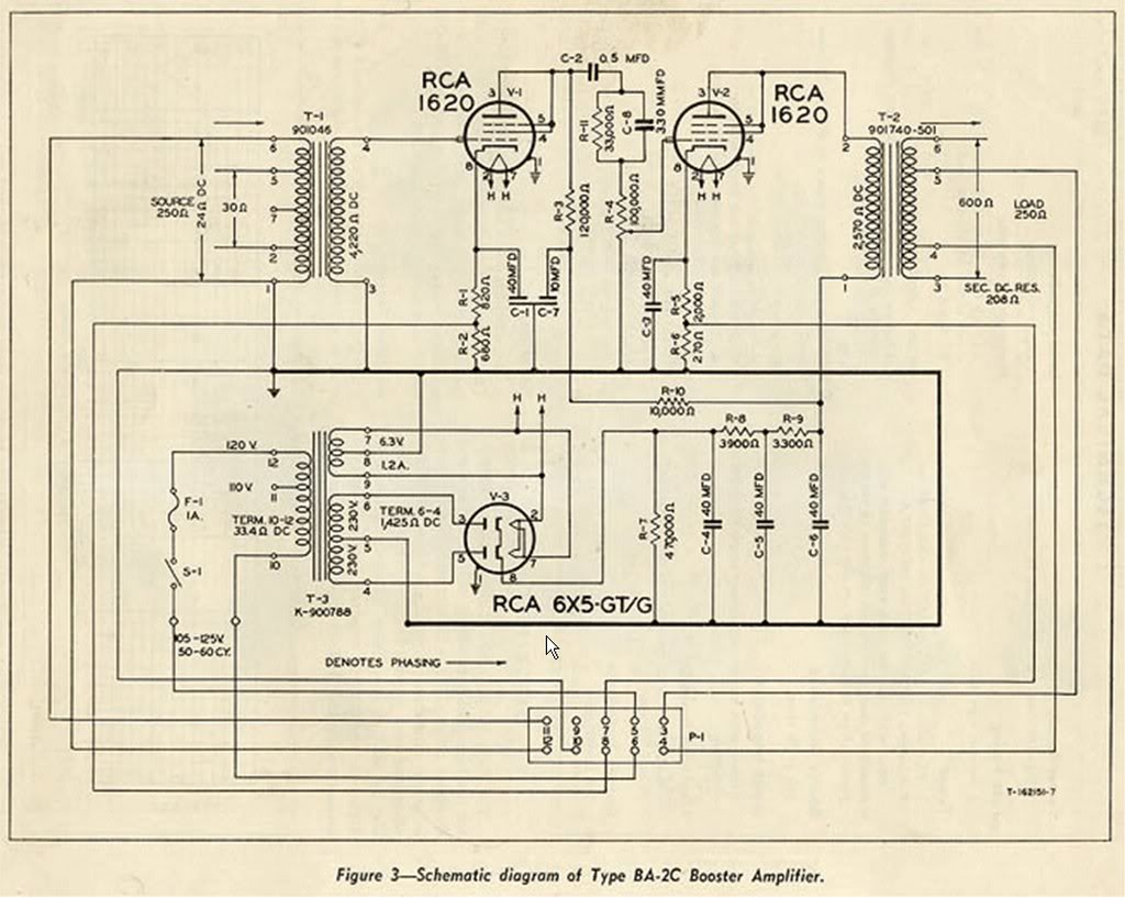

I'm looking to build a vintage style tube microphone pre. I'm settling on a couple of different RCA schematics but I'm having a little trouble figuring where to source the transformers. I have been going through eBay and a variety of other places but don't know exactly what to get. I would love to stay with vintage parts but I'm ok with going with new transformers. Since these are such a big expense I need some help in figuring out what to get so I don't waste money on something that's not needed. I'm searching for the input, output, and power transformers. Could someone please help explain to me what I need or can substitute in its place preferably with a model number and a possible place to buy it. Thanks for all of your help. I'm attaching the schematics that I'm looking at building.
As the old RCA preamps are sought after these days, the transformers will be difficult to obtain or quite expensive if someone wants to part with them. You may have better luck finding other brands such Altec, Hammond, Shure, etc. In which case, you may have to modify the schematic. Of course, they are many modern alternatives such as Jensen, Lundahl, CineMag that can do the job perfectly well, the only thing missing is the vintage factor.
